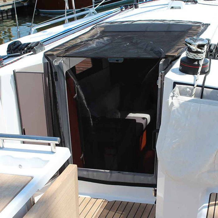

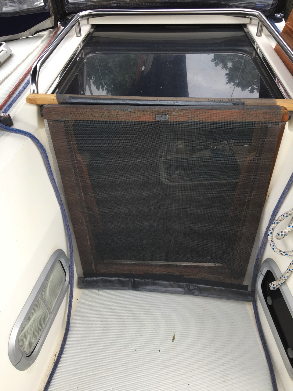

We use something like that shown in @Will Gilmore above photo.
We have a DIY heavy duty screen with a sewn on cloth edge, that contains lead weights along 3 sides. The 4th side has snaps that attach on the garage for the companionway sliding hatch. Won't come off but easily moved out of the way for entry. The weights are heavy enough to keep the bugs out and handle wind well. No velcro needed to far. We are known as the mosquito area of Canada.

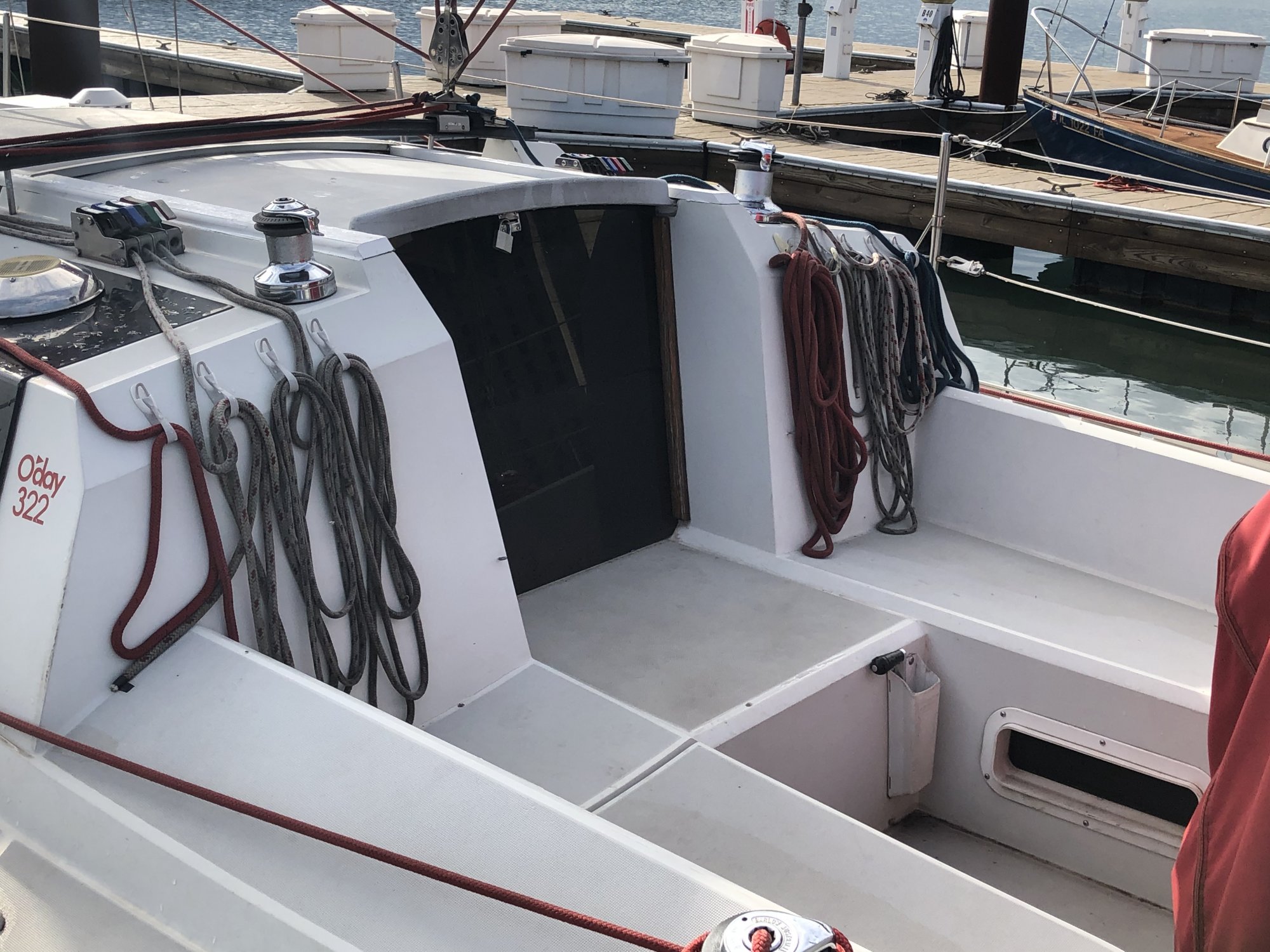

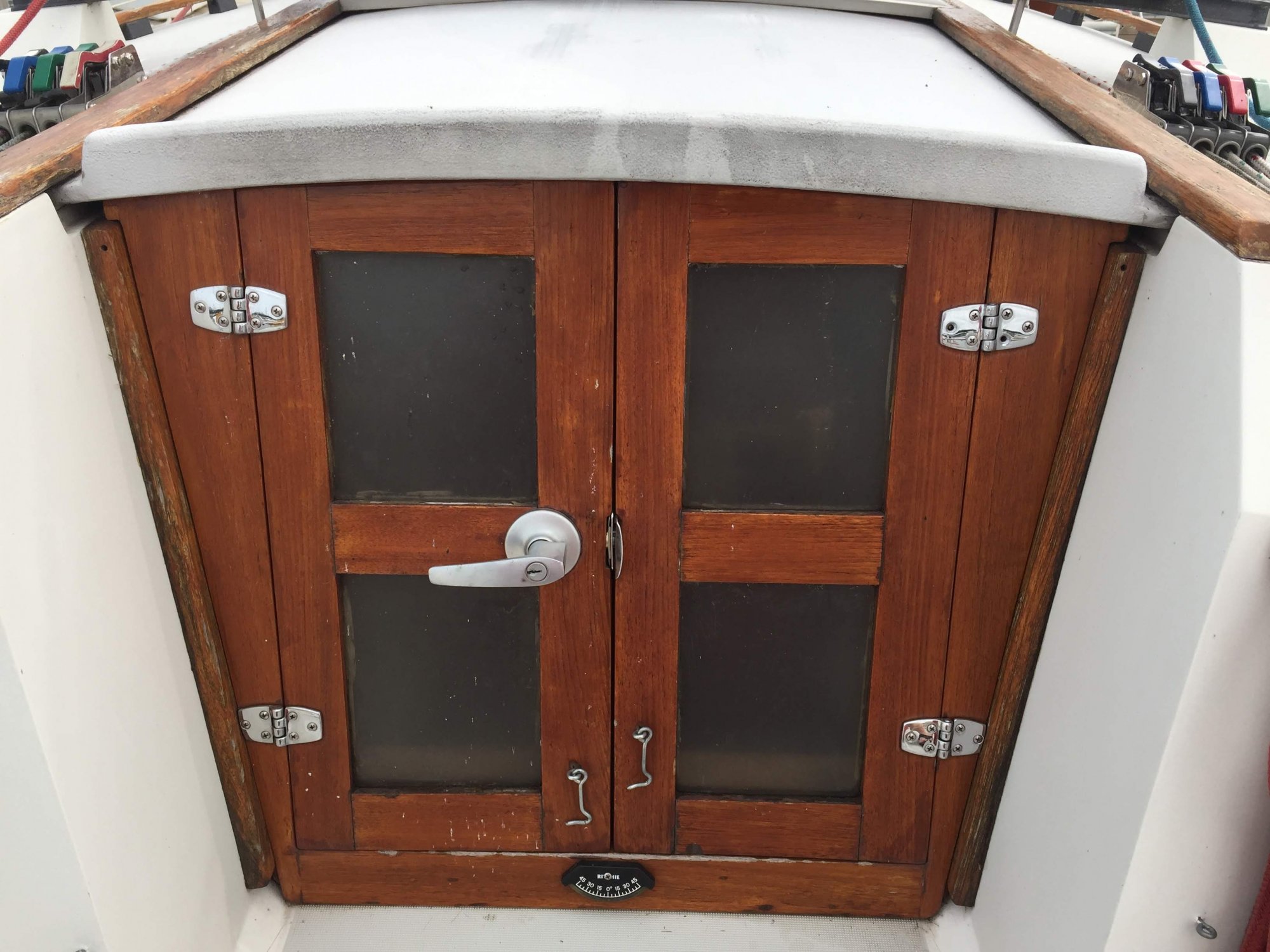

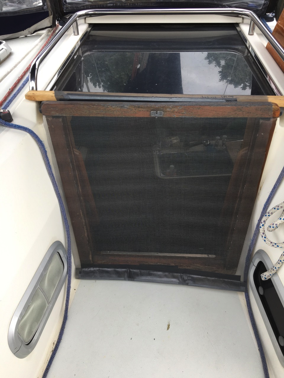

I love these doors instead of boards (on my O’Day 322 there are 2 pretty large plexiglass boards…hard to handle and to store.
I really like the look of the dark tint plexi boards though…
I ended up painting the doors white…
the need a little love this year.

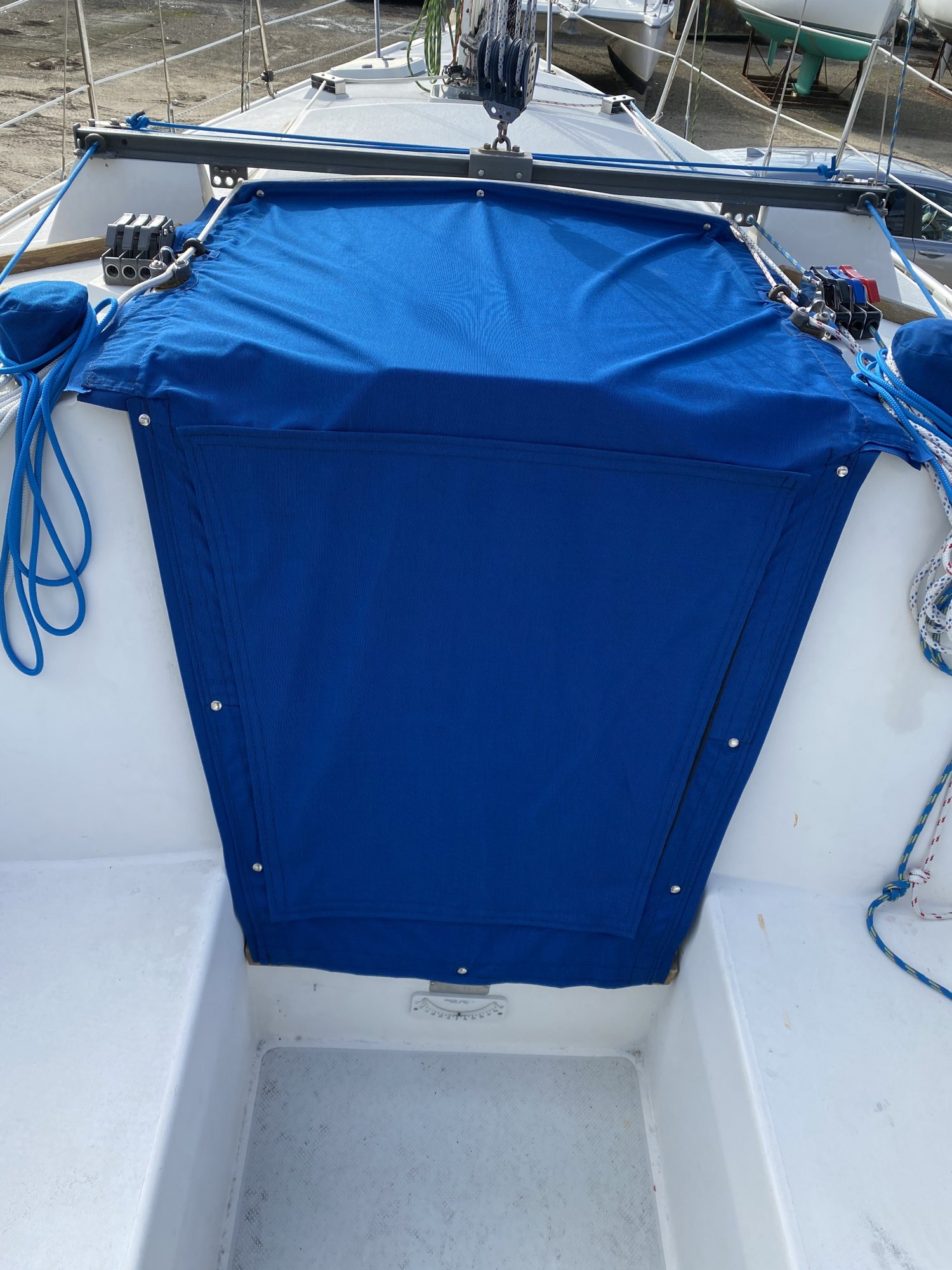

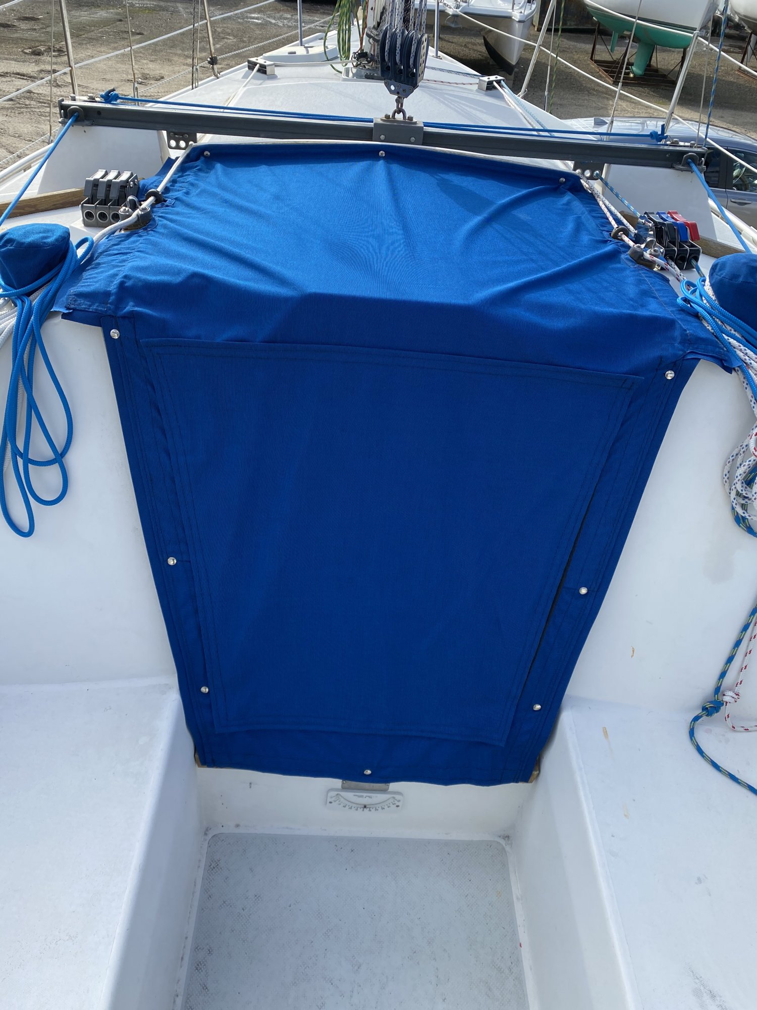

lots of great responses. I found this on the sailrite site. It looks cool.

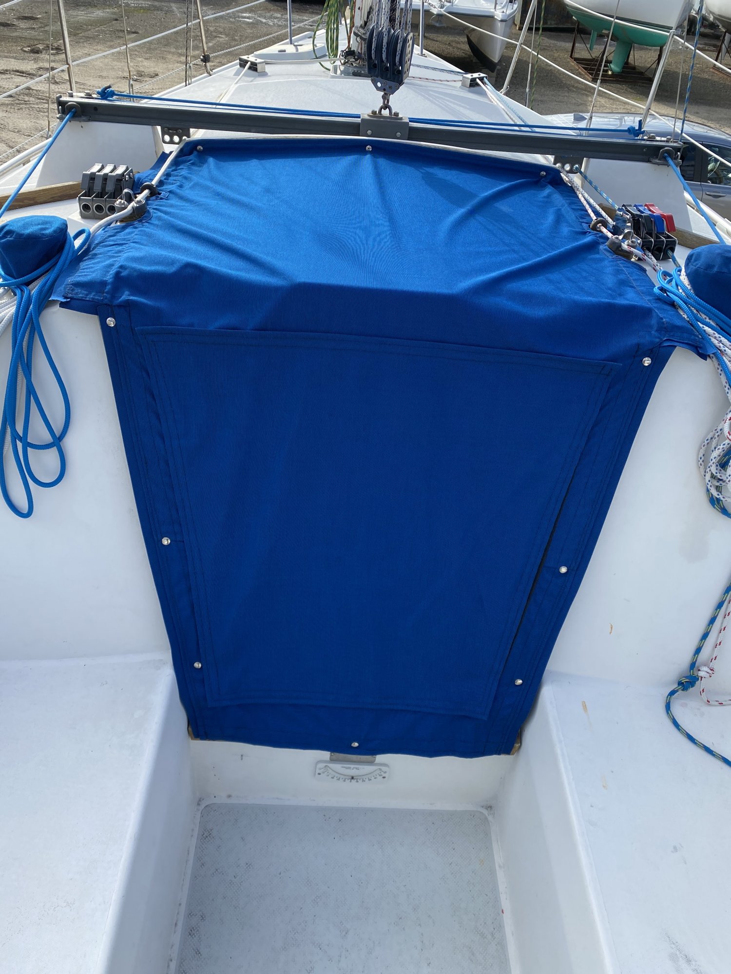

I made our companionway cover based on Sailrite's design. I made it so it completely covers the companionway and hatch. I put velcro around the screen inside and out. When we're on the boat I attach the screen cover to the inside so we can adjust how much ventilation we get and if it is fully covered we can pull down a corner to peek out.
It's easy to unsnap to enter the cabin and once inside to snap it back into place by reaching thru the gaps and pressing on the snaps.
We leave the front snapped in place all the time and just fold it back onto the hatch when entering or leaving the cabin. I planned on putting insulation on the inside but after two years of use, haven't done that yet.
Thank you for the insight on this cover.

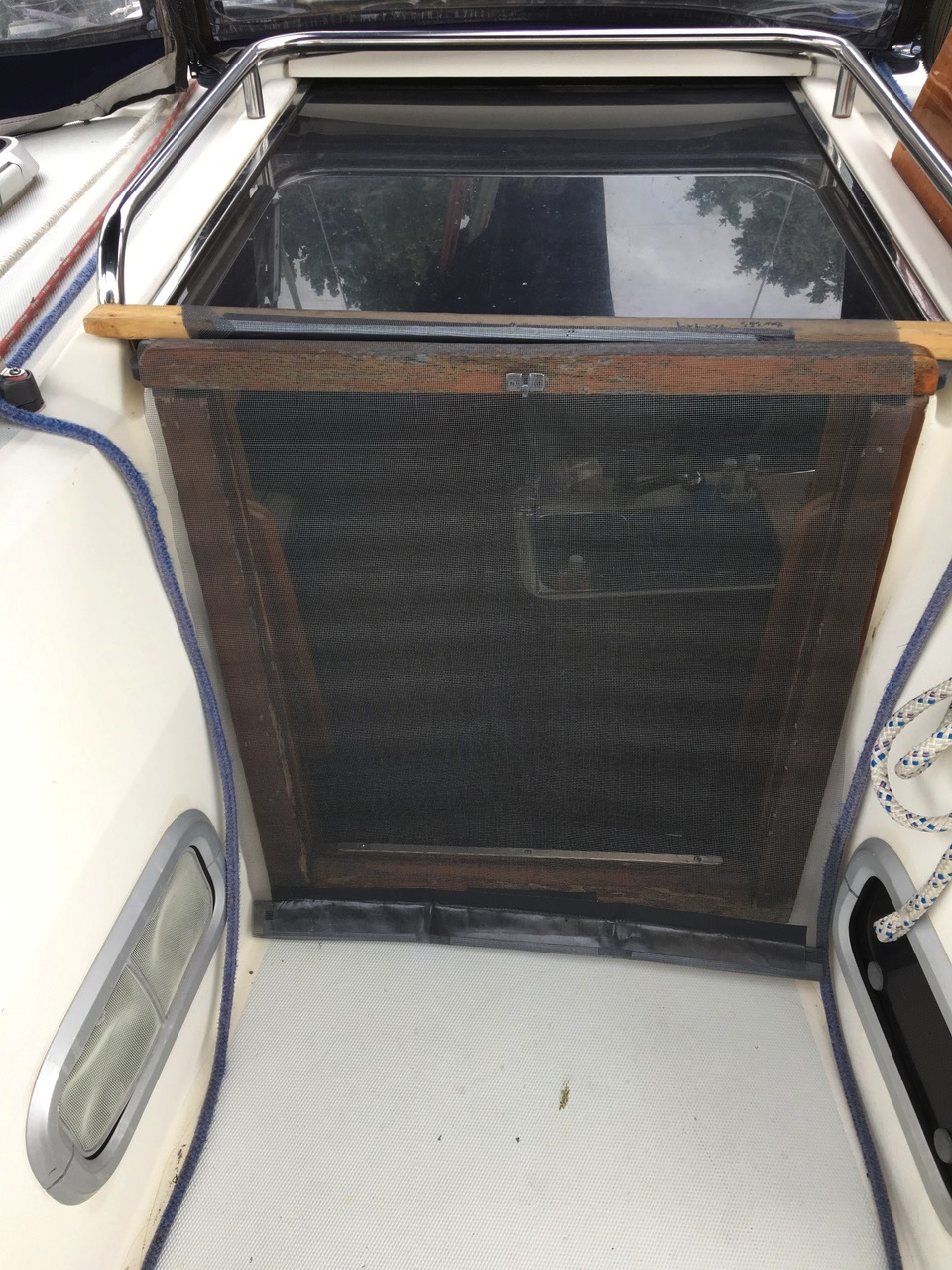

Our Catalina 315 came with a folding teak door. We got rid of that, and now, when we're not on the boat, we have a set of conventional hatch boards in place.
When we're staying over on the boat, and it's warm and we want a screen in the companionway, the snap in and zip up fabric screens that came with our boat were a poor solution. Way too much hassle every time you want to exit the cabin. Our solution is a removable, single section, screened hatch board. I cut a piece of 1/2" plywood to fit the companionway, and then cut a big hole in it, leaving just a 3" perimeter. Then, I used screen material and hardware from Home Depot to screen it over. Painted the plywood gray. Not beautiful, but it looks pretty good. Now, when we want to go on deck we slide the hatch open a little and lift the lightweight screen section out of the way.

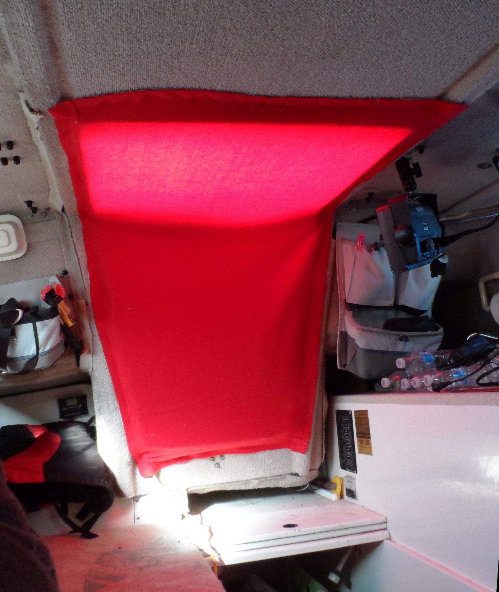

... I planned on putting insulation on the inside but after two years of use, haven't done that yet.

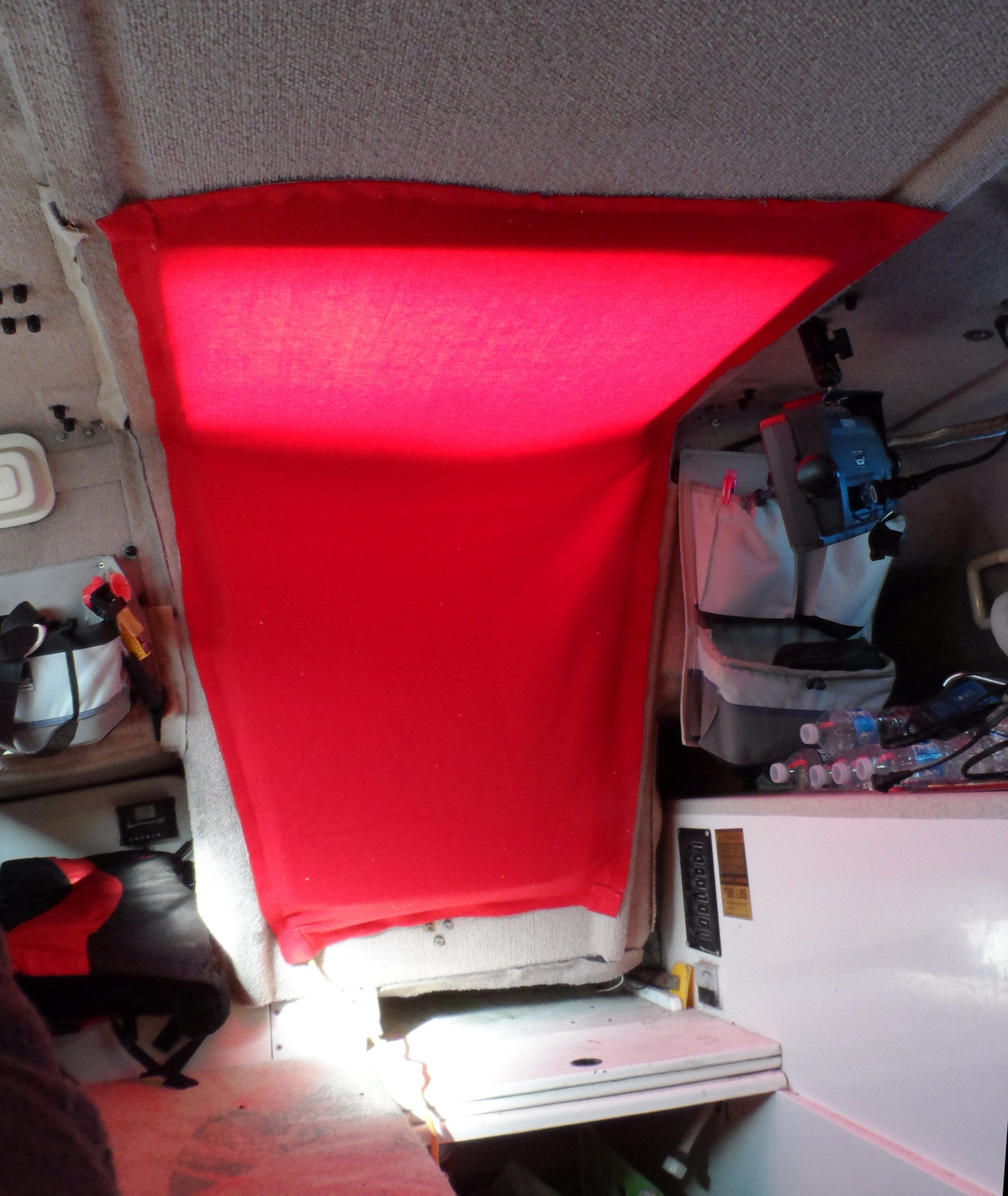

Since the real problem in cold weather is air leaks, I use a separate fleece inner that attaches from the inside with Velcro. Very snug and easier to dry if it gets wet. If it is only cool I just use the outer cover. If it is dry but cool, I sometimes use just the inner; it breathes better.
We’re more interested in cutting down on radiant heat from the hot sunbrella during hot sunny days and we have AC on. I was thinking about using something like Reflexit material.
Mar 26, 2011
3,732
Corsair F-24 MK I Deale, MD
Reflexit, or any aluminuized material, won't have any special advantage unless the sun is on it directly. The Sunbrella should have been white, which would be an even larger improvement (the difference in IR absorption is major). Test this by using a white towel.
