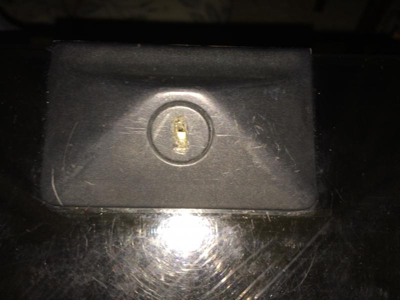

Has anyone else snapped off their key in the lock of the companionway hatch board?

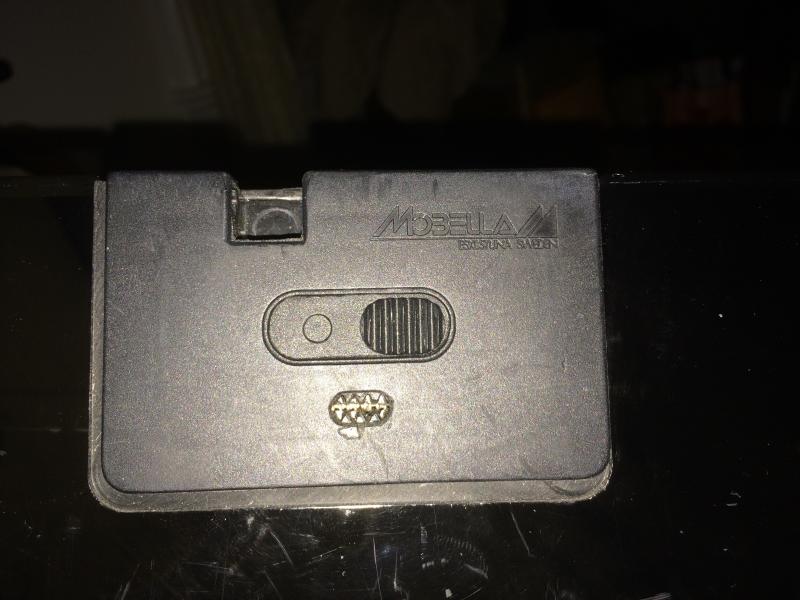

I can't get the broken bit out and i can't figure out how to get the locking unit off the hatch board.
it's a Marbella lock on a plexi board - circa 2008
front and back snippets below...
any thoughts or suggestions?

Go to your dentist and ask the hygenist if you could have some old explorers. Those sharp thing they ise to prod around with..They always save some for patients who use them as tools for hobbies etc. work them down both sides and see if you can extract enough to grab hold of.
Oct 17, 2011
2,809
Ericson 29 Southport..
It looks like it's ready for the drill. Giving my experience with locks, (I do), this will be a lesson in patients to extract the key part. It's aluminum, so it'll drill out easily. Once it's drilled out and you gain entrance to the back side of the lock, it should disassemble with little problem. A local lock shop should put a new barrel in it for around twenty bucks.

I heard of people using glue to attach something (what was left of the key) to the broken off key. I am not sure if this would work for the lock, but i read reports on using it in the ignition.
8,050
Beneteau 323 Annapolis MD
Is the key magnetic, and the lock is not (SS?). Got a big magnet?
Feb 8, 2014
1,300
Columbia 36 Muskegon
Most keys are brass so a magnet won't work. You can usually get it with two dental picks, one top and bottom, kind of dig onto the brass and pry it out. Hopefully you've got another key.
Last year I broke off my ignition key, and it was the only one I had. I took the lock out of the panel and to the hardware store. Took them four tries to copy the broken pieces but they finally got one to work. Only charged me for the one, I had them make two more. While bill was about five bucks.

Are you now "locked" out of the cabin? Looks like it will be difficult to get a pick on the broken key as it appears flush with the sides of the key receptacle. If you can remove the hatch board, just take it to a locksmith to have the key removed. Personally, I wouldn't attempt to drill out the key. Its going to take a very fine drill (like a dental drill & burr) to drill it out. You don't want this episode to turn into a lock and hatchboard replacement. I would let a professional do it.

If you put a Philips screw driver in the slot under the manual lock tab, the one with the gear teeth, and turn the screw driver it will release the spring loaded tabs that hold the lock mechanism in the hatch board. The lock mechanism will pull out the top.

The key probably broke because the lock is corroded and was too stiff. You can get an exact replacement lock for around $45 which will give you many more years of service. Just drill the cylinder out to release the lock and to uninstall and replace. I hate half fixes where you have to go back frequently to oil or adjust . Some things just not worth fixing.

Thanks to everyone...but especially to Jake n eggs...i knew that the spring had something to do with it but just couldn't figure out exactly what that was...
hopefully i can remove the entire lock system and work on it or just replace it.

The lock mechanism is part of the upper hatch board. The hatch board is cut specifically for the latch mechanism. It was this way from the factory. The lock can be easily broken by trying to slide open the sliding hatch. The latch is in no way a security deterrent but I lock mine when I leave the boat.
I knew how the latch worked because I had to replace mine after it was broken by an intruder. Stu is absolutely correct. A lock only keeps an honest man out! I have an alarm on the boat now. A little like locking the barn door after the horses have bolted.
By the way, it is pretty much the same key for most of these latches. At least for the Hunter family of boats.
