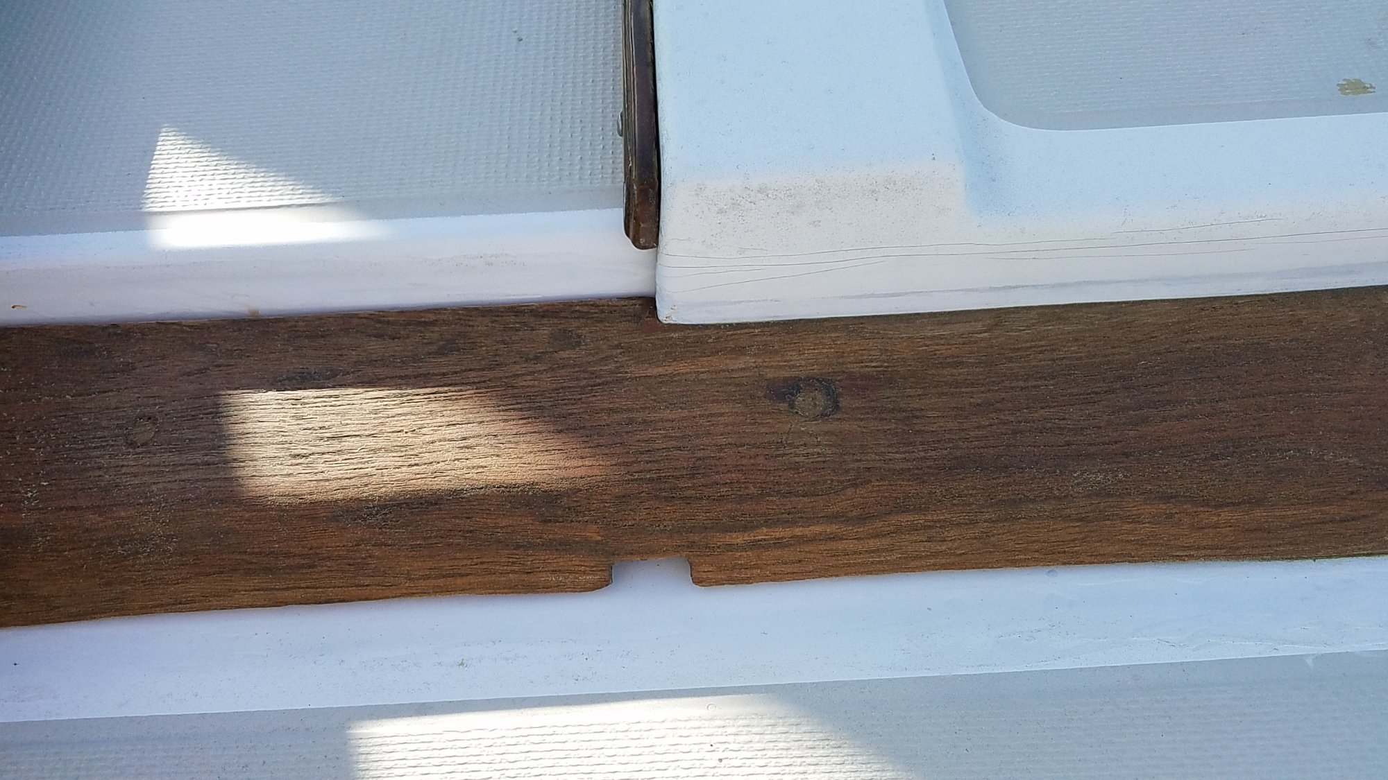

Hello all; after a 2019 purchase of a Catalina 30 1987 #5005, I found that often, when opening or closing the companionway sliding hatch - water would be forced out, splashing into the galley/salon below. First exam tells me it's a design flaw, as this happens when the boat is sitting well on the waterline. The forward end of the hatch slide and boards is still lower than the aft end.
I believe there needs to be a scupper created in the forward slide section (which seems to be lower and allows water to accumulate). I'm wondering (have searched but not found owner solutions) if someone has tackled this successfully.

Craig, while it is possible that the boat manufacture made the boat in a way it would encourage water to be dumped into the galley. Is it possible, there is a weep hole in the area that the water is accumulating? Could this weep hole, which is designed to let water out on to the deck be blocked?

My 30 (1990) had weep holes at the forward base of the hatch bump on the top deck. whenever i would flush out that area a LOT of nasty would come out of those two holes.. Do you have those weep holes? maybe you are just really gunked up. i never had any issues with water pooling in the hatch slide area as it would drain out of those holes or aft along side the hatch boards.

I had an 1989 C-30 and it was the same as BillyK says, never had a problem dumping water into the interior.

FWIW, I owned a CS 36T whose PO created some weep holes in the forward corners of the seahood to solve the same issue. although the problem actually on;y occurred when beating hard in a seaway.
It involved through-drilling the seahood frame and epoxying in a short plastic tube

The run-off from the hatch should be flowing out under the slide rails. The gap could be clogged up. A strong jet of water directed at the base of the rails will wash out a surprising amount of crud.

Could be a P(revious)O(wner) replaced the trim and did not re-create the scupper. Should still come out under the trim however. If you try a high-pressure jet, be careful. On ours a pressure washer tore the front end off the coach roof. I'd recommend a low pressure jet from a hose first.
If you are handy (or know someone who is) you may want to remove the trim and see what's what. There is a track the hatch slides in and it is covered forward by the piece the hatch slides under. On ours, the starboard side had crushed down and made sliding the hatch very difficult.
