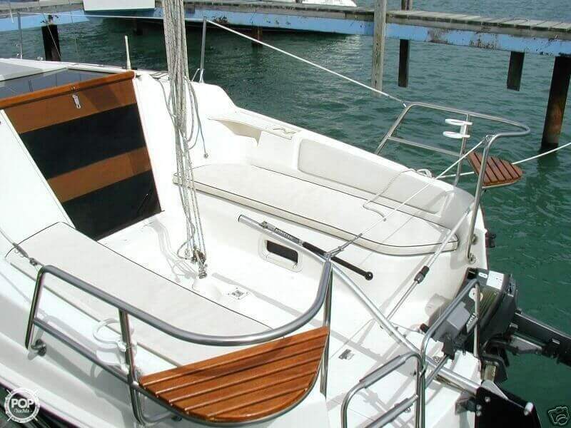

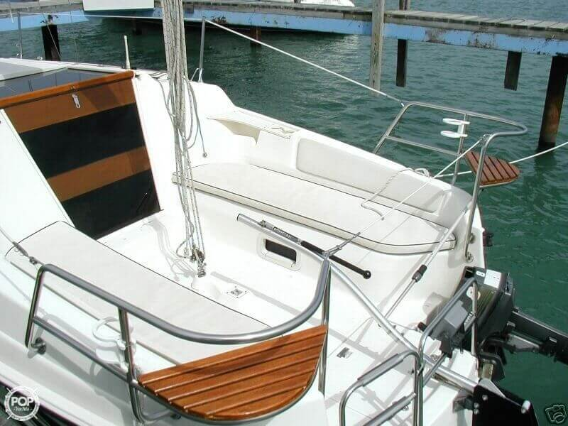

Here is an example from an H26.. the companionway is split into four boards

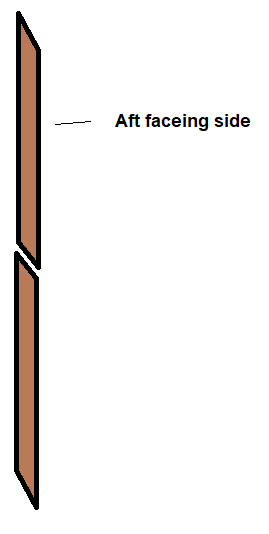

On my H26, I could store the boards stacked in the cockpit locker. You could easily use your existing hatch to draw a template onto some boards... When cutting the boards, you want to angle the edges so water would have to run uphill to enter through the crack... (like this -- side view)
Ive done this before on a Mac 22 and also on a Coronado 23. Cedar boards look great and if you alternate them with oak or pine you get a nice pattern. Sand smooth and varnish and it will look great. Or go with trex boards and you will never have to fuss with it again. Another neat trick is to angle a skill saw at about 45 degrees and plunge it into the face of the board a few times to creat a ventalation grid. Again you want the angle to go uphill from the outside so water can't get it from rain. Staple gun some screen over the vent slats from the inside and frame it whith some half round to hide the edges and staples and you will have a very nice looking vent that helps keep your boat from getting stanky.
