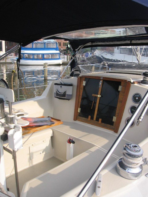

Nice work, 31seahorse. And the frame fits right into the drop-board slots.

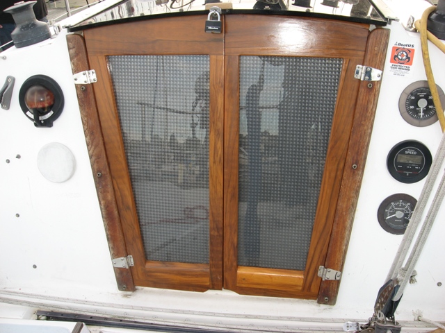

I built these for our old San Juan 28. I found after I built them that the carefully measured companionway wasn't symmetrical.
Measure carefully. I also used lift-off hinges so when the doors were open you could get them completely out of the way. Finding teak ($$) was not easy where we live.
The windows are Lexan with a plastic stick-on covering for privacy.

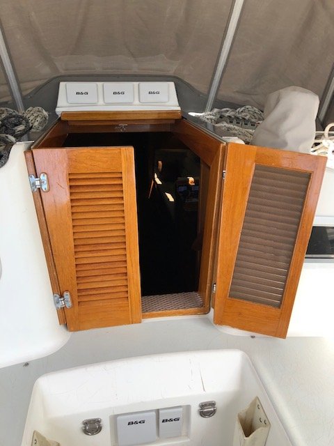

Set we have used on our current and prior boat. Removable doors with snap hinges. Screen and louvers.
In really snotty conditions ( or when we are off the boat), we just put in the drop boards. If we are under way and sailing, we usual don’t leave the doors in.

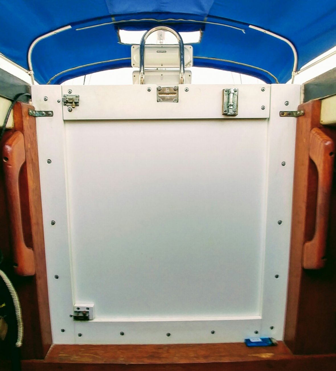

I HATE hatch boards, so almost the first thing I did after I bought this boat was to build this door. Some Starboard, a hinge and lots of screws and an afternoon....
This is exactly what I need to do when I get some free time on my hands. Thank you for posting.
