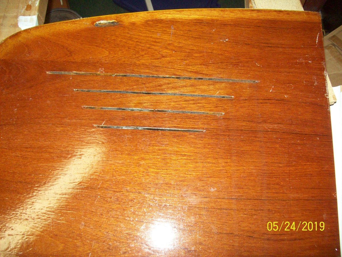

I'd probably make my own out of BS1088 okoume or meranti ply. Cut 45º angles for the joins between boards, with the angle down and out, to shed rain. Probably thin angled router cuts with plunge router, again, down and out, with screening attached to the inside. And I'd varnish them. Alternatively, you can get SS louver grilles that you could install in the boards. (I don't have a plunge router, so I'm not sure how viable angled cuts to create louvers would be, and to some extent would probably depend on the thickness of the ply, with thicker ply being more effective at keeping out rain.)

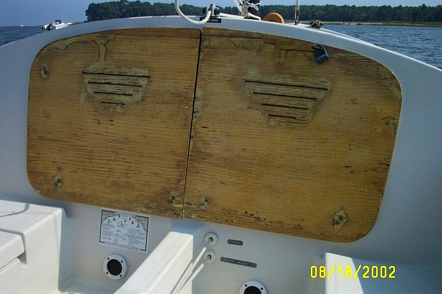

Brian, the cuddy enclosure panels for my DS II are 3/8" teak plywood from D&R and Rudy uses his table saw to create angled slots for ventilation in those. It appears that my originals from 1979, made by O'DAY are made the same. Plunge router works good but might require making a jig to get the angles? So, table saw can be used instead. (slots are longer "inside" than "outside" and there is a radius to the inside ends of the cuts when using a table saw (or circular saw) , but still works! The outside picture is of the original panels (I've since replaced them with ones from D&R) but the slots show up better in this pic that the one I have of the newer panels, the inside view is one of the newer ones, the slots do show up pretty good there.
Nov 9, 2012
2,500
Oday 192 Lake Nockamixon
Sunbird, I have to remember this, because you're right, a table saw, or a couple stacked to make a dado, would make nice cuts!
