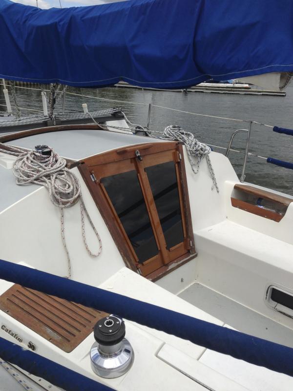

But having said that: they fit perfectly. The 2 tinted plexiglass panels slide up and out of the way, revealing the screens behind them; when we go out on the boat and stay the night, we remove the plexiglass and stow it, and get a nice breeze through the boat.
Also, he spent quite a while putting several coats of varnish on the teak, and it shows; I was thrilled with how well they fit in the companionway.
Here's a photo I took just after finishing the installation, which took about an hour.

it looks like the plexiglass inserts go in from the outside. So if someone wanted they could just remove the insert, push in the screen and get into your boat. Obviously it would have to be a skinny person. Also, how do they do with rain? Do they leak at all?
No, they can't be removed; they're on the outside to prevent leakage. They're kept in place by Allen screws that are set from the inside--screw them in and they go into the wood, allowing you to slide the panels out. Screw them out and they prevent anyone from removing the panels.
Longterm, are yours removable? If so, how?
Yes, they are; the doors lift off the hinges. When locked you can't raise the doors so they can't be removed while the companionway cover is closed.
I would definitely like some windows (tinted) that could be removed for screens. I also would like to be able to remove the doors when we want to use the boards.
Some of what you want is in the doors that I have; you *could* use boards if you wanted to, only I don't know why you ever would. The plexi is tinted, the screens behind fairly transparent from inside the boat.
I certainly could never have made doors that fit this well; another C30 owner made some for his boat, out of white plastic, so that he never has to paint; he's also going to remove all the teak from the outside of his boat... not my style at all. I prefer to keep my teak varnished and looking great.

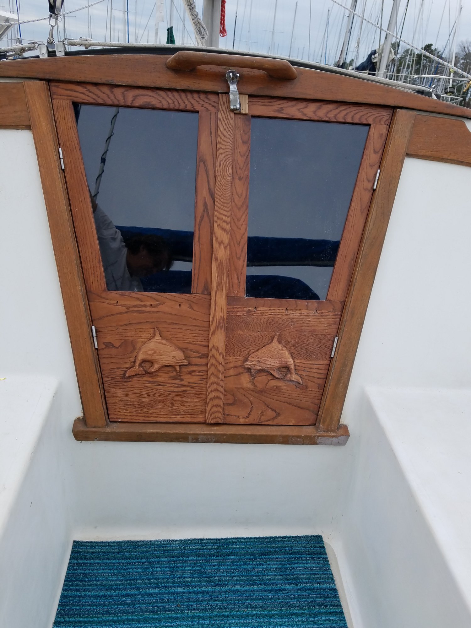

I created a set of doors for our 1985 Catalina 30. [See my PINTREST page for plans]
They are made of White Oak ($80 vs $700 for Teak) and have removable panels, one set clear for light and the other opaque for privacy. A screen set could also be made if desired. The panels fit in a 1/4" rabbet on the inside of the window opening and the top rail is actually two separate rails to allow the panels to slide between. Each door is attached via half-hinges to a piece that is screwed into the slot the hatch boards occupied. The windows have weep holes along the bottom edge so they won't leak in a rain. The batten protects the middle and the sides have 1/8 silicon weather stripping.
I would not recommend the PVC 'Lumber' for this type of project.
