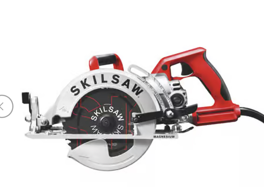

What tool are you describing as a Skill saw?
Not to be too picky (and I know you quoted another poster), but it is a SKIL saw….made by SKIL.
My favorite is a worm drive like this one. Allows me to use it right-handed and easily see the blade.
Mine is about 40 years old, and still running like a charm.
