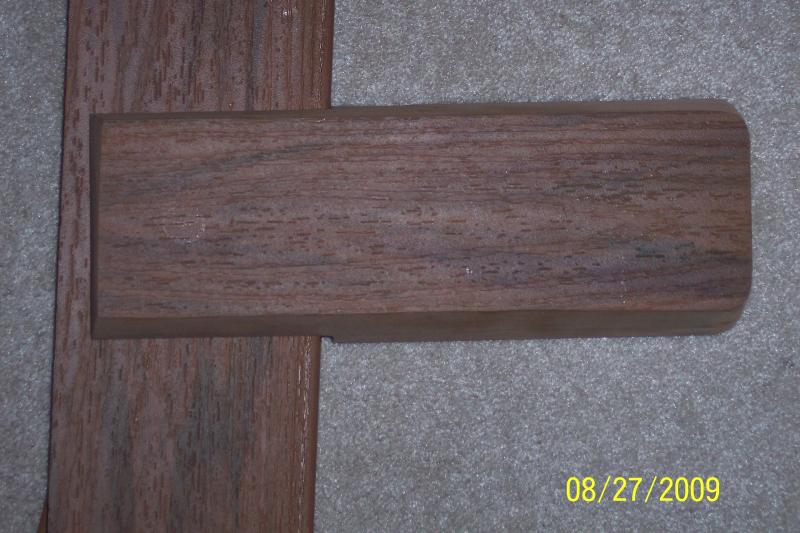

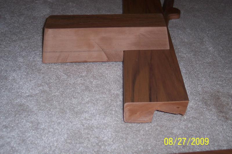

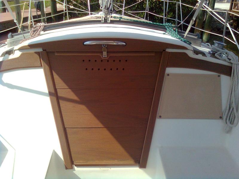

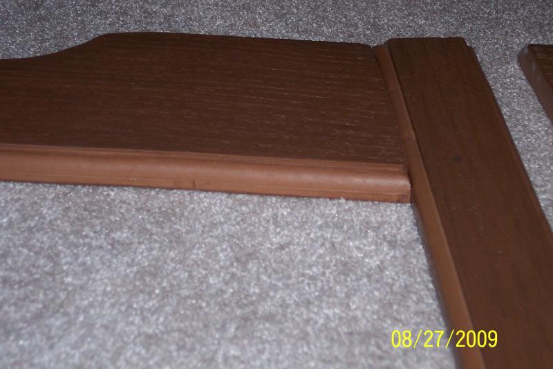

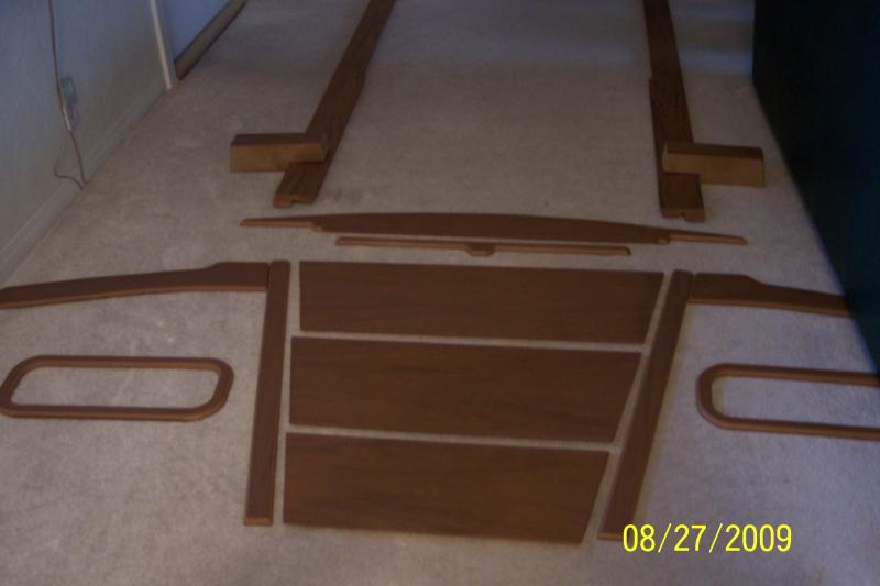

I used "Sensibuilt", a man-made product that has a wood grain look & color. I was originally concerned with the lateral strength of the material, but the rigidity is fine going on 2 years now.
Please note that some cut edges are before the final finishing.
There are alot of synthetics out there, the good news is that it can also save you varnishing time.
Here's what I made from the Sensibuilt products, using their facia board & decking.
Ron, that looks pretty darn nice man. Looks like you made hatch tracks out of it too?
I need to make some tracks but dont feel it needs the expense of teak anymore. Looking good and being functional, while limiting costs are the main priorities.
Is it hot to the touch when in the sun? Some of the simulated wood products ive read about have that complaint.

Anchor,
The material I used does get abit warm in direct sunlight, but not as hot as other materials I've seen. So far it has not been a problem, luckily there isn't alot of topside wood on the Catalinas.

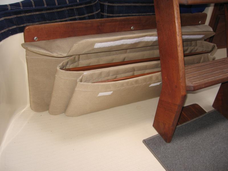

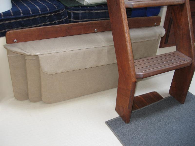

I made a Sunbrella Hatch Board Case that attaches under my companionway ladder. Each slot is padded and closes with velcro. Keeps my pretty varnished teak from getting scratched and also keeps them out of the way and secure while underway.
DanM.
DanM.
Dan,
VERY nice.
Jim
DanM.
Dan, Nice work. Me likey. I'd like to fabricate some covers like this. To the first poster: If I were going to go to the trouble to replace my hatchboards, I would go with new swing out doors (inward swinging doord would have a tendency to leak if they don't have an overlapping center spline); this would add value & allow a place to intall sceens in the frames. They are available online.
