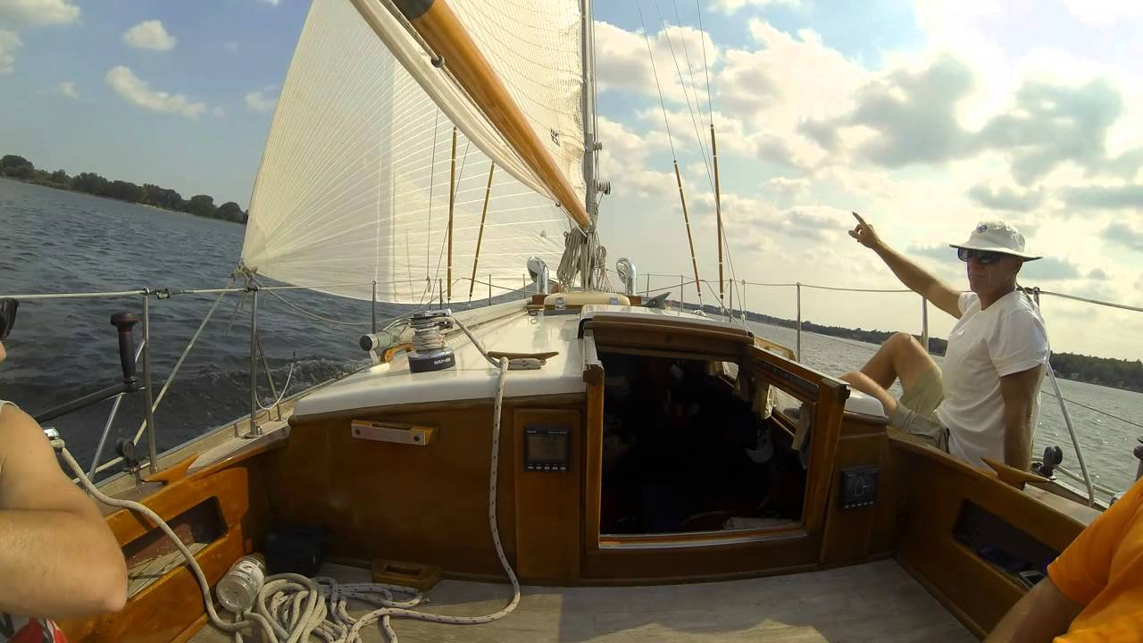

i have to admit that a door wouldn't work on my vessel any way. boards in - boards out, it's easy to get in or out of the cabin. the sill to the main hatch is up high and the boards are not very big, easy step over.
my boat is real 'old school'
