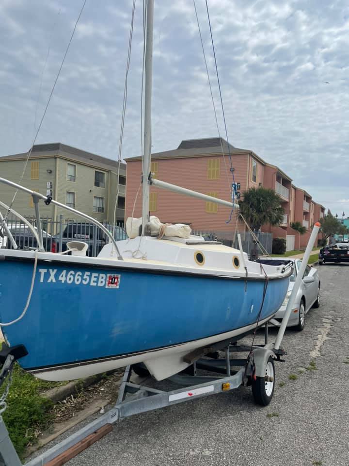

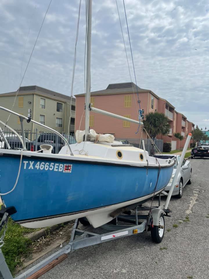

Just bought this over the weekend. 1984 Compac16. Looks ok overall. Running rigging is usable but needs to be replaced. Otherwise seems to just be dirty. A little give in the seats when I stand on them, but I don't think it's a problem. I did notice the winching point anchor on the bow is loose enough to wiggle. Could this be an issue in the making? Thanks all!

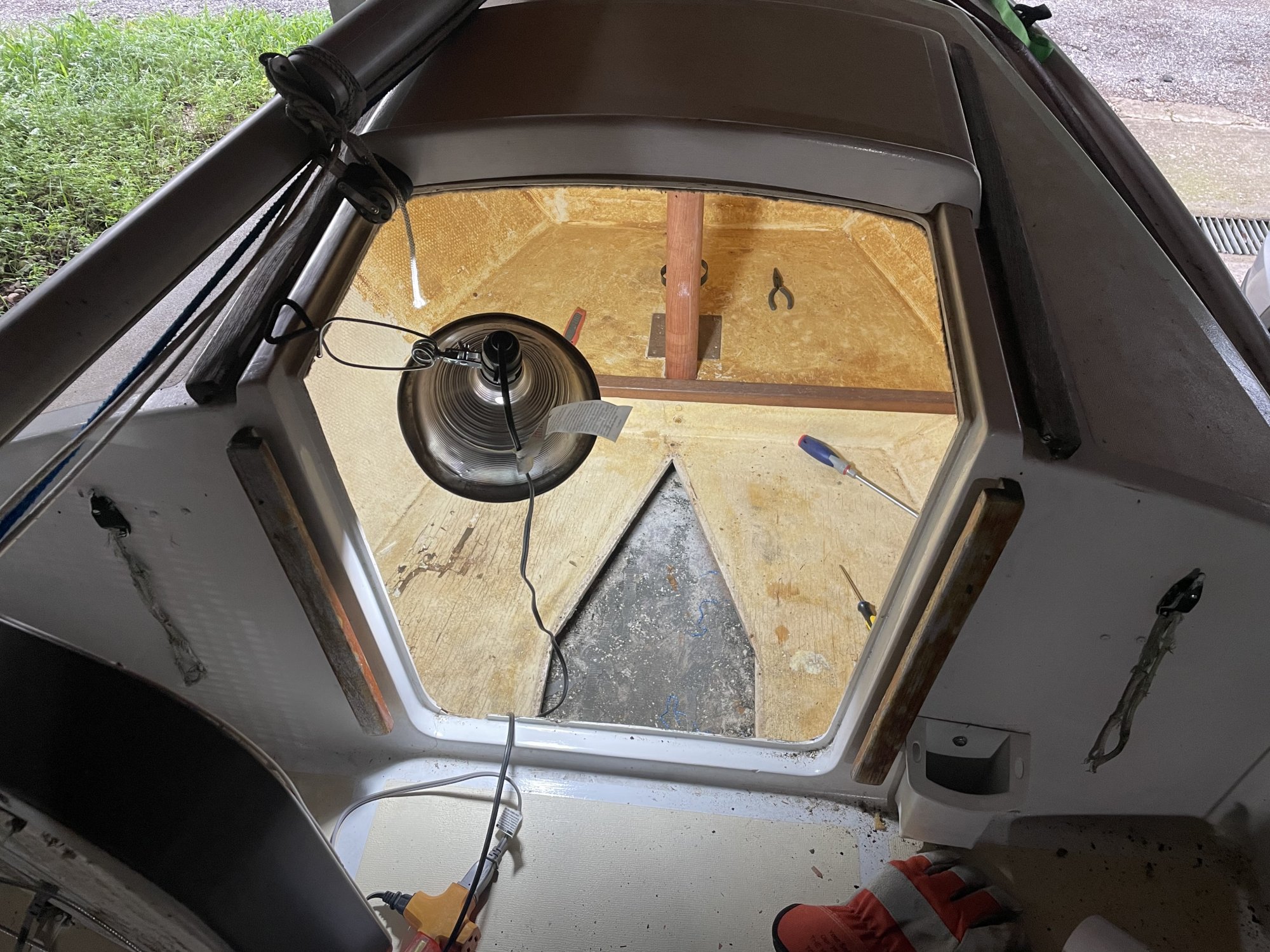

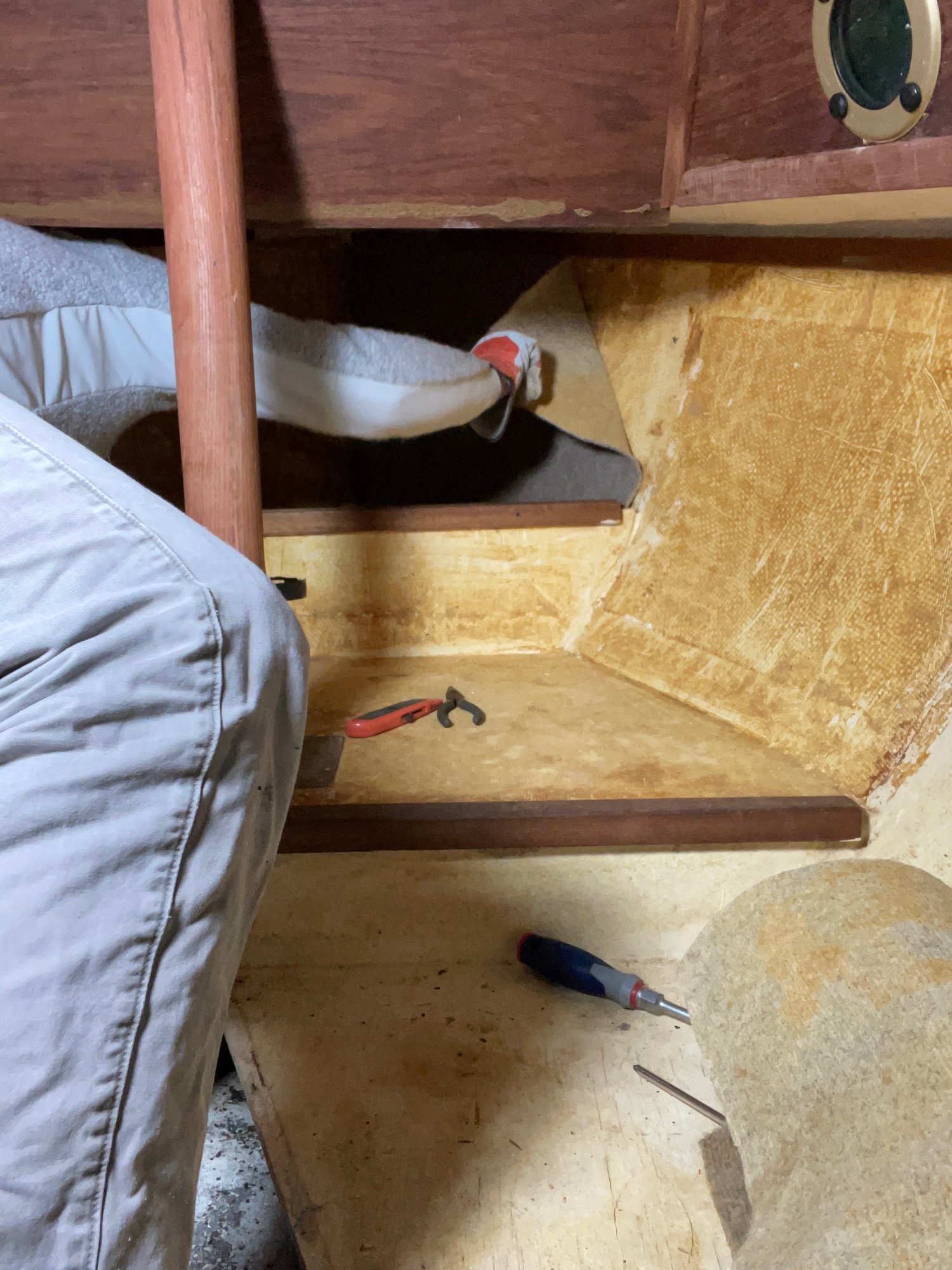

A little bit of updates. I have repaired the bow eye. The wood was still good so I just added a metal plate and some sealant to it. I have. begun redoing the cabin. I have pulled out all the old carpeting on the walls ect. Mostly in good condition. The benches have rotted quite a bit, must have had a rain leak at some point. Someone in the past has filled the voids with foam so they are still very solid. I decided i think i'm just going to bondo it up and then paint it with sealant.

I"m not replacing the carpet. I don't like it. I think its just a mold magnet. Sanding everything, spraying with mold killer and then repainting.
