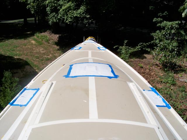

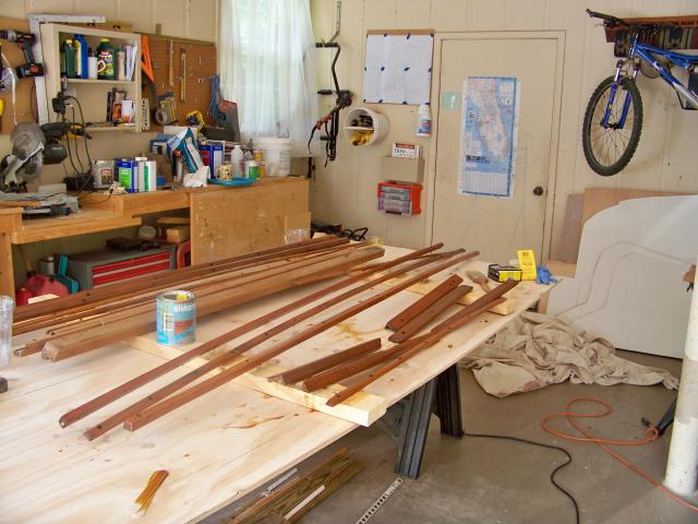

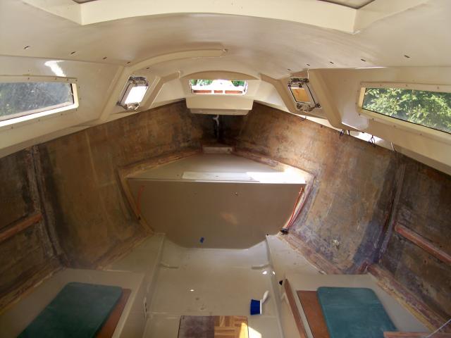

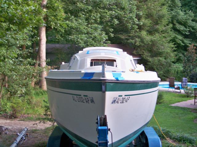

:dance:So this week has been a good week on my progress. I was able to install two ports, finish some teak and get the first coat of epoxy primkote on. You guys may remember that I painted before, but that didn't work. What happened is that i did not thin the primer before putting it on. it cured too hard, and so the topkote didn't adhere well. I had to grind it all off and start again. This time, the primekote looks good. I will put another coat on this week. then topcoat this weekend. Also should get my bomar hatch before the end of the week. it may require some epoxy work to make it fit.
I put some cetol on my teak lumber today. so far so good.

p.s. that first coat of primer is just on the repairs. not the whole boat!!!! i am just painting the deck repairs as you can see in the first picture above
