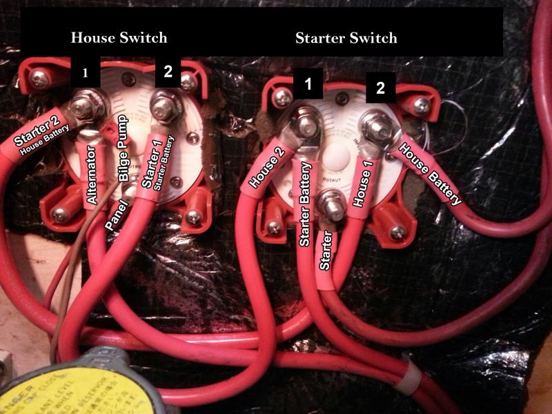

Thanks twalker... Actually upon closer examination, I noticed an incorrect depiction of the House to #2. I updated the drawing in my previous post that removed the longer run from the house terminal block to the #2 Starter.
I have uploaded a picture of the battery switch hookup I just finished wiring. This may clear up your previous concern. Please let me know.
Thank you again!
