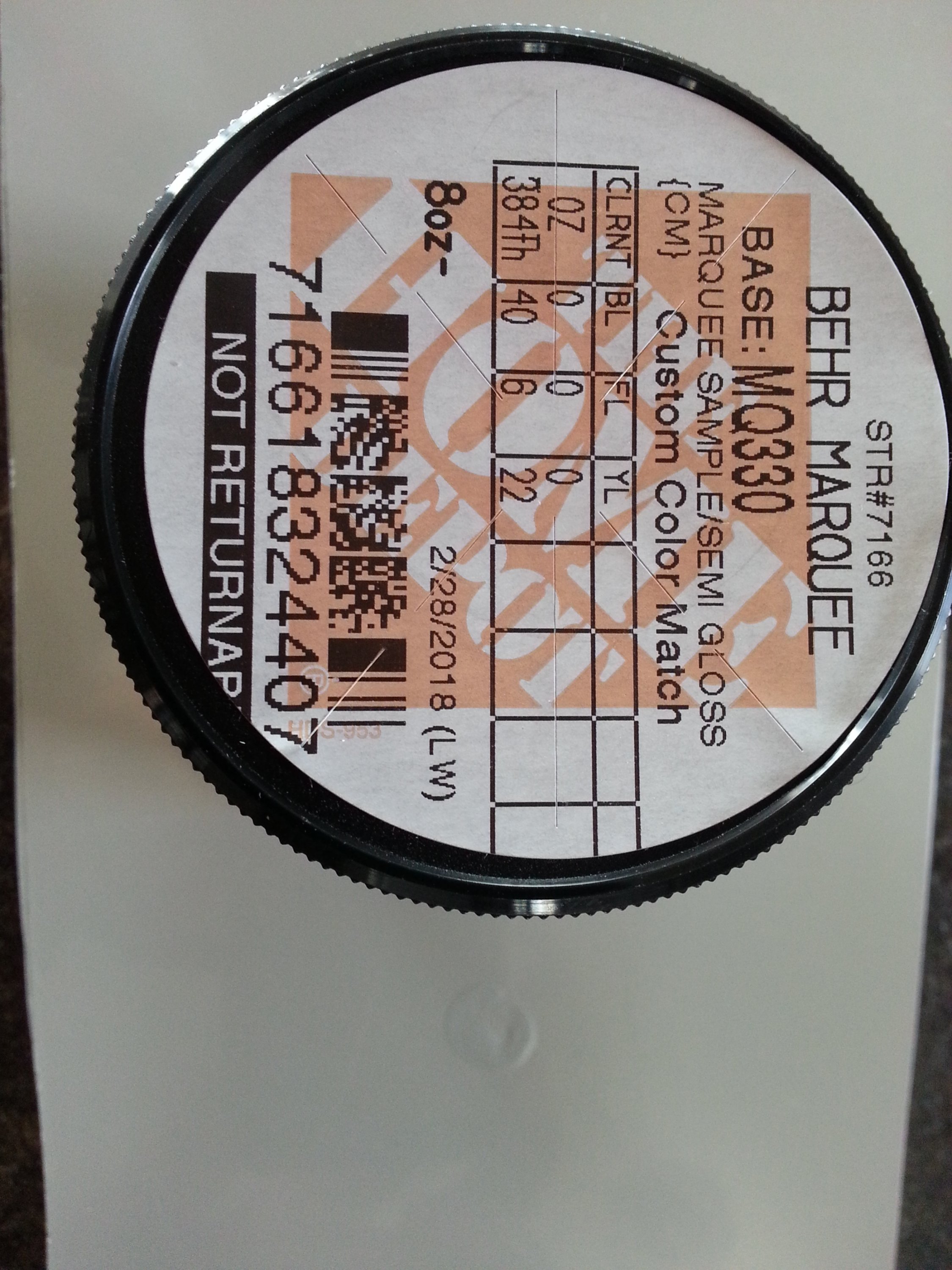

Attached is the color code for our deck and non-skid as well as interior liner.
Take the code to any Home Depot - in the picture you'll see a small dot next to the can top -
that's a drop of paint on a small section of hull liner and it's a perfect match.
It's a BEHR paint and they'll make you an 8 ounce sample can for $4.87
I took exterior latex semi gloss because I knew I'd step into oil paint before it dried (just like I get 5200 everywhere).
