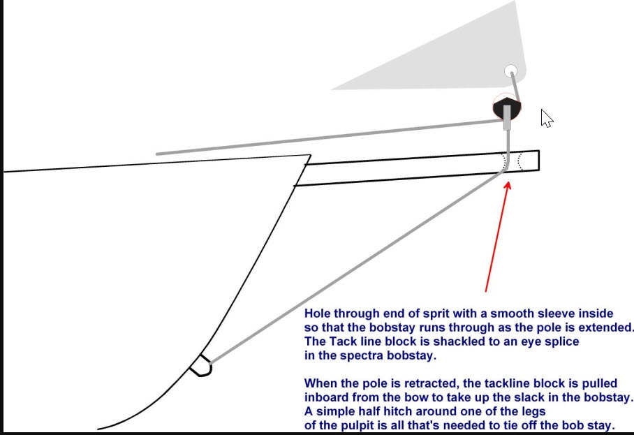

Sprits get the sail out and away from the bow giving you more room to fly the sail. It is nice but not required to fly a sail to help you while dealing with light breezes.

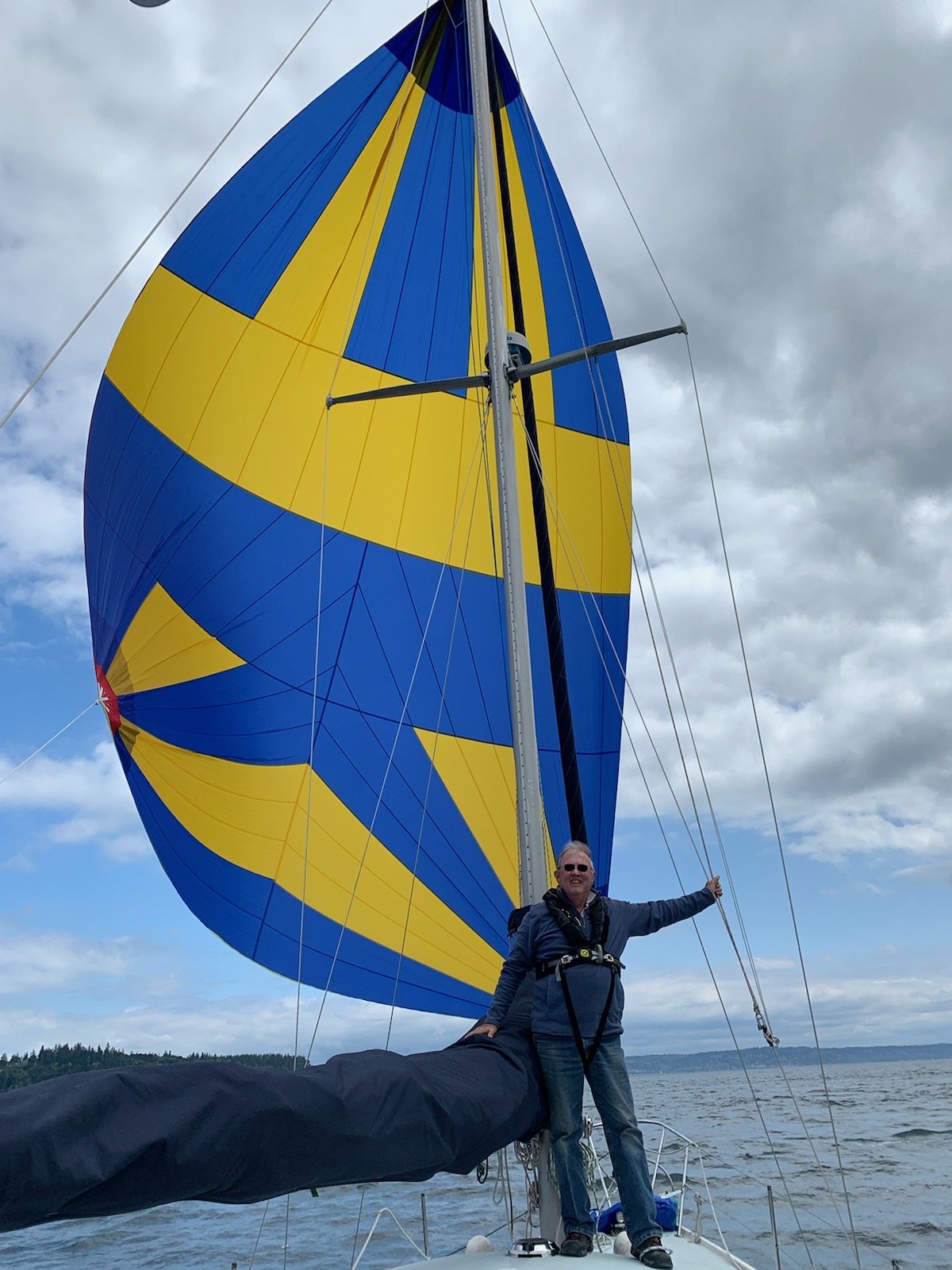

Here I am having just rigged my new asymmetrical, no top down furler. There are 2 of us aboard. I handled the bow action attaching the sail to it's halyard, running the sheets to the stern and attaching the tack. I then hoisted the sail. Once in positon I hoisted the sock to the top and the sail unfurled and caught the wind. It looks glorious. You should do it.

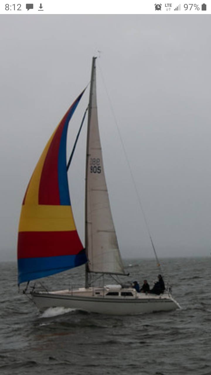

I used a top down furler with my asymmetrical spinnaker on my Hunter 386. 1) Did not require a bow sprit since it is a fractional rig and the asym halyard cleared the jib furler. I attached the foot to the bow anchor roller. 2) Excellent performance on a broad reach. 3) Double hand. 4) Used it once in a long downwind race from San Francisco to Benicia.

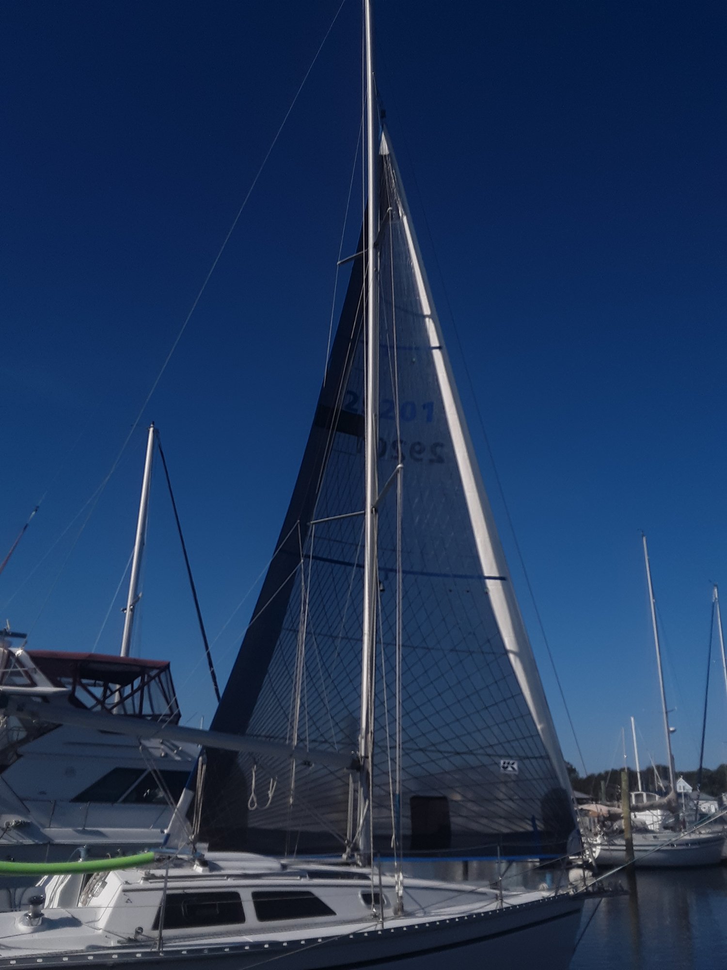

I dont think a code 0 will do much more than installing largest genoa that will fit on boat
24,580
Large Genoa's are great and versatile in many wind conditions. But when the breezes get light, the weight of the sail is hard to over come. Genoa 7.5 oz cloth versus a code zero or an asymmetrical at 1.5 oz or 0.75 oz cloth.
