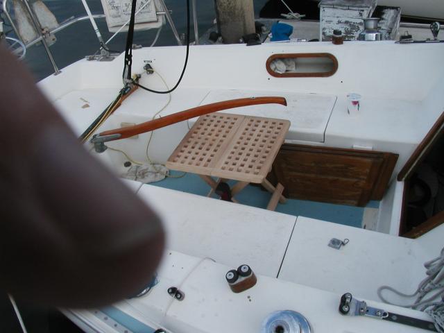

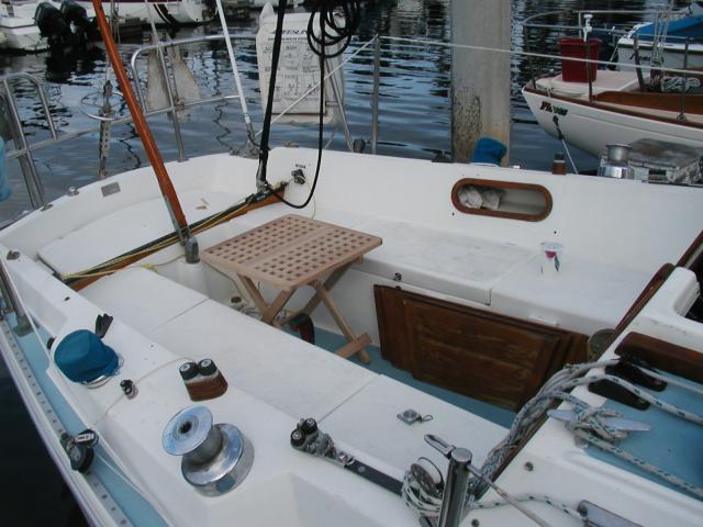

I found this table at IKEA... $25.00 unfinished. It folds up flat and stores easily. I have folding cup holders on the bulkhead seats so there's no need for them on the table. I have since finished it with cetol light... but I like it unfinished too. Notice in the picture that it functions with the tiller down if you want to use it while sailing, or motoring down the ICW.

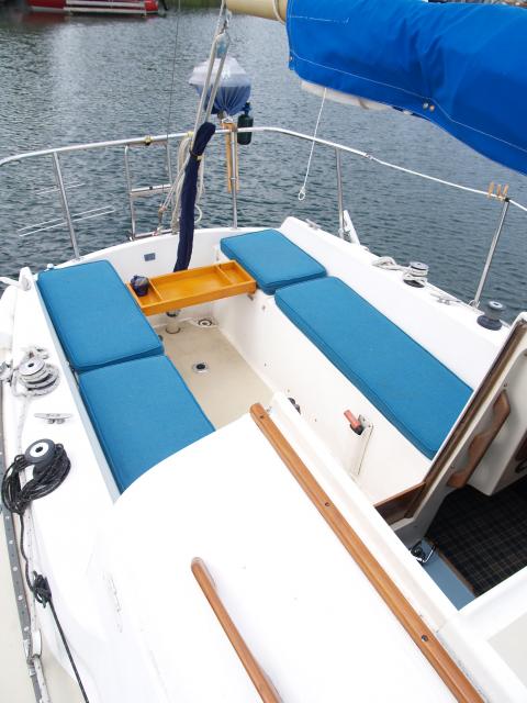

This was on our previous boat. I found this idea in Good Old Boat magazine. Its a pretty simple design and it could be modified to suit your needs. There are a couple of runners on the underside of the tray that keep the tray from falling to the floor. It can slide fore and aft.

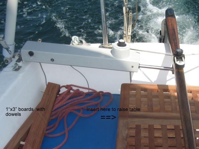

I bought the same table 3 yrs ago and it has worked well. Here's a tip Joe, if you put 2 1''x3'' boards in between the table halves (I used the ones on the left), you can raise the height of the table about 4 to 8 inches so you can get your legs under the table. Makes it much more comfortable. It also adds about 6'' to the length of the table. The one I got on Ebay was advertised as teak but the redwood boards match perfectly. I keep it under the tiller as you do when anchored or folded an stored in the head. It would also fit nicely in the laz.

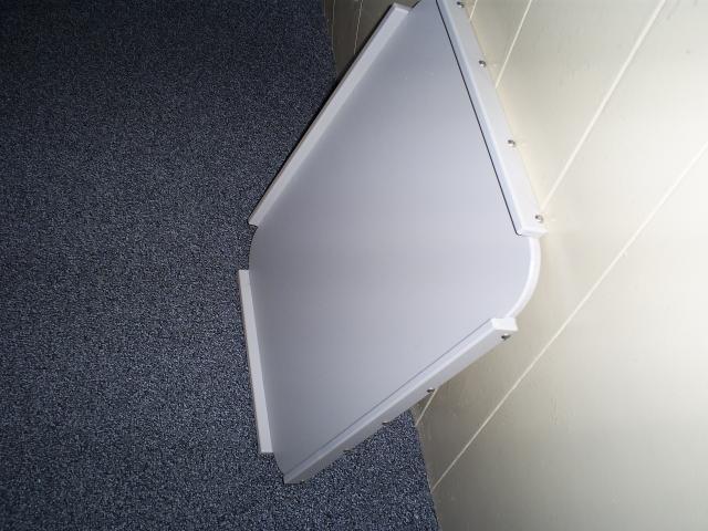

Sep 25, 2008
2,288
C30 Event Horizon Port Aransas
I just whipped this one out tonight. the table is the easy part(so long as you have UV resistant plastic lying around) It's figuring out a way to mount it that will get you.
