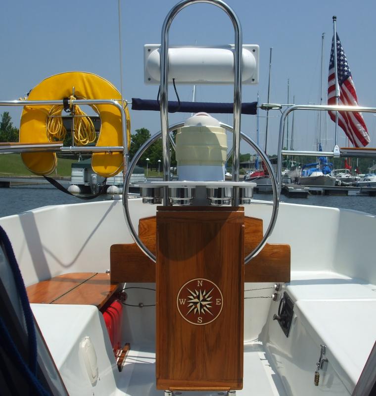

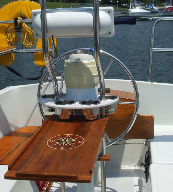

I just finished making this 12X24 Teak Cockpit Table and install it yesterday on our Seaward 23, can't wait to have my first glass of wine on it! It is made of solid teak with a custom Compass Rose Inlay. All the hardware is made with SS 1/4 rod and miscellaneous other SS hardware modified to fit my purpose. Thanks Pat 513 891 5112

Pat, did you do the inlay yourself? If so, how do you do that? Great stuff!

Very, very nice .... and the compass rose will tell you when it's safe to tack.
Mar 20, 2012
3,983
that is some very nice woodwork.... and a great addition to the cockpit.
I ordered the inlay from a company in Calif, cost $45.00. The challenge was how to fit/machine the inlay into the table top surface. I found a guy with a CNC machine to do it, cost $60.00, It was impossible to do it without the CNC. I was extremely happy with how it turned out!
