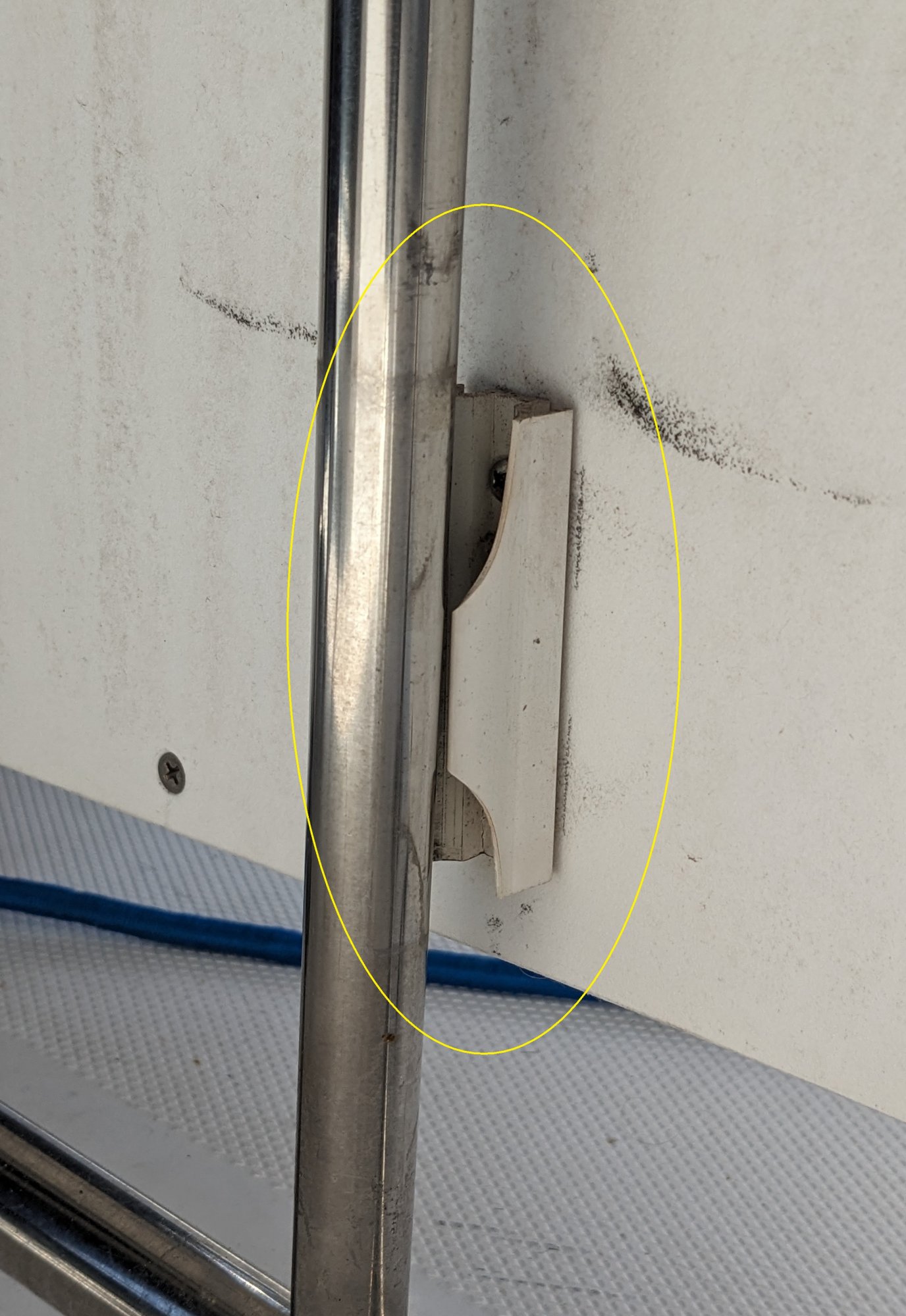

On our 2007 H41AC, the cockpit table leaves each have a friction latch that holds them in the folded position. The friction latch mates to a 3/4" tube. One of them recently disintegrated upon latching it in the stowed position and I assume that the other one will soon follow. The are made of plastic and are about three inches long. The one in the photo is still intact.
Does anyone know where one can get a similar friction latch?

Yes they are available in the store on this web site. Over the years I’ve purchased several sets of them and always keep 2 in stock as spares.
