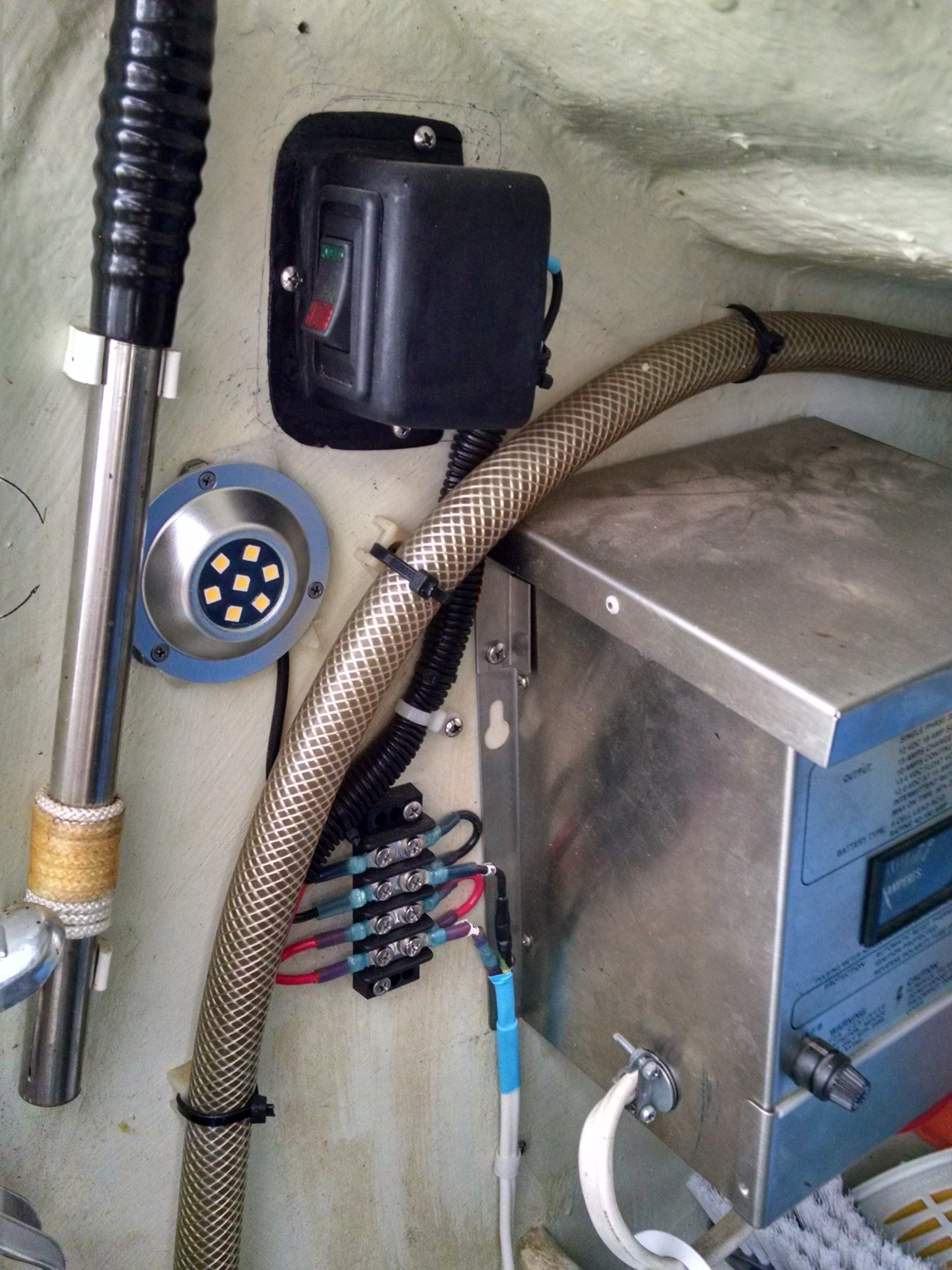

I'll send you some pictures of what I did. Used a waterproof puck LED light, about 3 inch, from Marinebeam and put a rocker switch inside the lazarette. Pics are on the office computer so have to send later.

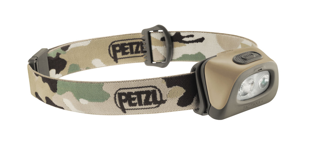

I have one of the forehead lights. Used it in the BVI's this last month.

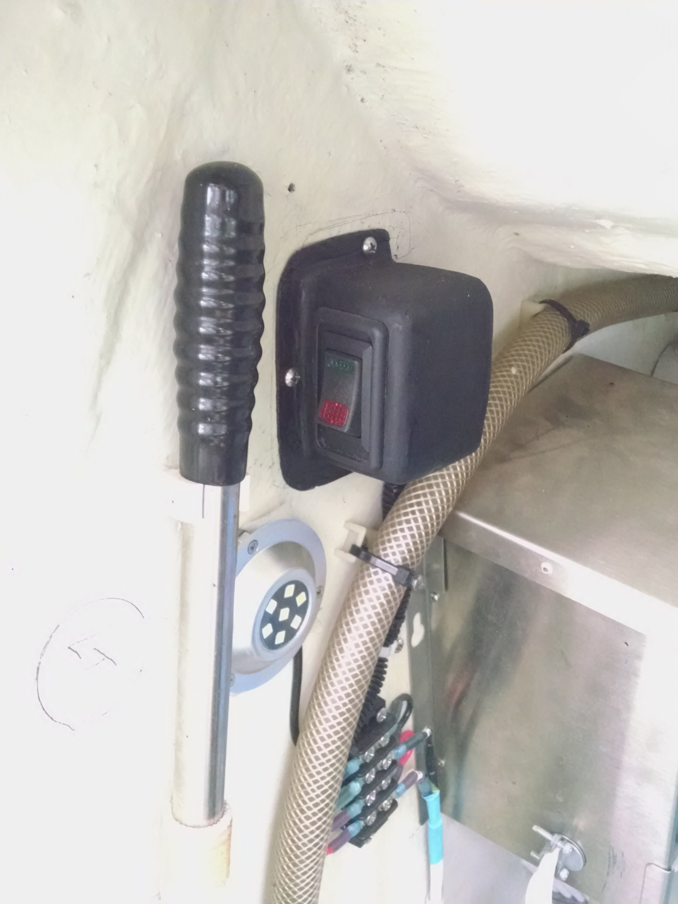

Here are the pics of what I did. The box for the switch was made by laying up fiberglass over one of those bubble packs that you get electrical connectors in then spray painted black. The switch is a marine rated switch, I'd have to do some digging to find where I sourced them. It's red indicator light is lit continuously when power is supplied to the circuit so it's easy to find when you open the lazarette in the dark. The two conductor cable you see leads back to the DC Panel to a separate breaker for "cockpit lights".
