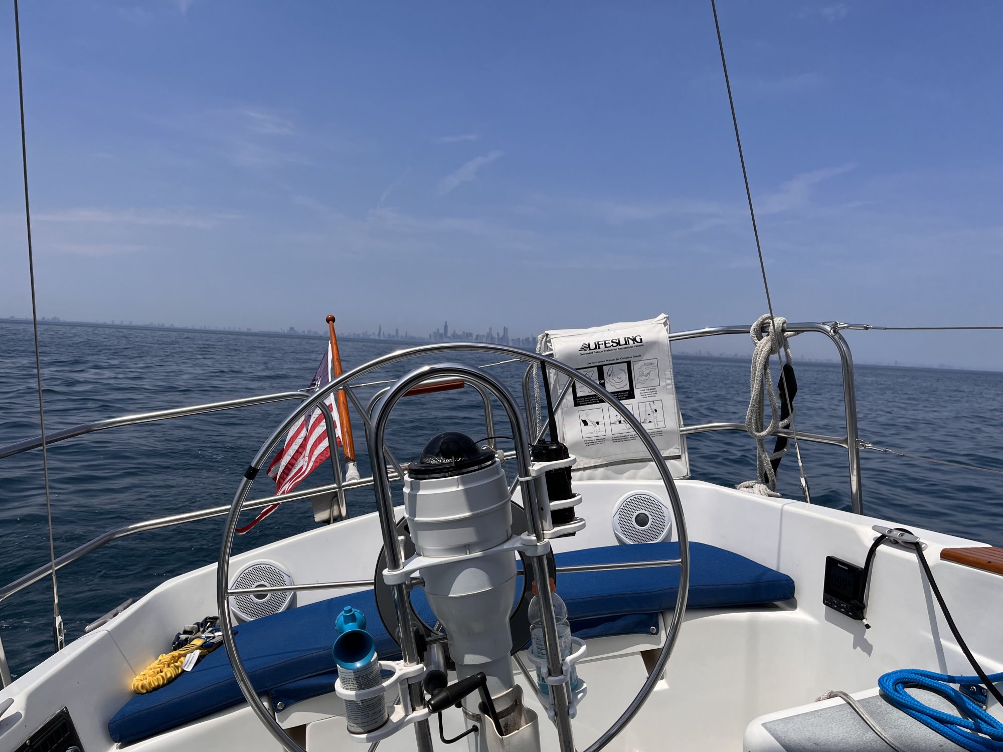

Mine are in the aft coaming because that’s where the previous owner installed them many years ago when there were fewer options. They’re above the seat cushion and I always sit between them rather than in front of them, so they‘re never blocked.
These are the 3rd set since I’ve owned the boat. Don’t remember what the first ones were, but the 2nd pair were Dual with a flexible perforated vinyl grille that disintegrated after a few years in the sun and the current pair are Fusion with a rigid grille. They actually sound pretty good to me.
If I was installing speakers today with no existing holes, I would seriously explore exciter speakers or Bluetooth with portable speakers rather than cutting fiberglass.
