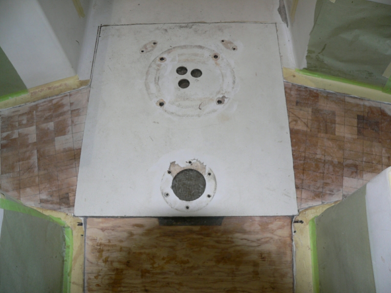

Had that problem with my C&C. Core under pedestal is likely to be plywood. If it gets wet it will debond itself from top layer of FG. Lean heavily on the pedestal. If the sole flexes you have a problem. Recored mine and put in solid glass section where sole is penetrated by rudder post and pedestal. No more core problems and pedestal is rock solid in 1-1/" of solid glass.

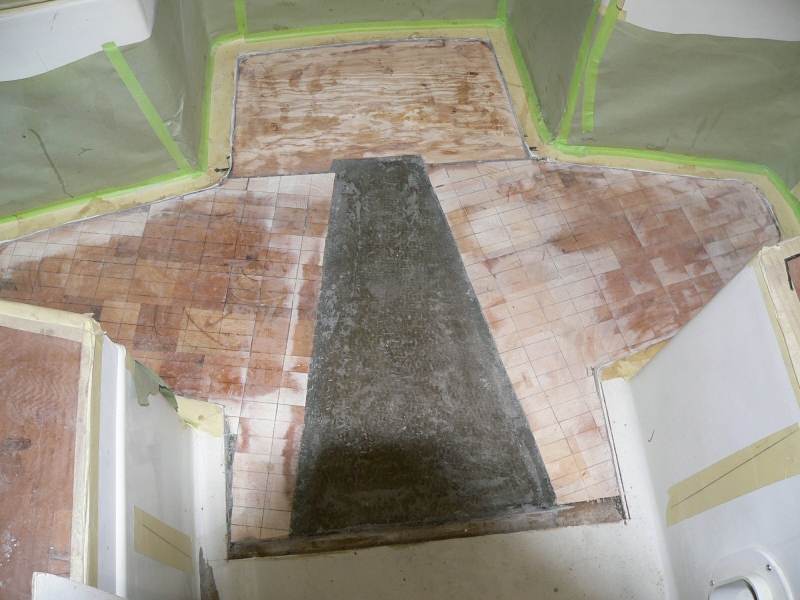

See attached pic of template. Note penetrations New sole had hardware bedded with butyl tape in solid glass. Problem solved permanently.

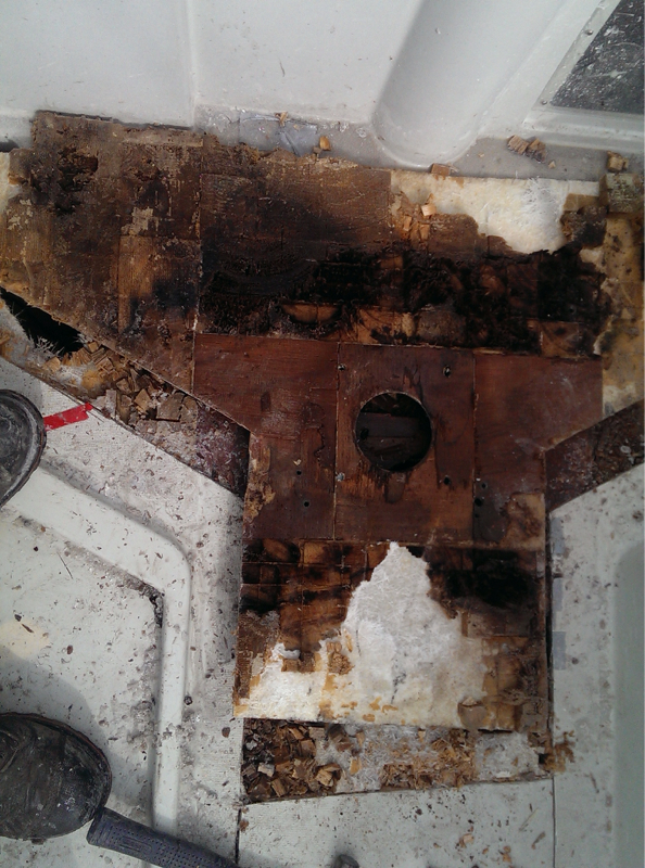

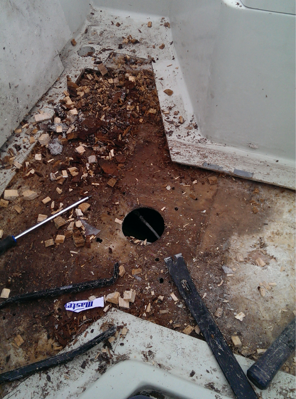

Ok so i finally ripped off the top layer! And yes it was all rotten, but some spot less than other, so some of the bottom layer came off with the remaining wood. Im wonderingif i should redo a whole bottom layer since it seems pretty thin to me. How would you proceed to fill the holes considering there is nothing under?! See pict 4.

i hate to come in late here but these jobs are usually better looking when done from the bottom up, the glass is usually more compromised underneath and the repair will not show in the cockpit sole, the upper glass is usually fine in any case because the water does not sit on it like the bottom layer, replace the core with coosaboard and move on, take your time, do good work, good luck.
Jun 9, 2008
1,850
- -- -Bayfield
The job is much easier from the top down instead of the bottom up because you aren't fighting gravity. I have done this repair many times on customer boats and it is not all that difficult. I would, however, where ever there is a fitting or bolt protruding through the cockpit sole, put solid fiberglass at those critical spots so that moisture doesn't penetrate the new core material and ruin it all over again. Of course you want to liberally caulk bolts and fittings as well.

solid glass
Check the picture from my boat again. Keystone area under pedestal and at rudder post is solid glass. No way for water to get into core. Marine ply for rest of pedestal area and balsa core for forward sections. Better than new and good to go for a long time.

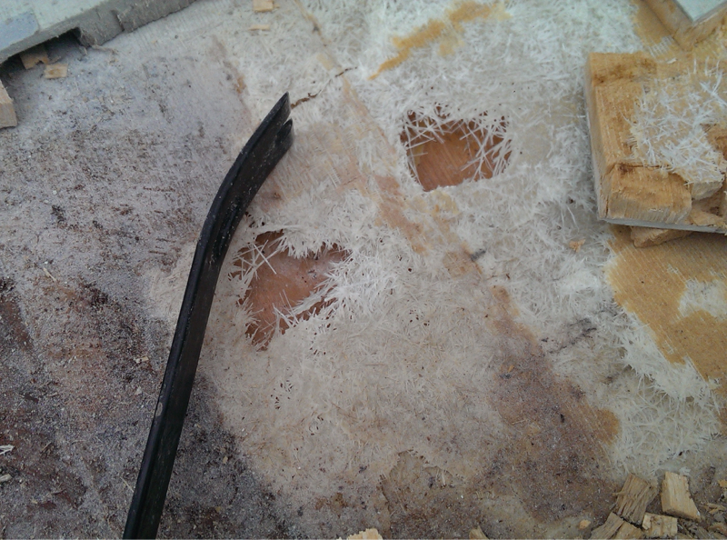

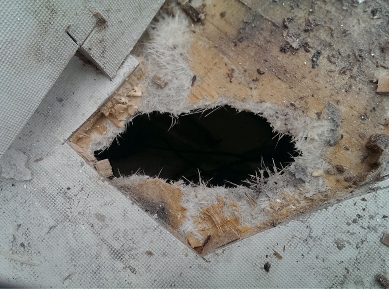

Ok thanks for your replys! My question is: considering the bottom layer of the sandwich is now pretty thin due to the removal of the core (some fibre stuck to the wood that wasent rotten) and some hole appeared where the glass just stuck under the wood, should i just reinforce with a new layer of glass on the bottom or just patch the holes? Refer to the pics to see the kind of holes im dealing with! Thanks. Ps. It dosent have to be so pretty considering it will be under the new core.
