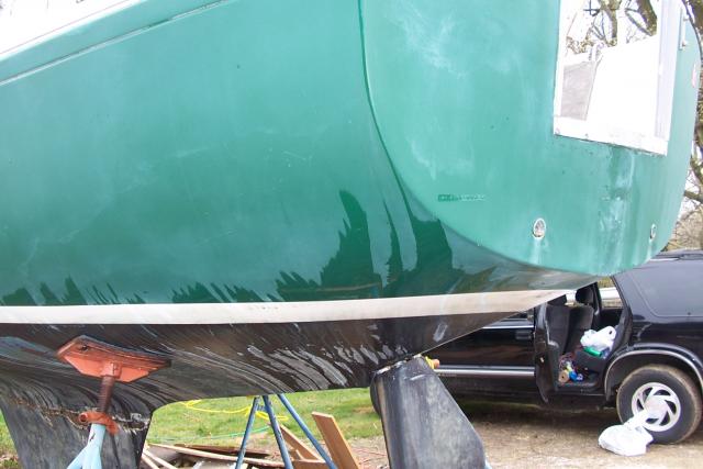

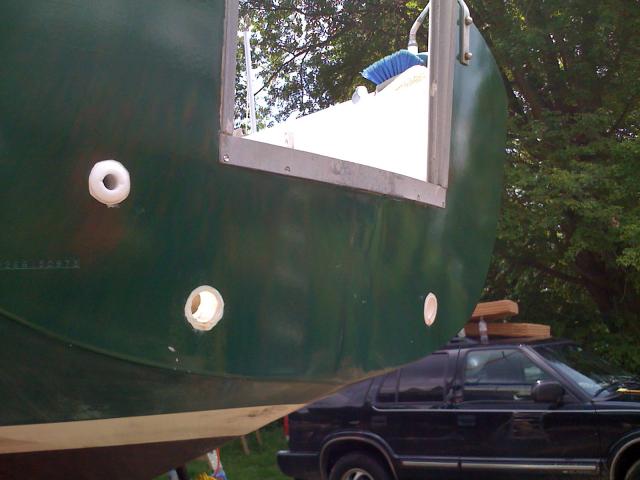

The transom of my Grampian 26 has two holes through it to drain the cockpit sole. When I bought the boat, these were small, easily clogged, and lined with badly degraded brass tubing set directly in the plywood transom core. To ensure that the cockpit had adequate drainage in rough weather and to at lease prevent future leaks if not remedy prior damage, I cut slightly larger holes in the transom, filled the surrounding cored area with thickened epoxy, and fitted the holes with pvc pipe I'd cut and ground to be flush with the cockpit sole.
The new drains do not leak into the boat or the laminate core. However, once we were on the water last summer, we noticed two things: first, when using the outboard or sailing with more than two people in the cockpit, seawater came in the drains and would get everyone's feet wet. Second, there was a significant leak into the cockpit sole core from the top of the rudder shaft that necessitates re-coring the cockpit sole this spring.
As part of that project, I am debating whether to change the cockpit drain system.
I like the idea of drains mounted flush to the sole itself connected to a thru-hull below the water line. However, unless I close the seacock every time we use the outboard or have guests, that won't remedy the wet feet problem and will risk that I'll forget to open the seacock afterward and thus lose the benefit of the drains. It would seem better to just put flapper valves on the outside of the transom that will prevent backflow into the cockpit, but that is something I've never seen on a boat this large. Are there any reasons not to do that other than aesthetics? I'd appreciate hearing about any experiences others have had with drains through the transom. Thanks!
