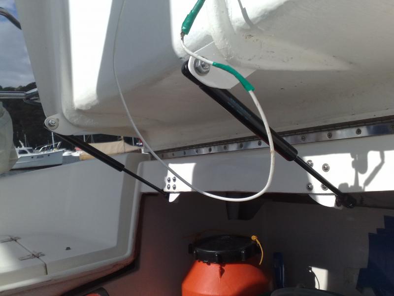

Have finally managed to eliminate the Guillotine effect of the cockpit locker lid with two caravan gas struts (one for redundancy). Works like a charm.
That looks like pure genius, but you gotta give us more details. I really like this idea!!! :dance:Have finally managed to eliminate the Guillotine effect of the cockpit locker lid with two caravan gas struts (one for redundancy). Works like a charm.
Thanks. I looked up 150N and they magically came up so I know how to find em. Admiral sewed a bag up with some old heavy sheet and felt lining for my wash board and I stow mine back there as well sitting on top of a life preserver bag so they are out of the way. Again a brilliant idea.... The struts are 150N. ... Attached pictures show struts from other side and the stored washboards. ...
