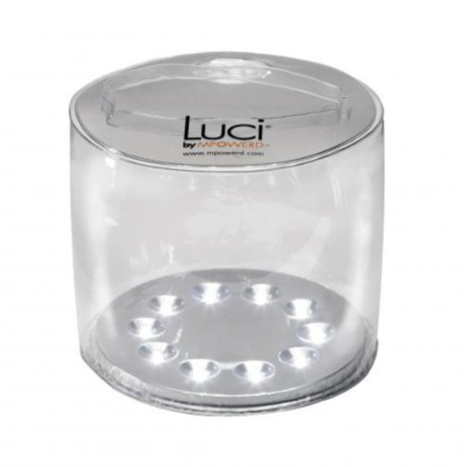

We just found these and bought one just to see..
http://www.amazon.com/MPOWERD-Outdo...TF8&qid=1446397350&sr=8-2&keywords=luci+light
It makes a fine cockpit lamp . Has bails to hang it from bimini frame puts out plenty light.. deflates to almost no size. has high and low power settings.. would be fine as an anchor light as well if positioned correctly.. downside is ya have to take it from under the bimini and put it in the sun to recharge..

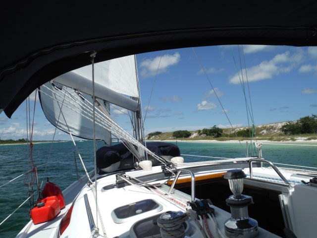

Solar garden lights are the best bang for the buck. Don't buy the $1.99 ones at WalMart-they just don't hold up as well as the ones in the $5 to $6 dollar range sold at Lowe's and Home Depot. The solar cells and LEDs last for years, you'll want to put in a new rechargeable battery every year or so if you want the lights to stay lit all night. The best thing about them (for our boat, at least) is that when you pop the lights off the ground stakes, the stub on the bottom of the light fits perfectly in the handle hole in the top of winches.We keep lights sitting in two or three of our winches, and they've stayed put through 50 knot winds. Here's a picture that captures one on Eagle Too.

I second the Luci light. I hang it from Bimini with a small line or place it on the cockpit table. I even use it as a work light in tight and dark spaces. It holds it's charge for a long time as well.
