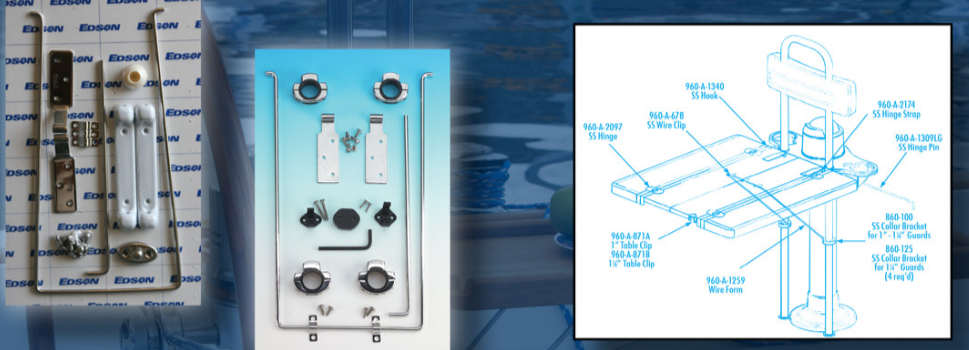

.................I'm more interested in the hardware used and how it was mounted...........
Edson Marine sells cockpit table hardware kits for DIY'ers. Below are some of the examples of what they sell with a diagram of one table example.

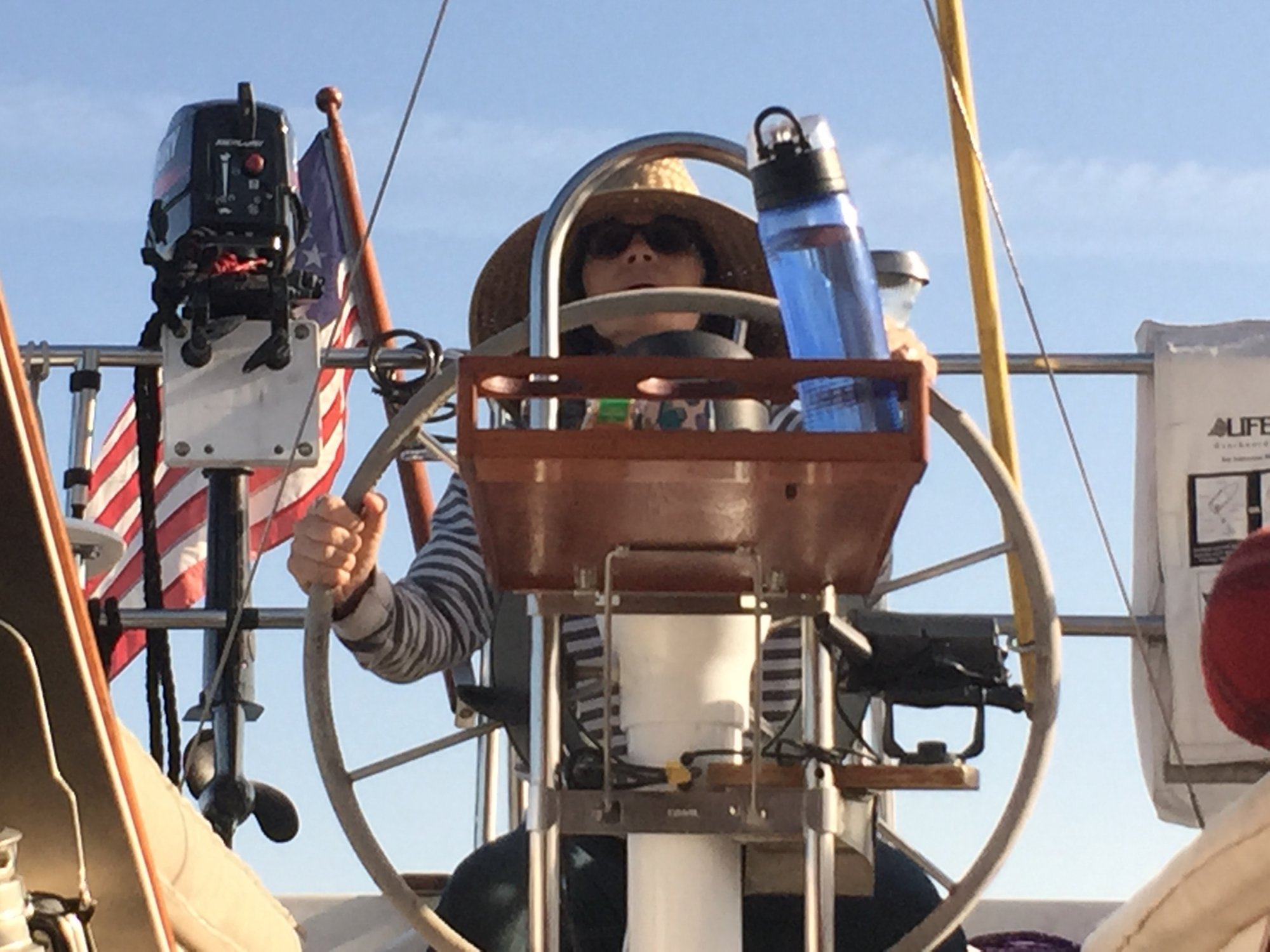

I didn't make it, but mine is very similar to the Edson one as posted above. I don't have the leafs though. I get three cup holders instead and a nice lip edge all the way around.

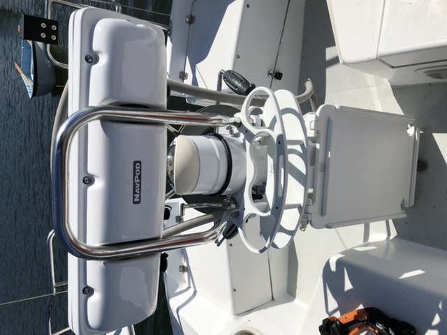

And Zarcor makes cup holders too (apparently the product line includes sideways versions for port tack applications)
24,591
Oh the shame Meriachee. For a talented videographer to post a sideways image:thumbsdown: and then call it a "Port Tack" special... :liar:
You just have an iPhone picture and it is controlling you. :yikes:
