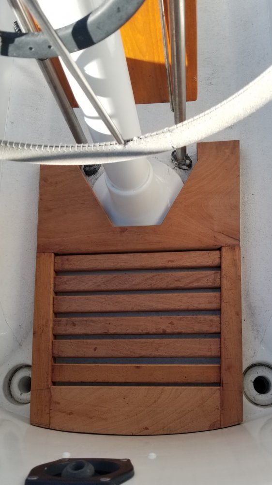

I started my floor grates and got to roughing out the rear grate which starts at the pedestal and goes aft.
I'll update with pictures as I make progress.

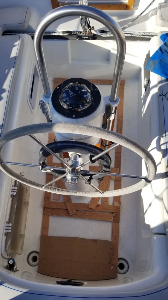

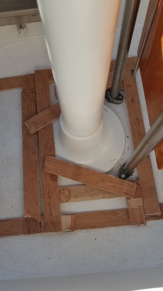

I started by making templates using luan strips hot glued together. This is a countertop manuf. technique. This allows for making something with no square corners and unequal features like a fiberglass boat.

20180707_190337.jpg 20180707_190238.jpg 20180707_190303.jpg 20180707_190517.jpg 20180707_190506.jpg 20180707_190303.jpg 20180707_190238.jpg

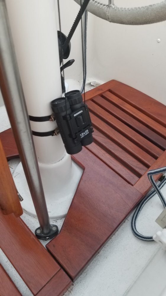

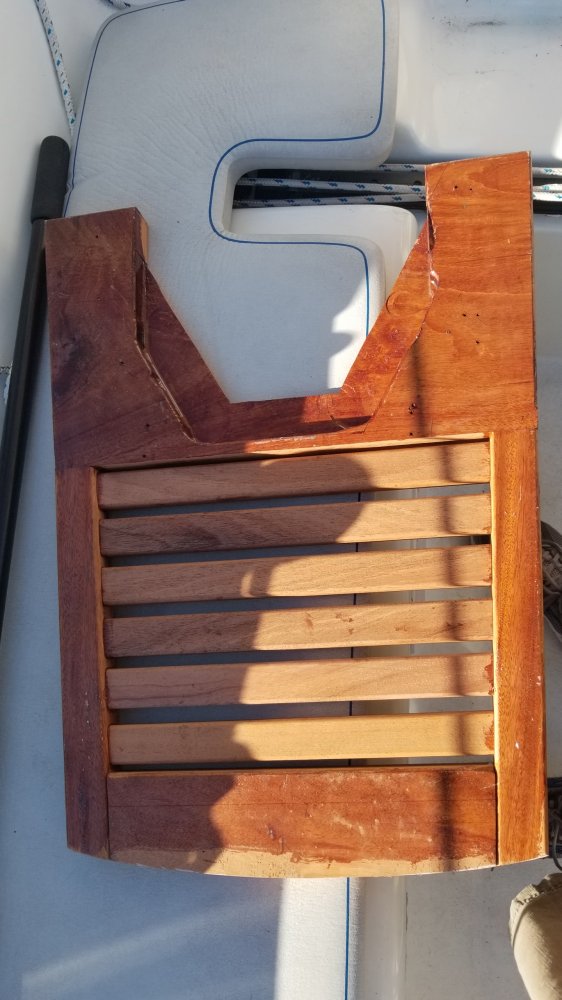

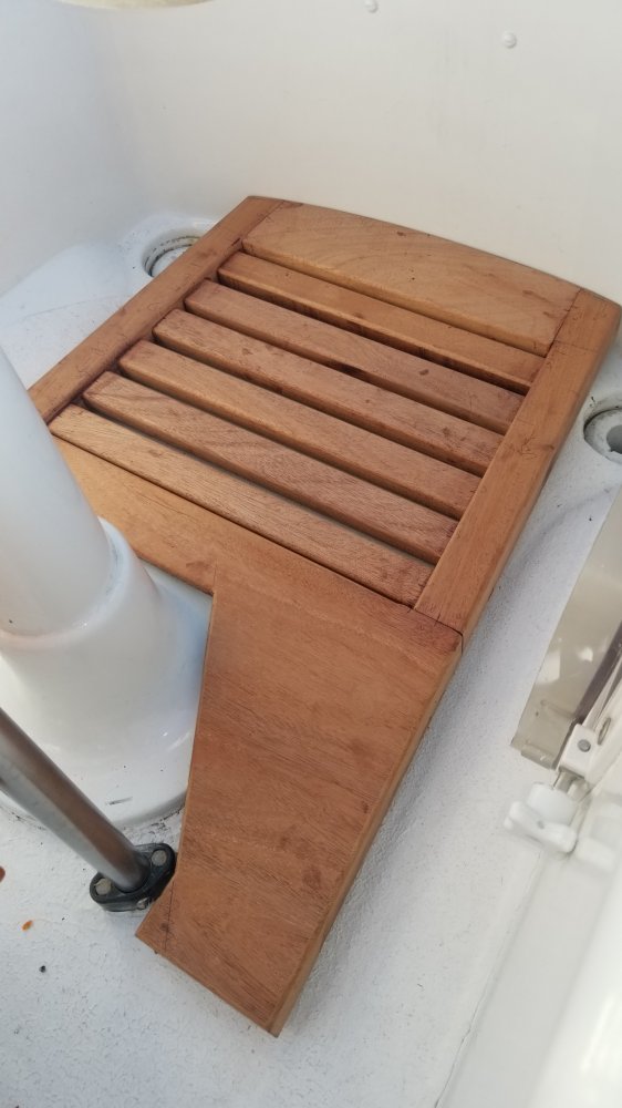

Two sections. Rear goes from the front the pedestal guard back. Templates are luan strips put together with hot glue.
Mahogany using epoxy and loose tenon (Domino) construction. Rear section isn't finished. I wanted to test fit prior. The slats are about 1/2 inch off of the floor. I'll dado in channels on the bottom of the frame to facilitate water drainage. The one picture is of the bottom. I used a router (not my most professional moment as you can see) to remove material to accommodate the pedestal foot. I had a bunch of epoxy left over so I coated the bottom for direct contact rot resistance. I'll sand it all down flat. Finish with me a penetrating stain called Ready Seal. I use it on my Meranti deck and it works well. I have a semi professional shop that I have built all of my cabinets in my house with ( beaded inset faceframe) out of maple, oak and mahogany. All of my stock is either rough or thick that allows milling which I enjoy.

A couple months into our and the finish is holding up amazingly. Looks brand new. I ended up screwing a couple layers of flat webbing to the bottom on the corners to eliminate wobbling. Works great, allows water to flow underneath and is quieter.
