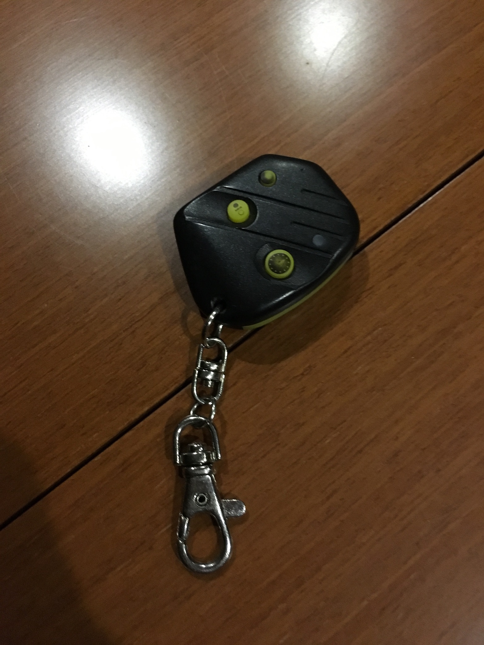

On our 37 they are remote controlled. You might have a "key fob" style remote somewhere that triggers a Aqua Signal receiver.

Found the fob as well on our new to us Beneteau, thank you everyone for addressing this. Our lights seem to be on a timer in that they go out after a couple of minutes, is this your experience as well?

The biggest button on the fob puts the lights in timer mode. I think one of the other buttons might be a plain on/off button, but I’m not sure.
