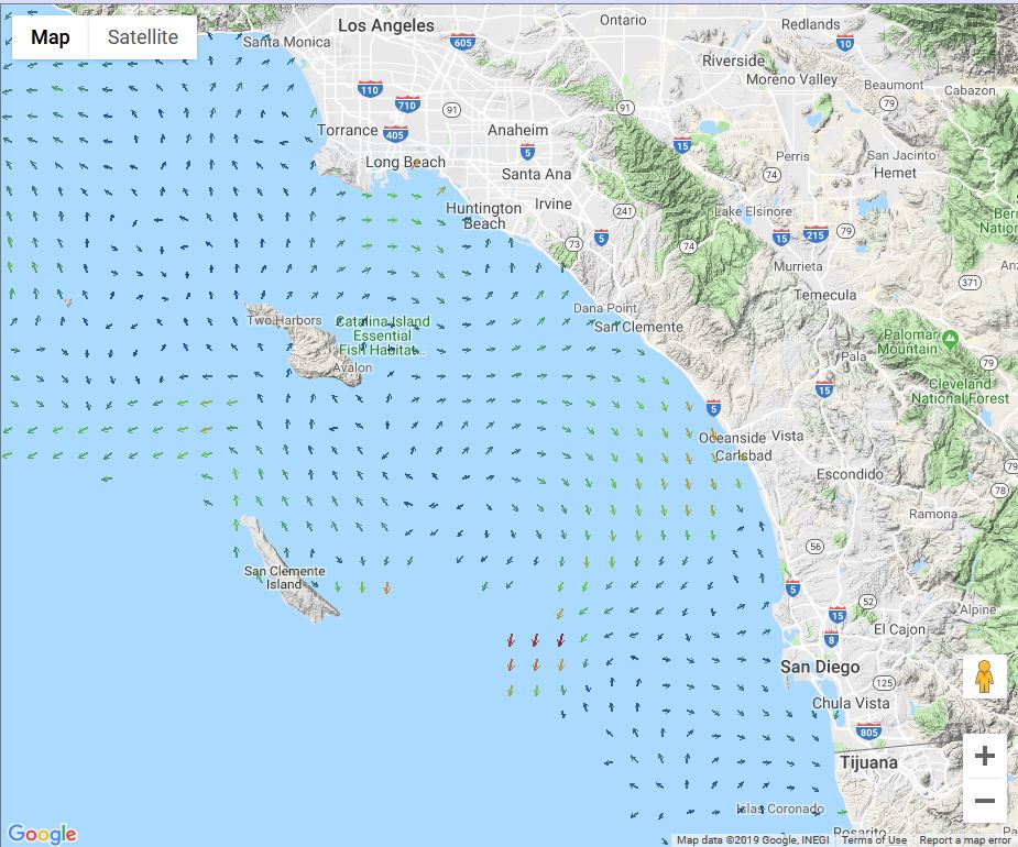

Then there are ocean currents that will try to grab and slow your boats hull. Known as the California Current it swirls along the coast helping and hindering sailors. Here is an image and a link to give you further access.
http://www.sccoos.org/data/hfrnet/

And I hope you will get a favorable breeze to urge you forward under sail. But like all challenges this is often not the case for the Southern Cal Coast. More often than not the breeze is out of the Northwest. I know that is where I live and sail. I'm sorry about the bad breezes.
