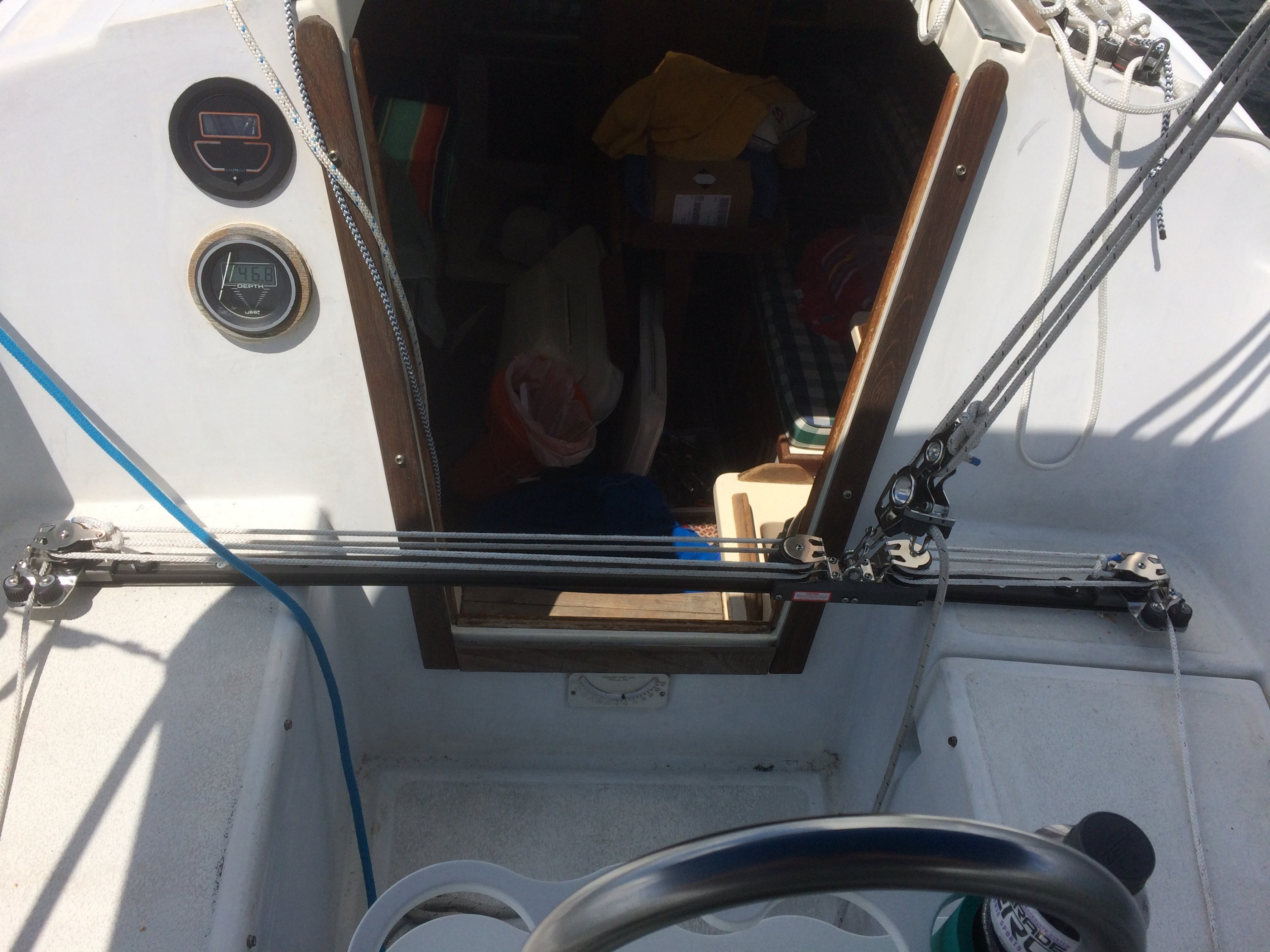

I moved mine to the companionway for ease of use while singlehanding. The control lines are easily within reach on the cockpit seats. The only complaint is from my dog who hasn't yet figured out how to go over it to get down the steps so she has to squeeze under. image.jpeg
Nov 8, 2010
11,386
I moved mine to the companionway for ease of use while singlehanding. The control lines are easily within reach on the cockpit seats. The only complaint is from my dog who hasn't yet figured out how to go over it to get down the steps so she has to squeeze under. View attachment 133562
Good mod! Its a sailboat, not a dog house!
Likes: GregL564
