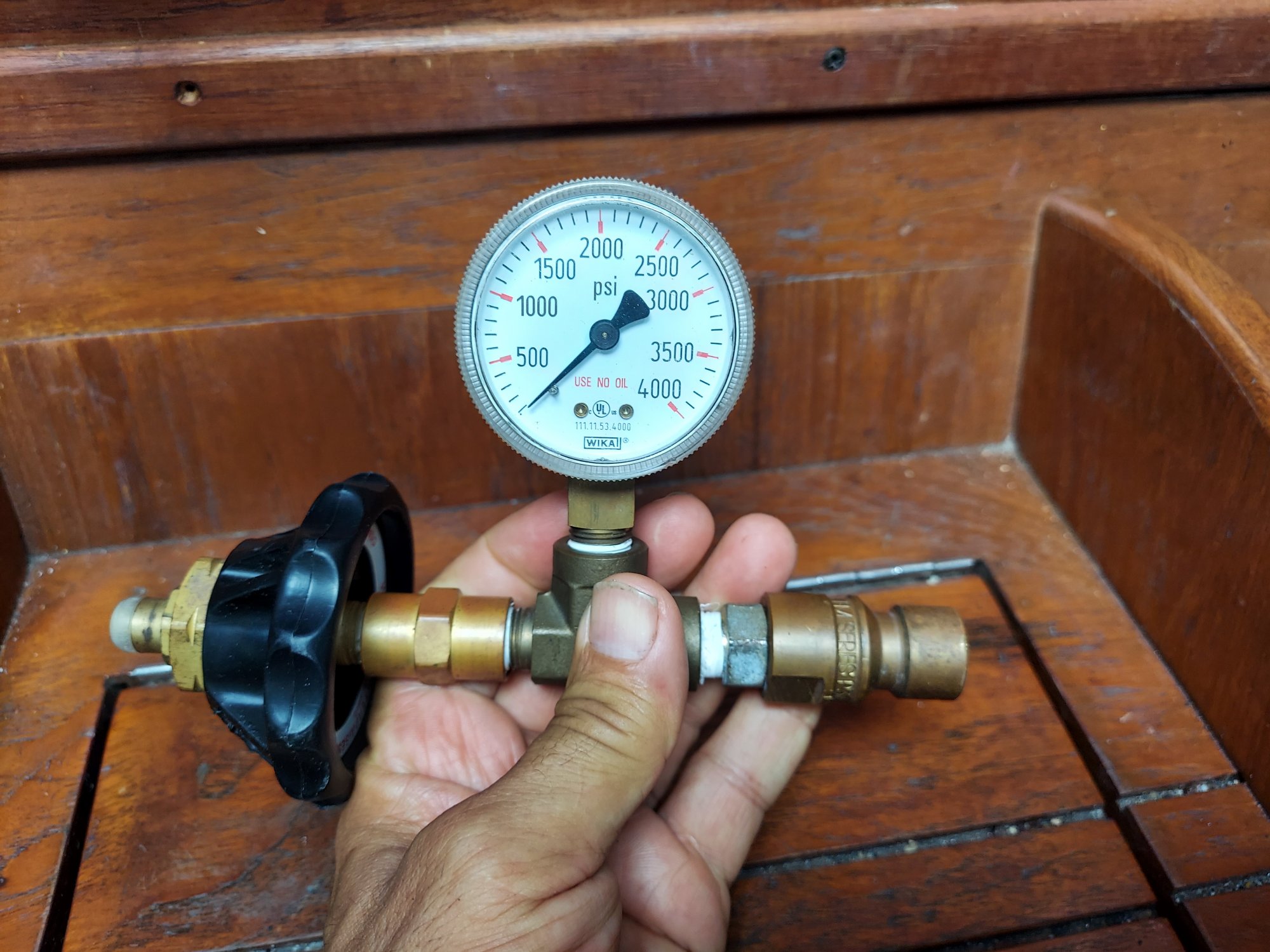

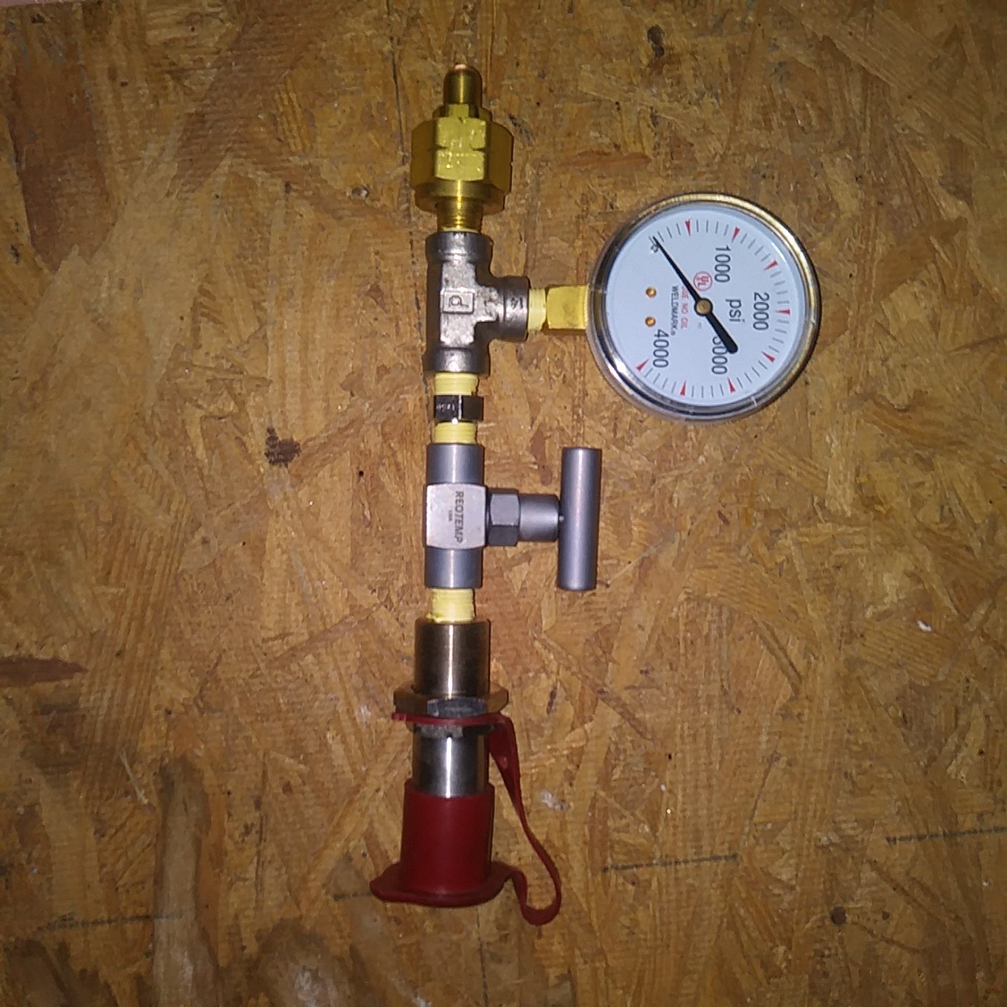

You will need to buy or assemble a CNG fill adapter to be able to fill a typical boat CNG cylinder from a commercial CNG fill station. They operate at a pressure of over 3000psig and your boat tank is probably closer to 2000 or 2400 psig or so. You may or may not be able to use the commercial station since the pressure exceeds the rated pressure of your tank. In addition, you tank needs to be current on its pressure certification.

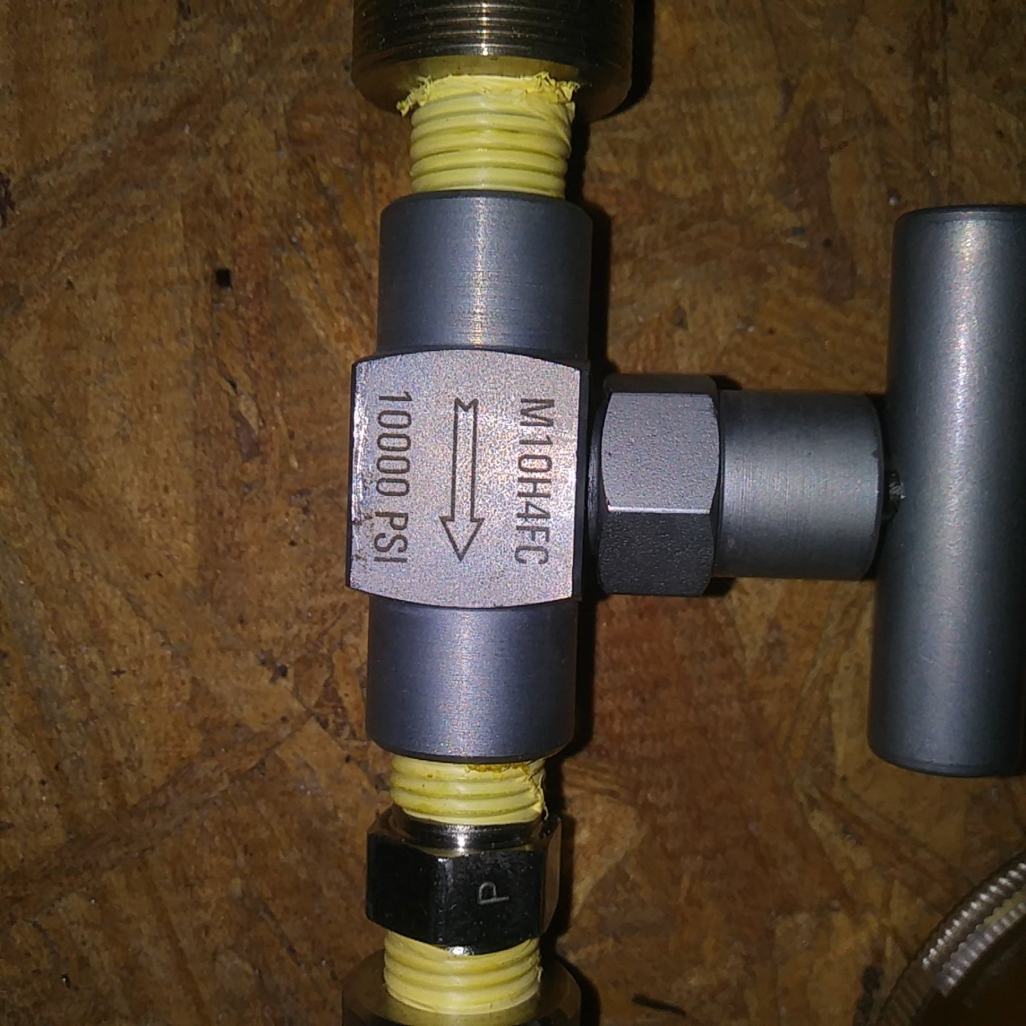

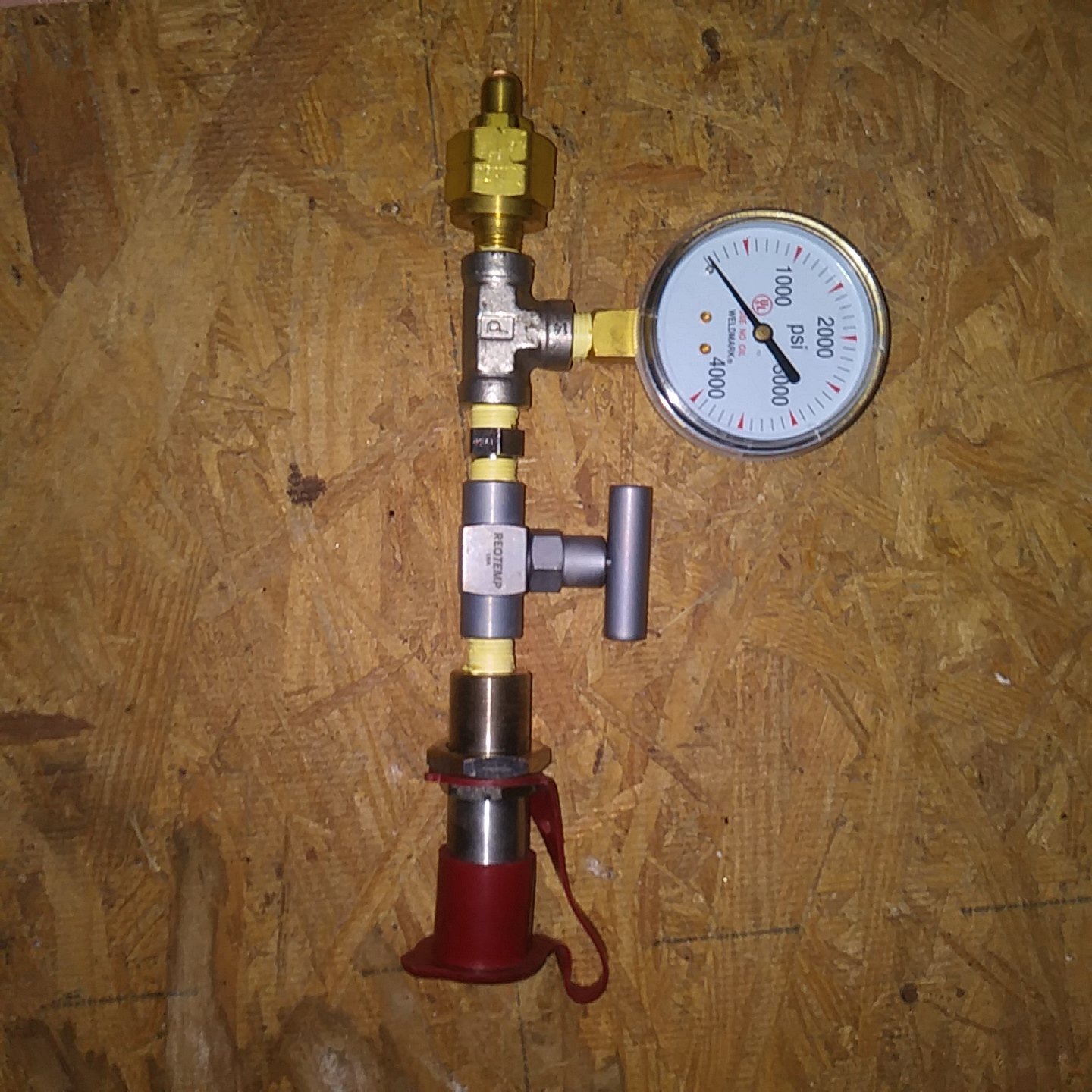

All that being said, its not really difficult to assemble a fill adapter and to fill the tank. Its a little "scary" at first. The key is to have a "throttle valve" in the adapter before it gets to the fill gauge and tank so you can crack it open and fill slowly. Otherwise it will fill very very quickly and it heats up when you fill quickly and its easy to overshoot the pressure allowed by your tank. All your fittings and components of the fill adapter you assemble or build should be rated at or above the pressure of the fill station so 4000 psig rated components is a must.
Here is a picture of my adapter. You are fully and totally responsible for safety of your assembly and I take no, zero, nada, responsiblity for what you buy or build.
View attachment 195034View attachment 195035

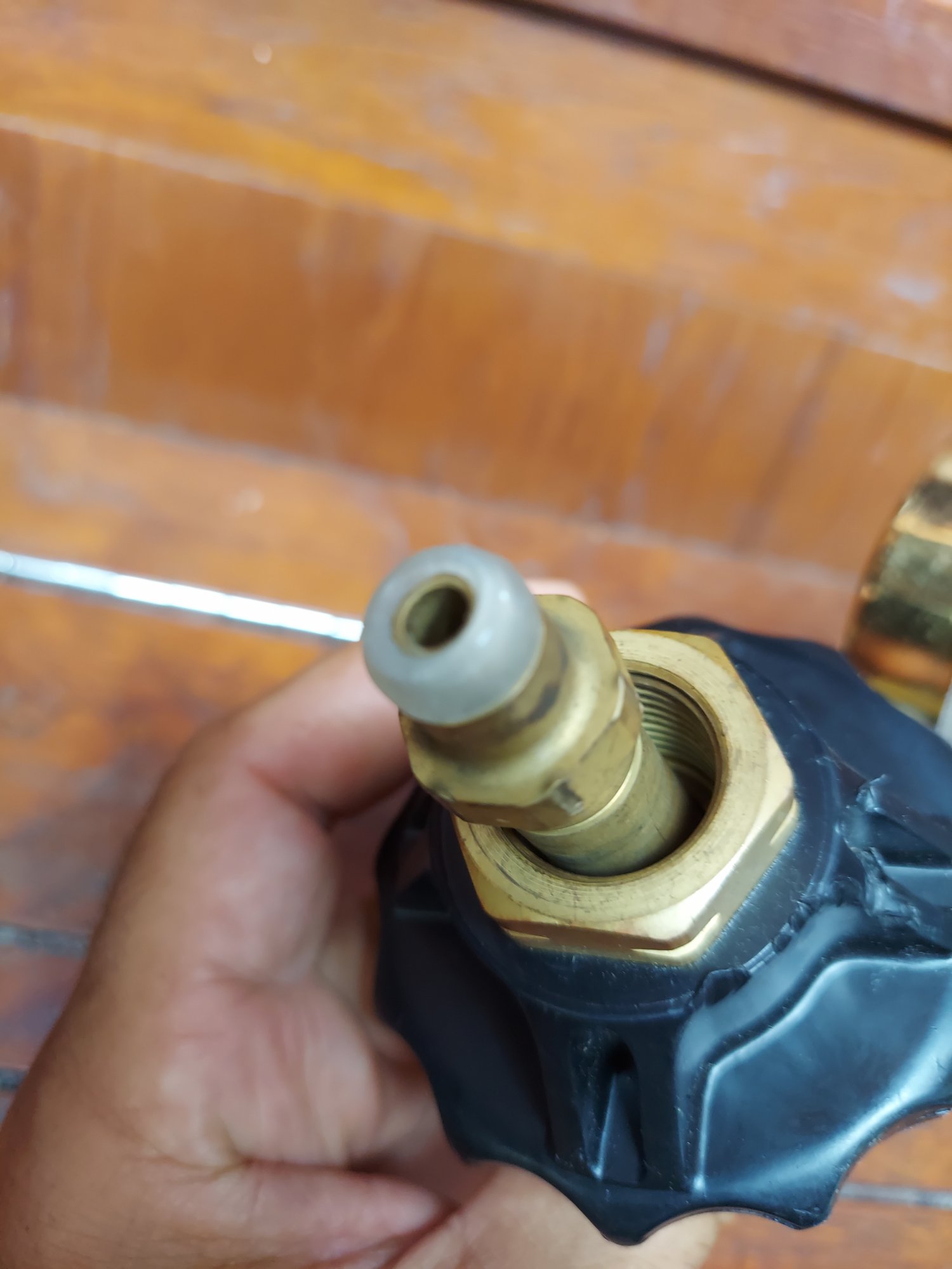

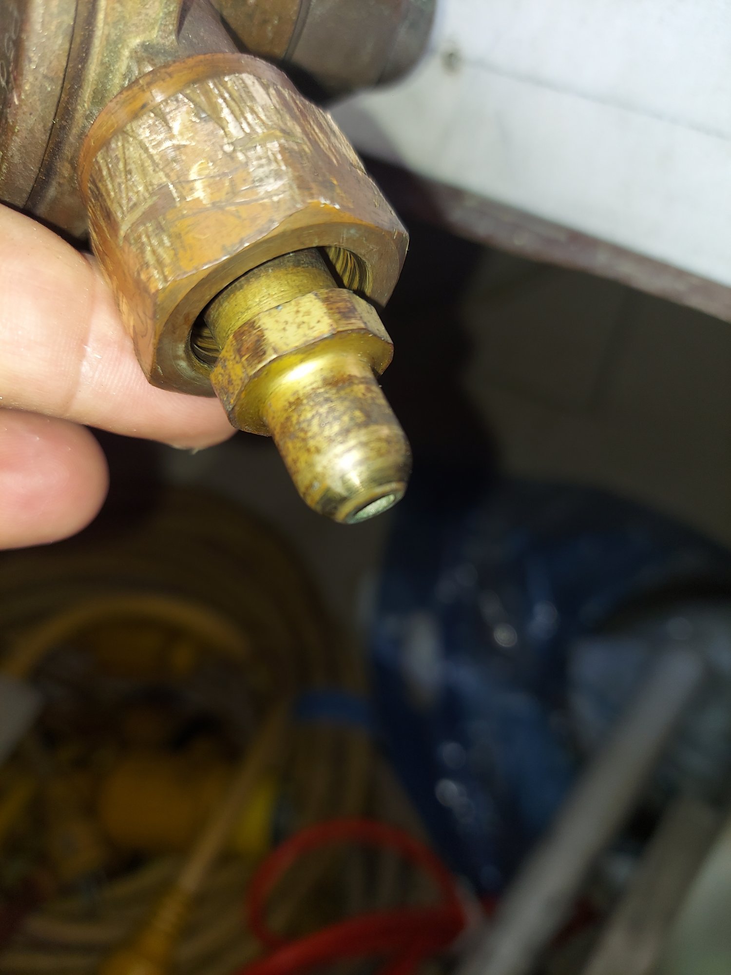

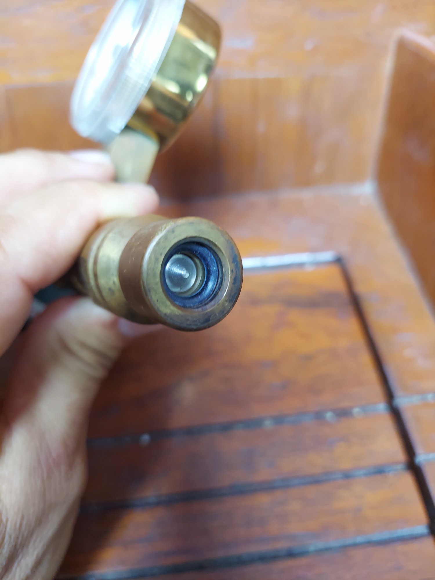

Then I tried to hookup the regulator to the cylinder (male-female type of connection) and dispite tightening very well, when I open the valve, gas comes out very strong. The seal is not good.
Does the connection need a gasket or anything like that?
Where online can I get it?

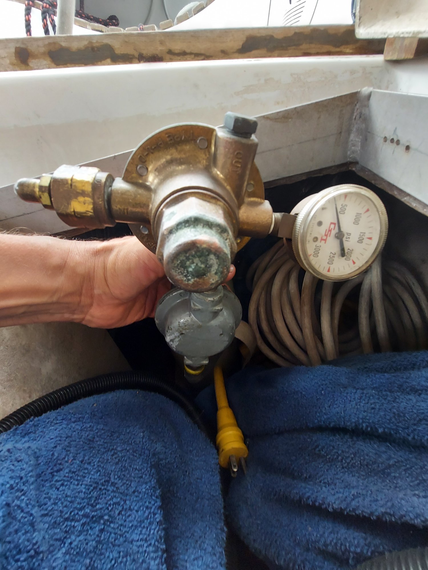

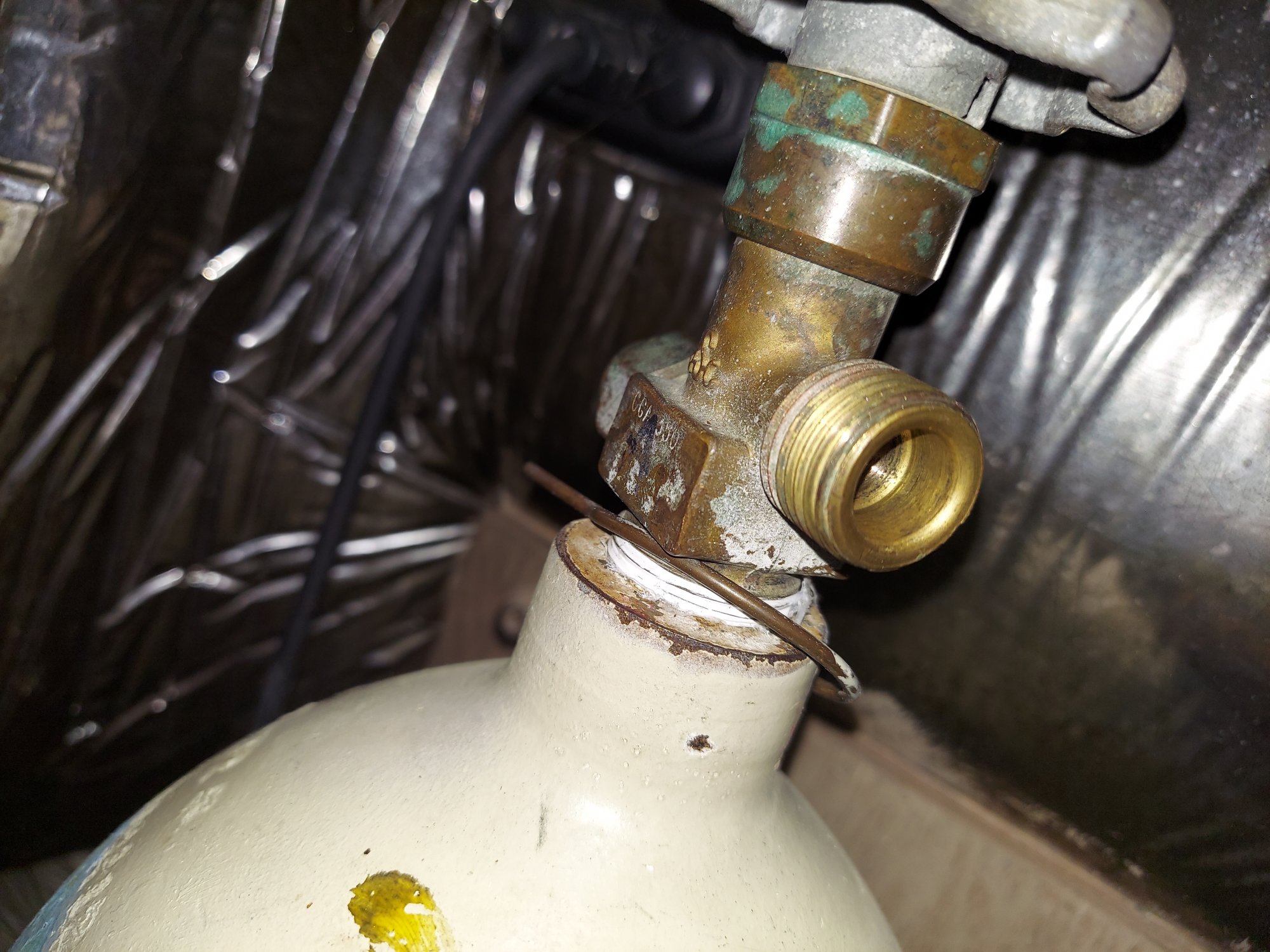

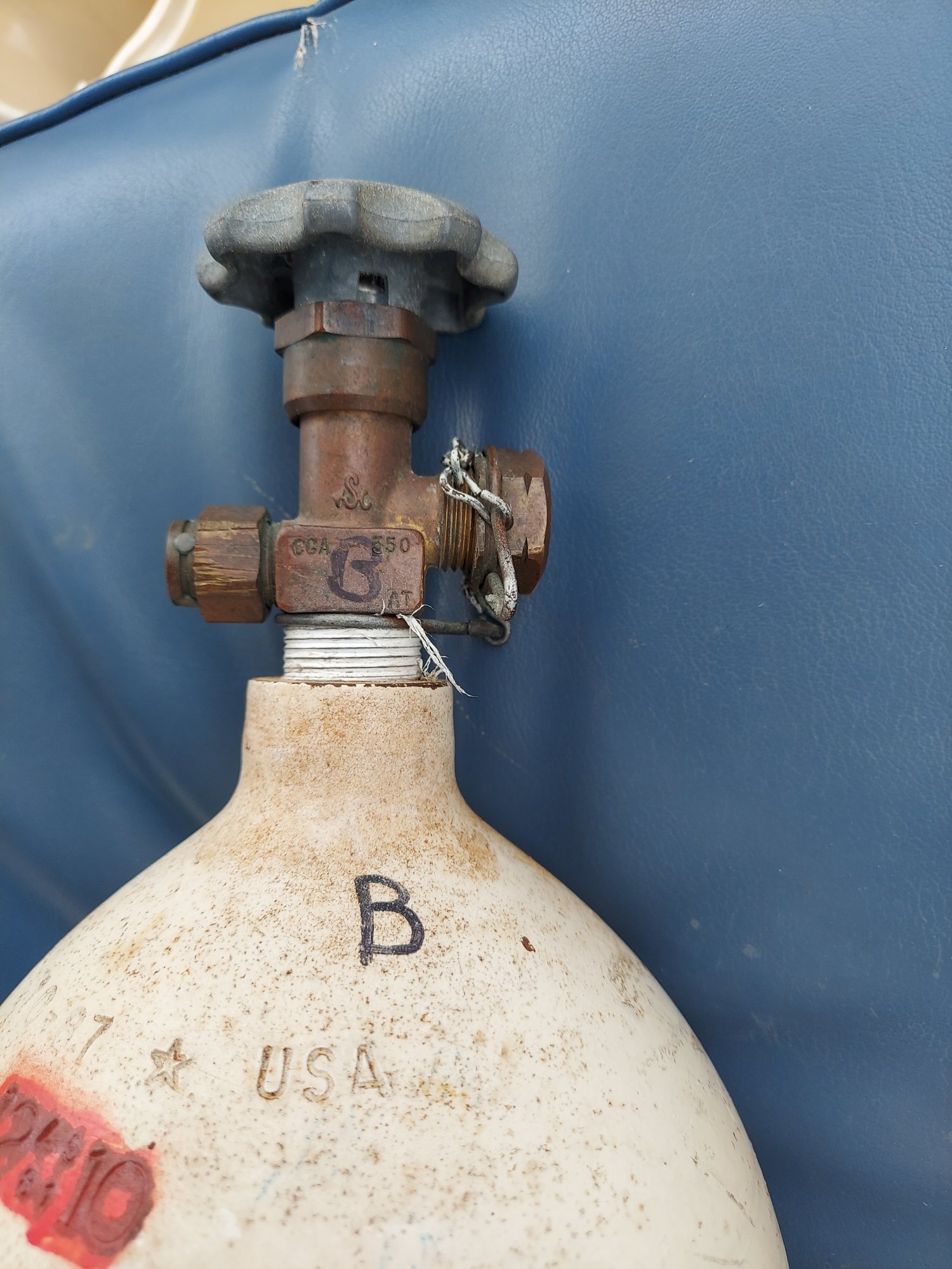

@Joshua770: Until you know more about your tanks and regulator and related CNG pressures I would suggest you do not try to refill on your own any more. It can be done safely but you need to know the parameters, risks and what you arer doing before you do it. Just because you have a 4000 psi gauge doesn't mean you should be slamming 3500 or 4000 psi into your tanks.
Can you post pictures of your tank(s), valves and regulator? If they are similar to what others here have you might be able to get some help.
p.s. "When compressed to 3,600 psi, one GGE requires .51 cubic feet of space in a CNG tank". You can do the math on the gallon equivalent for your tank size.

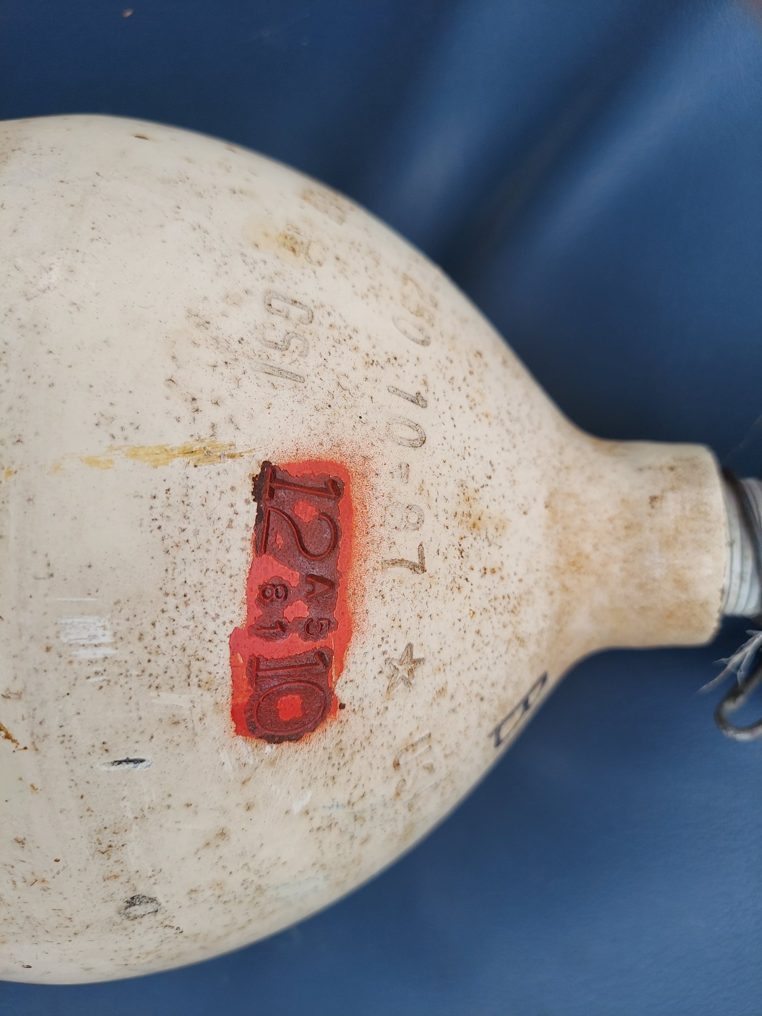

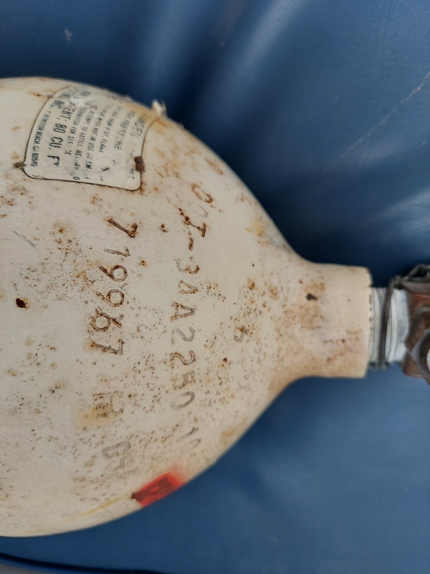

Here they are.
I was able to load them from the browser

Where it says 3AA2250 means the rated pressure is 2,250 psi. I would be very nervous filling it to anything more than that. There are some rules that say the rated pressure is at 70 degrees or something like that and if the tank is hot from filling it is okay to overpressurize it to a certain extent (but never over 125%) as long as it drops to no more than the rated pressure after cooling down to 70 degrees.
Where it is stamped in red "12 10" means it was last inspected / hydro tested in December 2010. My understanding of the rules are that the tanks need to be tested at least every five years so unless there is another, more recent, stamp it is way out of date.
I get my tanks tested at a gas supplier that does hydro testing on their site. About $25 per tank.
See Smokey73's post #3 about an adapter with a "throttle valve". I think you definately want that. Otherwise you have to be very quick to shut off the pump before getting too much pressure in the tank. I would not use an adapter without the throttle valve. I wouldn't even want to be standing around someone using an adapter without one. A friend of mine does and it makes me nervous just hearing him talk about it. You have seen how fast the pressure rises.
My regulator appears almost identical to yours. I don't use a gasket. When attaching the regulator to the tank I make sure the mating surfaces are clean and when doing the final tightening I let the regulator twist a bit, maybe an eighth of a turn, as I'm snugging up the nut. I usually get a good seal but test it by turning on the gas to pressurize the system then turning off the gas and seeing how long it takes for the pressure gauge to go down. If it's an hour or more I figure that is good enough.

PPS: Note that the gauge on your regulator only goes to 3000 psi. I might not want to attach that to a tank that had as much pressure you suggested you might have put in your tank.
NB: Nothing here should be construed as my giving advice or suggesting that you should fill your own tanks. This is just to relate my experience and suggest you do your own research before making any decisions about doing so.

Richard thank you so much.
Finally I know how to read the engravings in the tank.

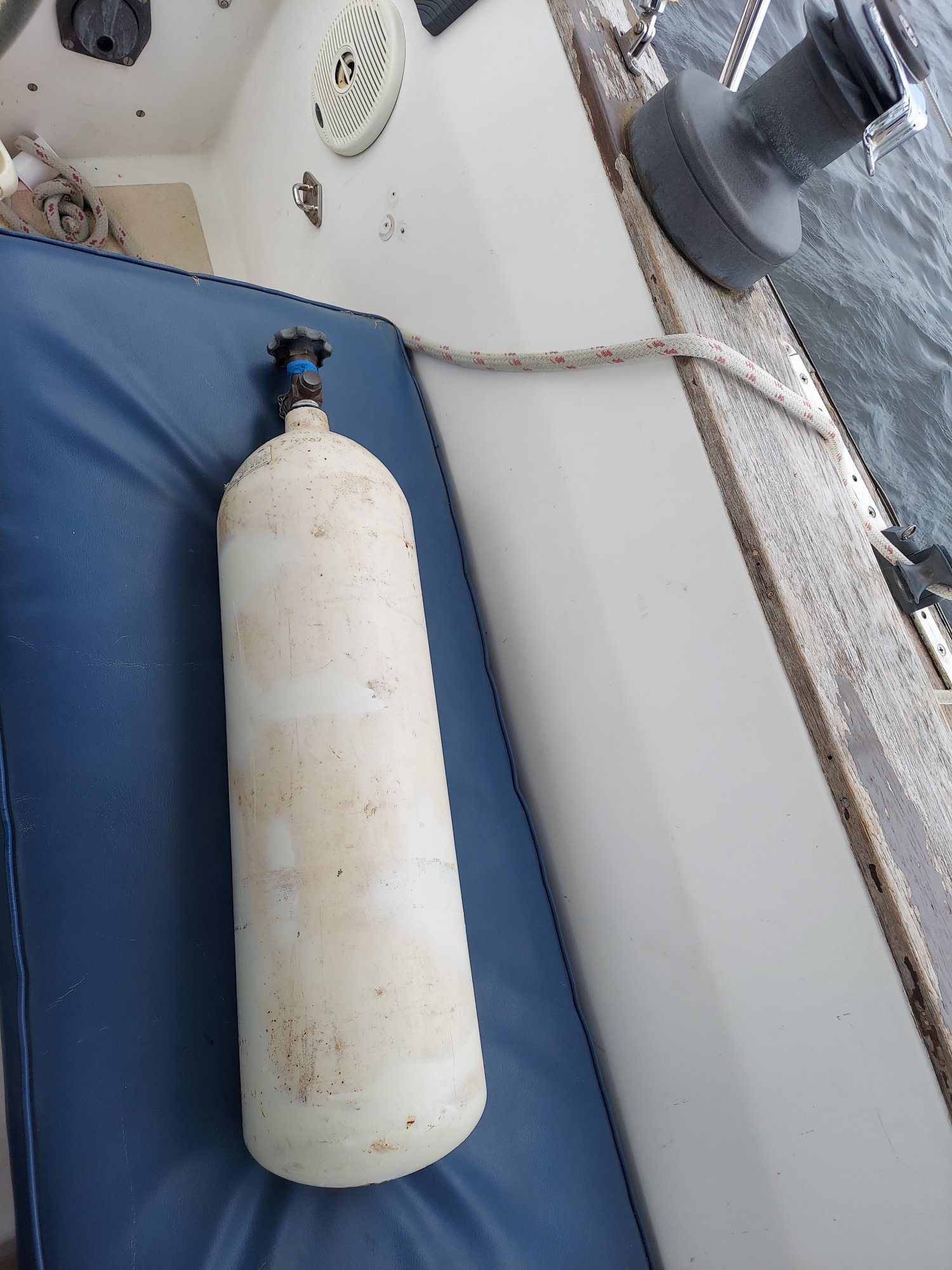

Hi, I just got my CNG stove working. I went to Trillium in Florida and you can fill the tank there. My stove had never been used. It is a 1994 35.5 Hunter Legend and no one knew how to fill the tank or where to fill it. It cost me a whole $1.67 to fill the tank. Put 2000 psi in just to make sure I did not overfill. The stove works perfectly and I am very excited to have it working. I didn't want to do propane, that was going to be a job to get the tank outside and all the way into the galley. This is safer than propane. It just didn't make sense to me since I had a stove that could be used. I had a friend that had a CNG stove years ago and helped me fill it. I am going to attach the regulator I got. I like it because it has a gauge showing the gas coming from the fill station and one that shows what is going into the tank. I hope this helps. Once you have done it, you will see it is pretty easy, just don't overfill it.
Sail Boat CNG Tank Refill Adapter
dLj
Mar 23, 2017
5,118
I'll be interested in learning how long your tank lasts. CNG is great, just gets hard to fill. Lot's of filling stations have closed. It's really great you have on e close by. Always nice to get a piece of equipment running rather than having to buy a new system!
