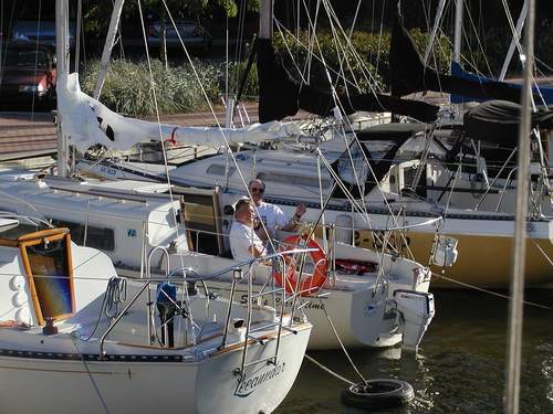

Here is a pic of stern tank
I have since lowered the tank down a bit so it is just at transom level. Looks better. I tell the rest of our racing fleet that it is our secret turbo boost for light wind conditions.

Looks good Jim
Jim: Your photo looks good, and I'll bet now lower down looks even better - but (just to be a picky jerk) you should provide a weather-cover for the tank (ABYC prohibits 'exposure to weather'). Glad to hear your fitter installed Solenoid Valve in SEALED locker. :) Regards, Gord
