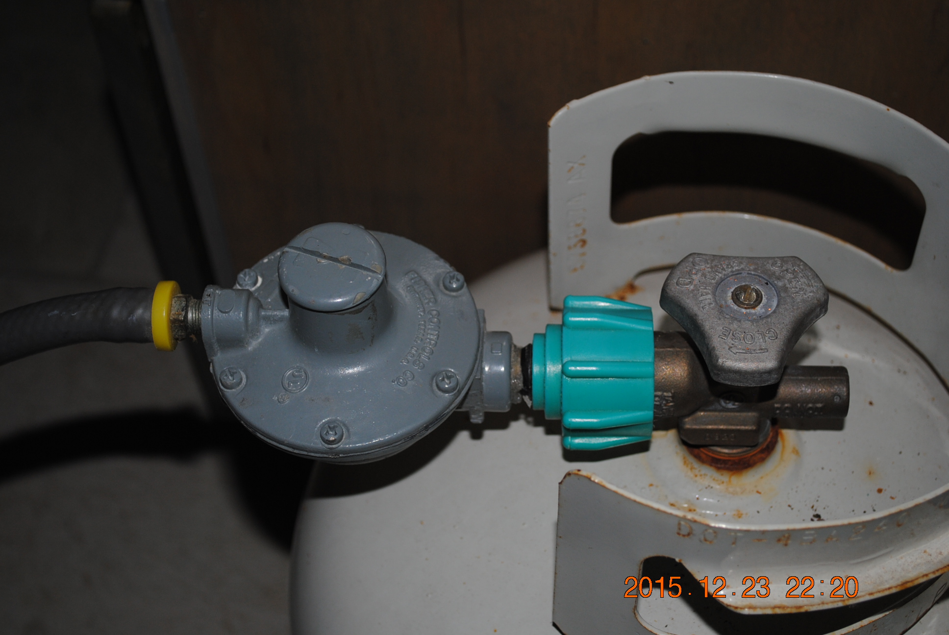

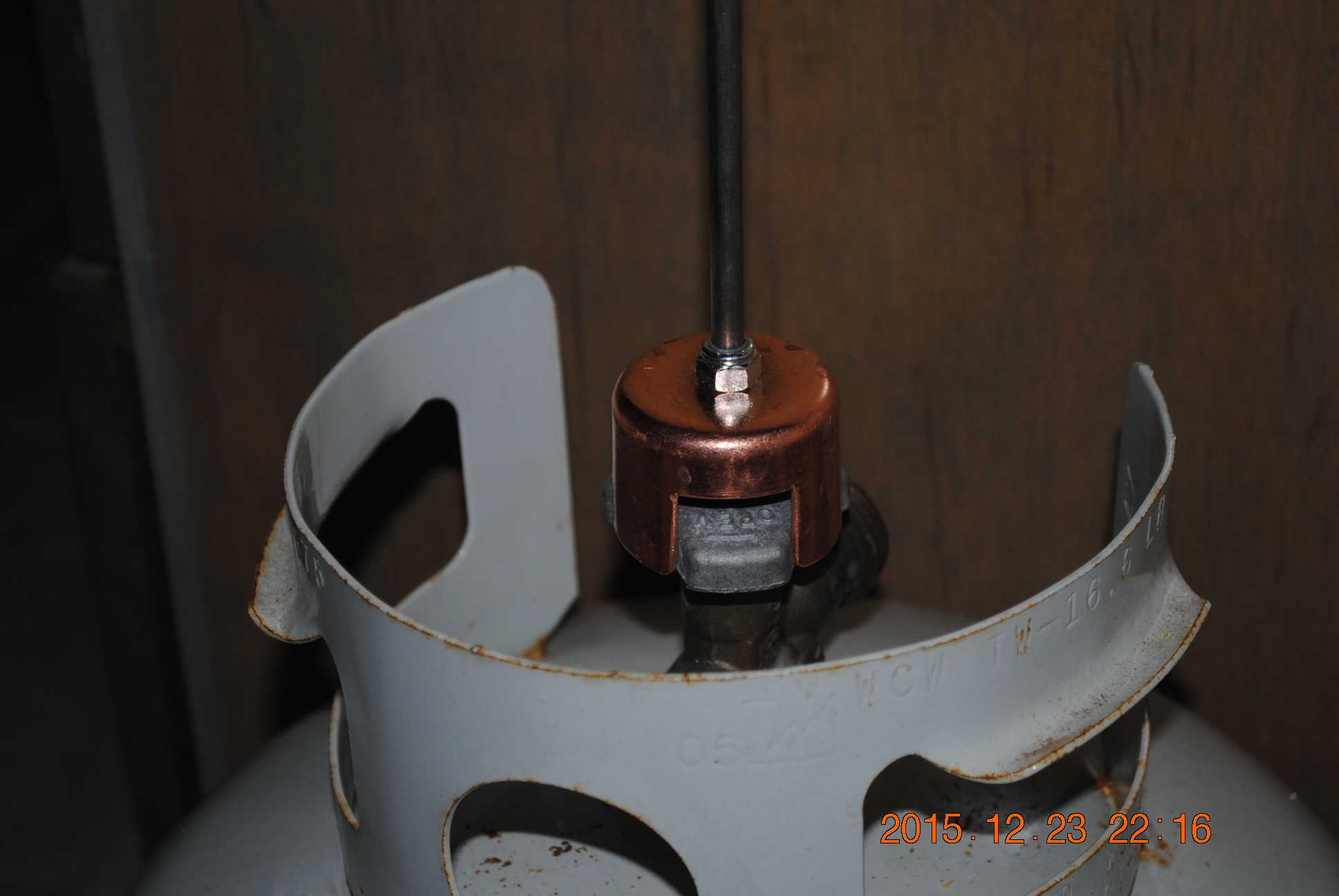

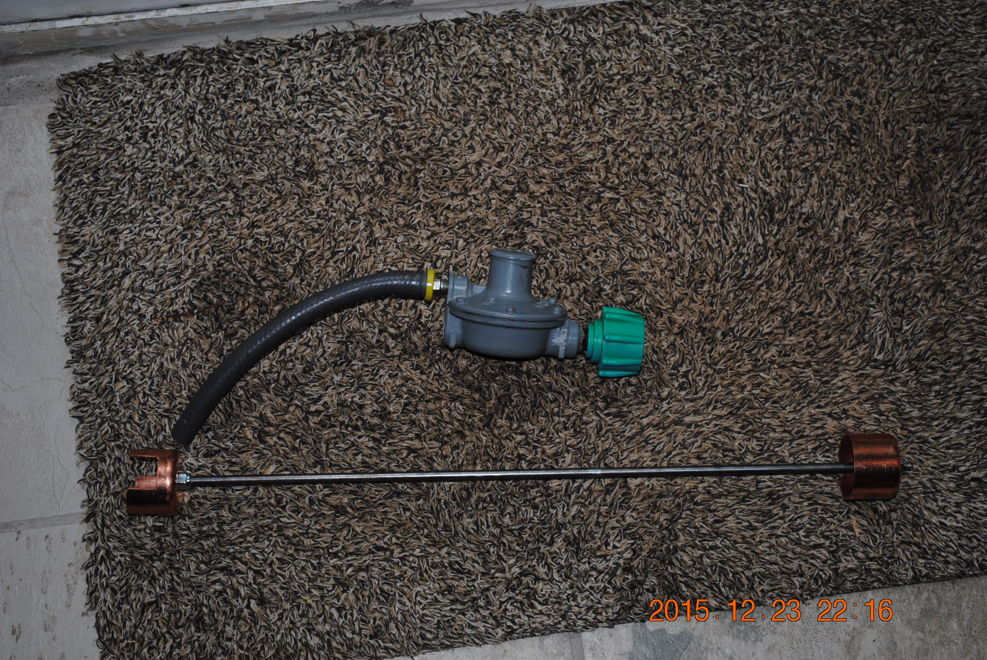

If you are not going to use the CNG parts you already have a regulator. The CNG regulator is actually two regulators, a 3000psi to 300psi and a 300 to 2-3 psi one. The gray one that is larger is the one you want. The center post has a plastic flat blade screwdriver slotted plug that once off allows access to the pressure regulator screw. I use mine with no changes. Did not have to re-jet my stove either!!! I chose to put my tank on the stern so did not need an enclosure. Also made an extension handle for the tank valve to avoid the solenoid valve.
