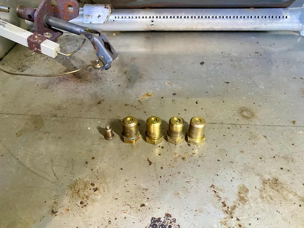

I converted my stove from CNG to LPG a few weeks ago, Dan. The stove is an old Tasco but in perfect condition. Tasco no longer exists but the stoves gas pieces are pretty generic. This stove is pre- thermo couple burner, except for the oven.
I found the parts to convert on a Seaward dealer's website. All I needed is here - photo are the CNG orifices:
3 LPG orifices for the top burners(these simply bolt onto the burner valves).
1 LPG orifice for the oven burner (larger hole for larger burner).
1 LPG oven pilot orifice (you have to remove the flare joint to get at that - photo).
That's it for the stove conversion. Once installed, I connected a test LPG tank , regulator, and hose and tested it. It works great, it looks hotter and all three burners and oven going worked fine.

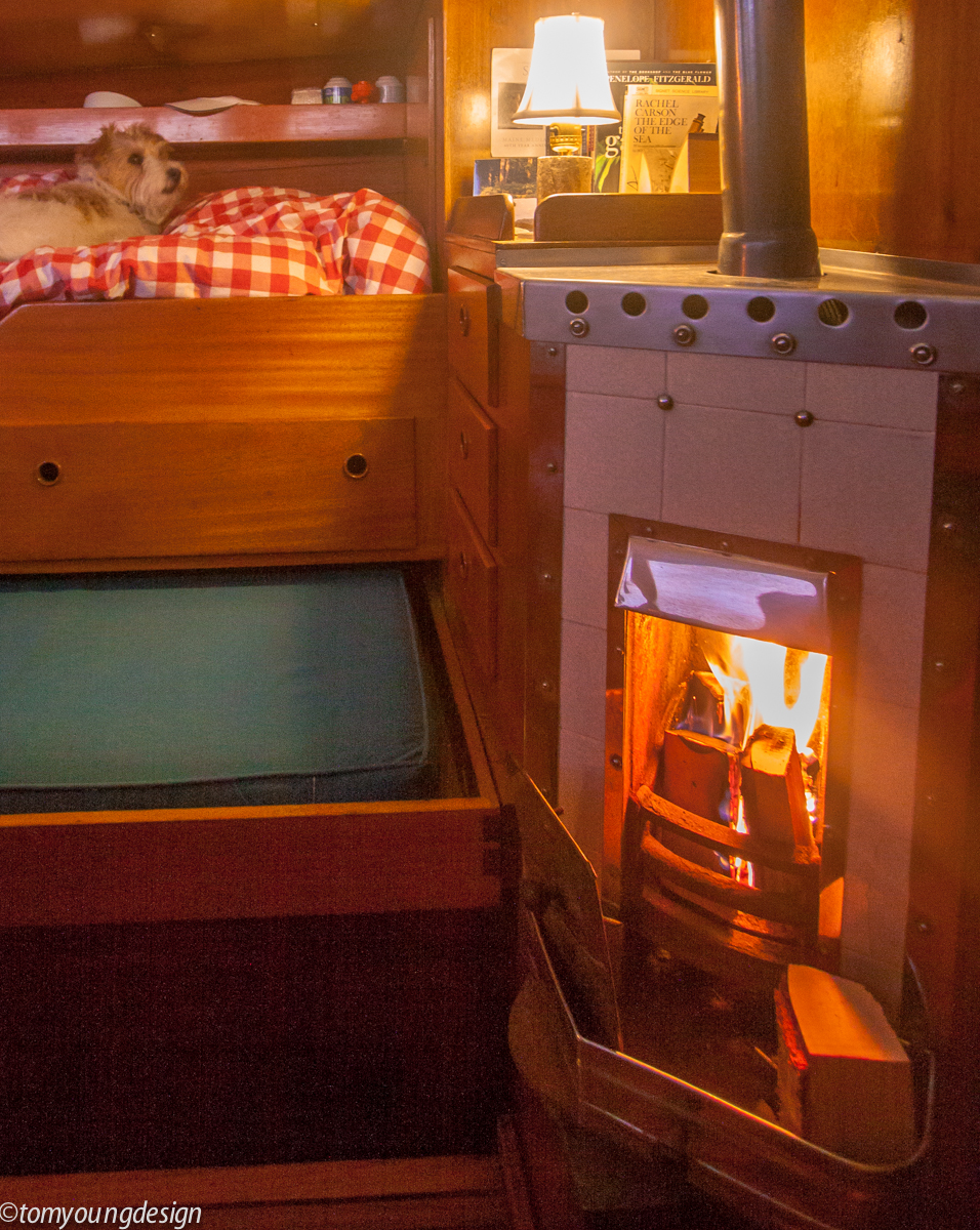

ABYC doesn't allow fireplaces, but mine passes with flying colors, everytime.
