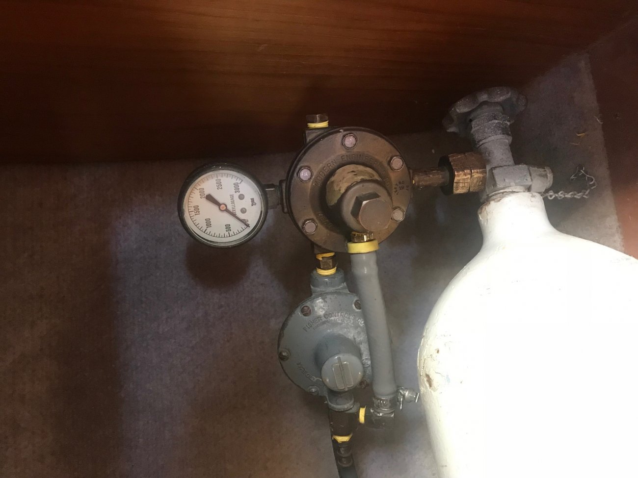

A picture is worth a thousand words. I think that it is the brass piece that is leaking. All the yellow is new gas tape that I installed last night. Can you see any other obvious reasons for failure?

Yes I had leaks also, mix some dish soap and water and spray it with a spray bottle all over the regulator and the fittings. The leaks will bubble and you will be able to see what is leaking. That is one way to know where they are coming from. I doubt its the fitting to the tank.
Steve

From the picture it looks like your discharge line is connected to the low pressure supply line past the low pressure regulator. Its a safety overpressure relief. Mine goes out through a through hull above the waterline.
