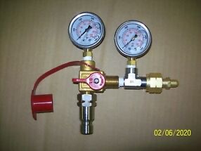

I am sure @NC Brew will answer but we need to know a little bit about your fill device. I'll send you a picture of my fill device later today. There is one difference between my setup and NC Brew's. I have a valve to throttle the rate at which I pressurize my tank that is between the "on-off" valve (the one with the red handle) and the gauge that reads the tank pressure (the one on the right in the picture.) I have a few recommendations to make it feel safer and actually, IMHO make it be safer and easier. All your fittings and gauges in your fill apparatus should be pressure rated to at least 3500 psig or more and it would be good have a way to fine control the fill rate.
The pressure delivered by the pumps is either 3000 psig or 3400 psig but your tank is probably rated at only 2000 or 2400 psig or so. Certainly not 3400 psig. Your tank should have been pressure tested within the last 5 years. This will be required if you tank is filled by someone else. You should be able to get this done at a scuba shop for about $80 or so. (at least down here.)
When you open the fill valve at the pump, since you have such a small tank, the pressure will rise VERY FAST if you don't control it and the tank will heat up and could easily over-pressurize your tank! This is not meant to scare you but to just provide you with a caution. I have installed a high pressure rated "needle valve" to act as a throttle valve. You should have a gauge that reads tank pressure downstream of the fill valve. I use the throttle valve to slowly fill the tank at a pressure I can control so the tank doesn't heat up and I can raise the pressure to the desired level without fear of over-pressurizing the tank.
