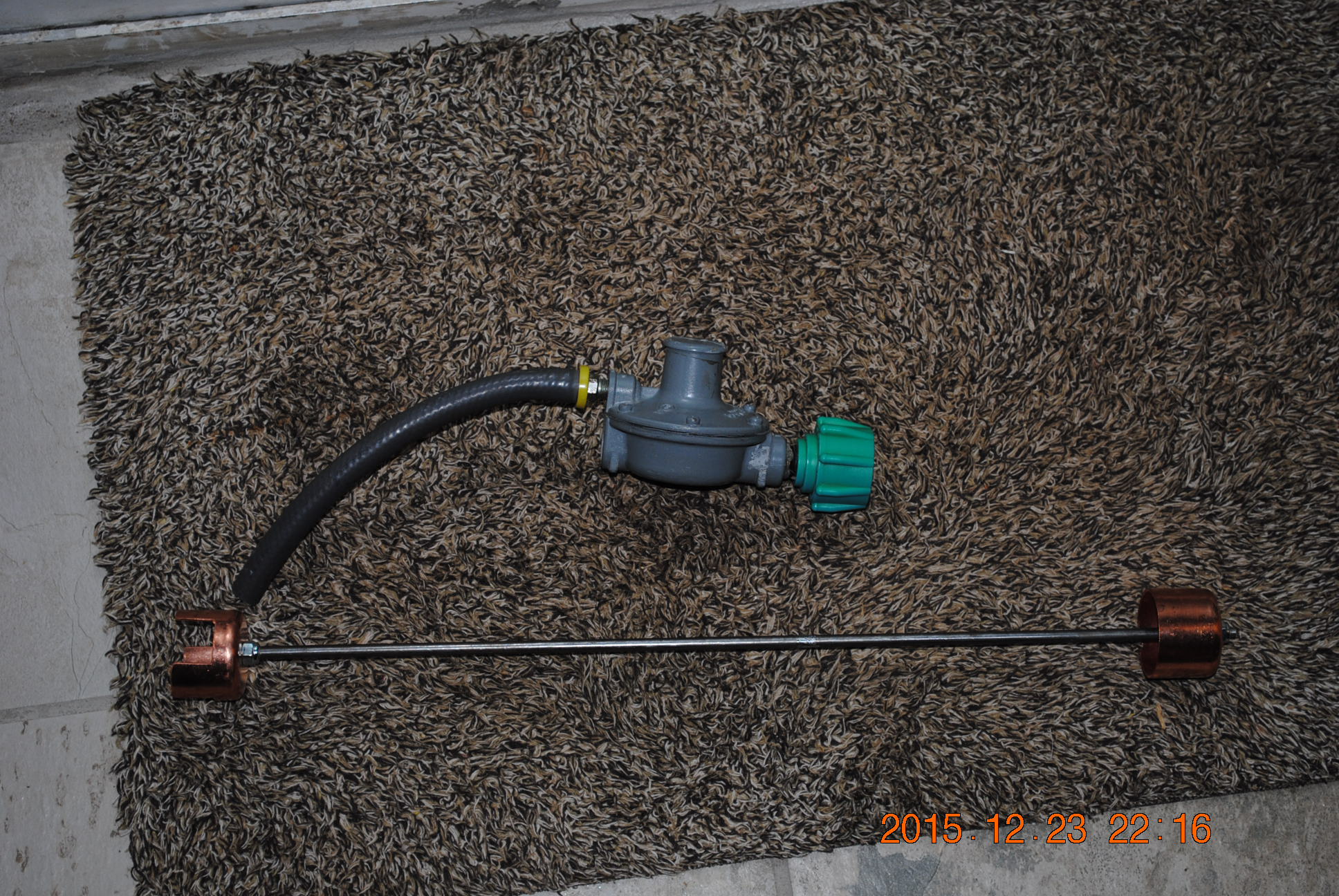

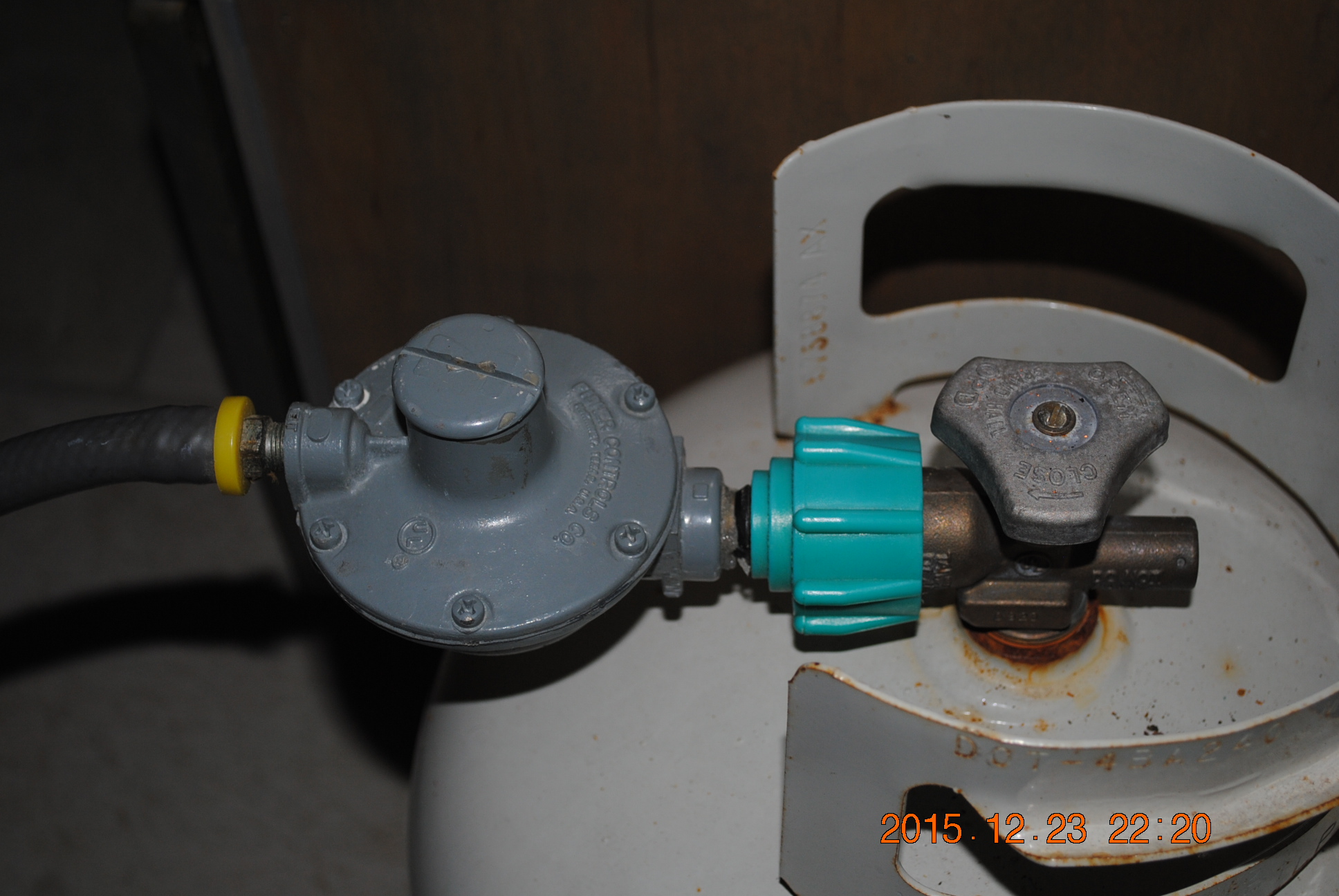

Here are some pictures
The regulator you want to re-use is the larger gray one. The rubber hose is the gas over pressure vent. The supply hose to the stove goes in the hole below the vent hose.

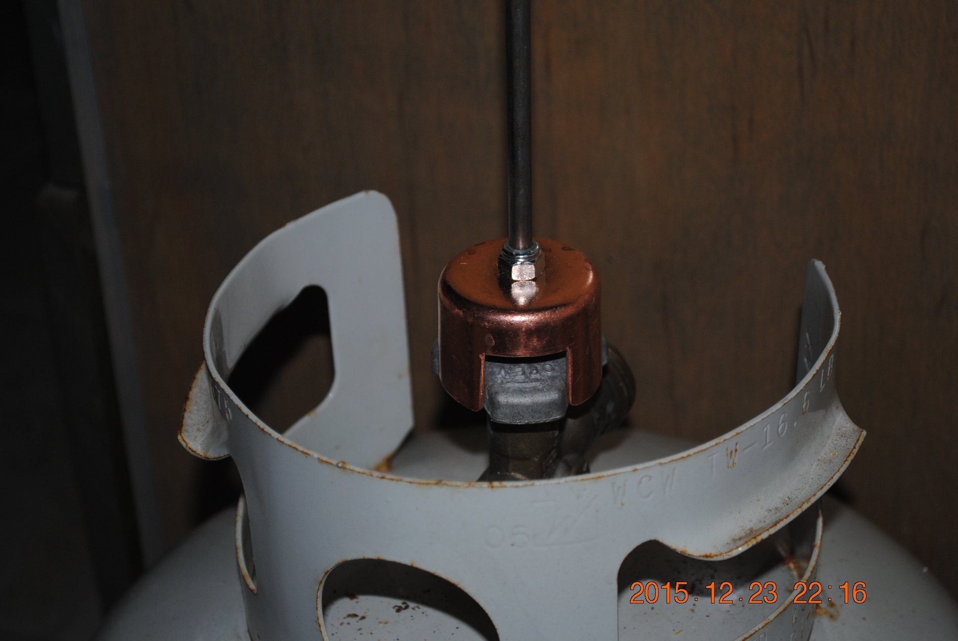

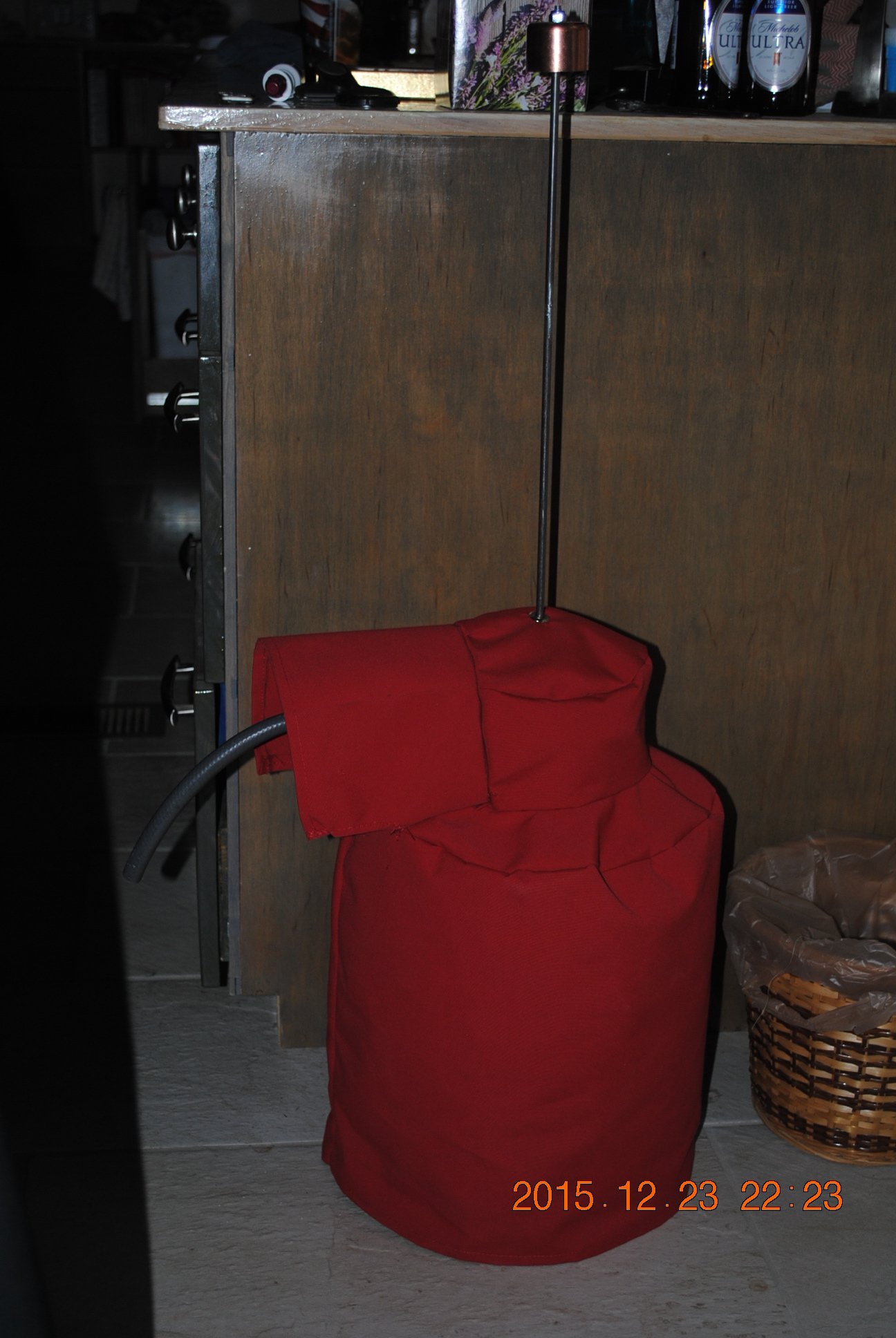

Just add a propane hand nut to attach it to the bottle. Avalable at Home Depot. The steel rod with copper end caps is the valve handle extender so you don't have to lean way over the stern rail to turn the gas on and off. And the tank cover to keep things dry.
