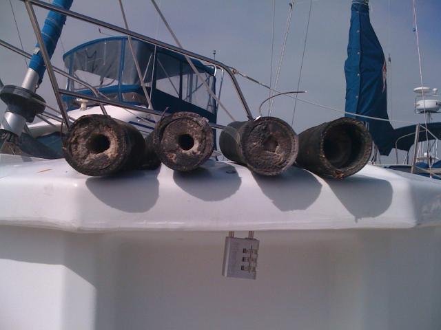

Only two reasons to replace sanitation hoses: 1. They stink. 2. They're so old that they've become hard and brittle and are starting to crack.Does anyone have any suggestions on replacing the discharge line from the head to the holding tank on my Hunter Legend 37.5. It has greatly restricted flow from chemical buildup in the line. -ken
