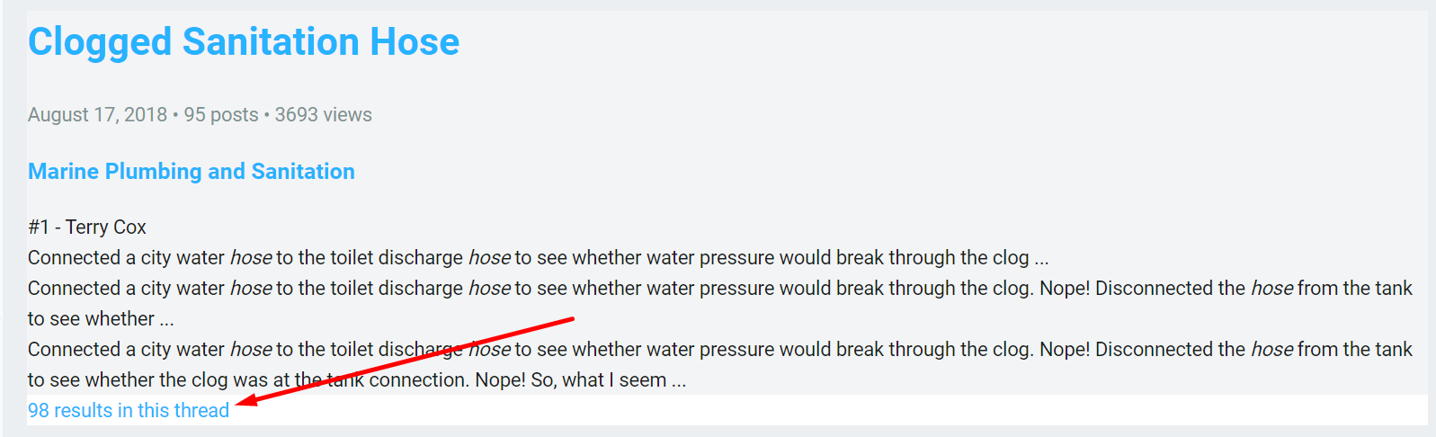

Hunter 45 Deck Salon Cumming, Ga
Anyone know how to get to these 98 results. Thread doesn't open and main description goes no where
WHY ? ? ? ? What could you possibly be looking for ? ? ?
You've already been given the only possible solution to your problem, several times over. Your hose is old, it's heavily scaled. Even if you do manage to get the scale out, the hose has already been permeated. You're not going to find an epiphany in the broken link.

All of my options. Do you know how to get to these 98 results
If you don't want an old leaking smelly hose, then there is one and only one viable option, replace the hose.

All of my options.
Damn, you're honest to a fault :thumbup:. Here's the original post from @Terry Cox back in 2018.
You won't get any better suggestions from that posting than you're already seen above in today's postings. If you do go the cheap route and it falls flat ........... remember, I told you so ! ! ! !
