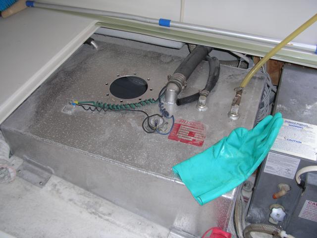

I cut an access port into my fuel tank and cleaned it out, removed the pickup tube screen, new fuel lines (my 25 year old lines were pretty brittle), and am cautious with using clean fuel and a biocide. (I've used BiorborJF with good results for about 7 years so far).
In these pictures you can see my very low tech inspection port. I just used a four inch hole saw to cut the hole. No matter how much I cleaned and vaccumed that tank out though I still had a couple of shavings in my Racor filter on the next filter change. Be very careful with you shavings!
Oh, and don't forget that if you have the Facet electric fuel pump there is a screen that needs to be cleaned in there, and it's not a really obvious screen, you have to look for it a bit.
Also, I stuffed my camera in there to get a good look in the lowest corner of the tank and that is what the other picture is. You can see the pitting in the walls of the tank where water had sat for years I'm sure. This is where the pinhole leaks are probably going to start at some point like so many owners have had to deal with on the older boats.
