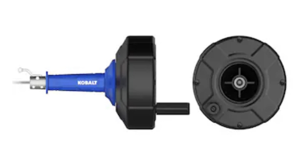

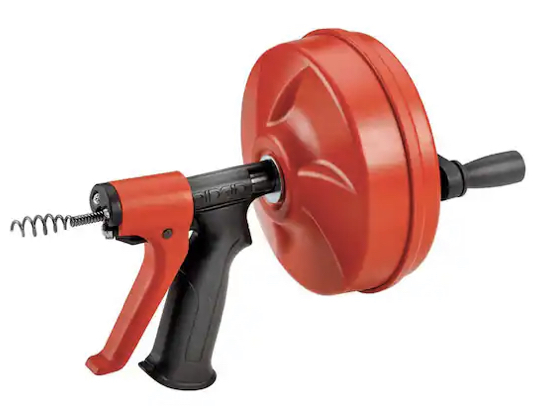

12,958
Might a drain snake/router used from underneath work? These are only $20 at lowes
