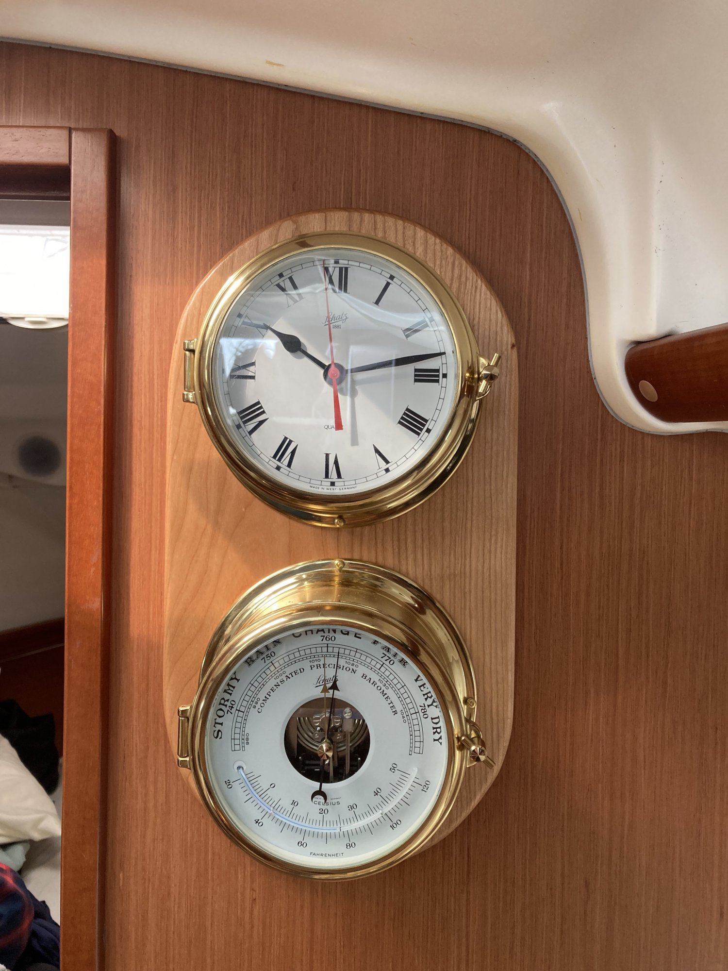

So much good advice - thanks everyone! I've gone with 1/2" cherry mount so only 2 screws required. The cherry is lighter than the bulkhead veneer, so I think it contrasts/compliments well.

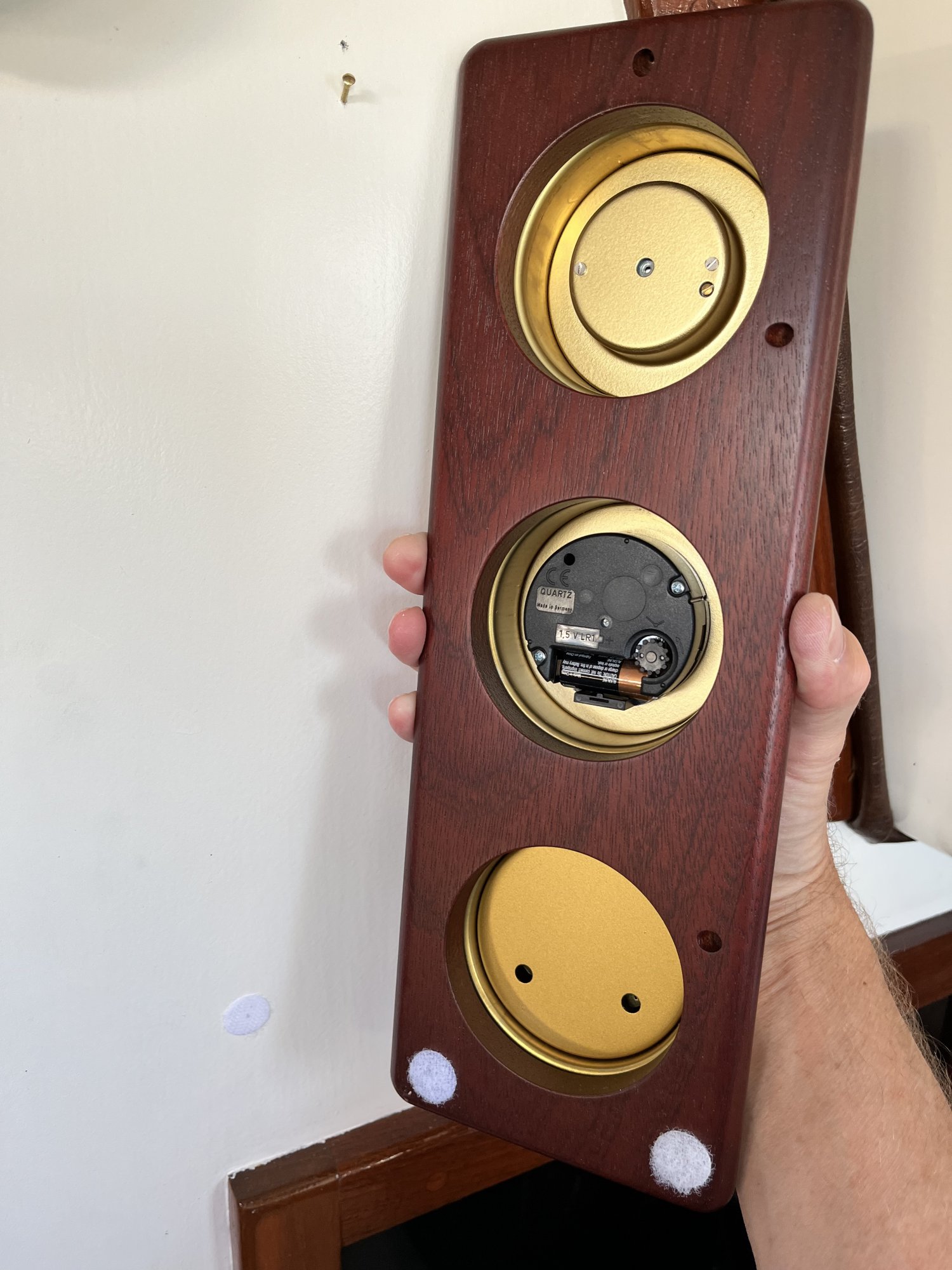

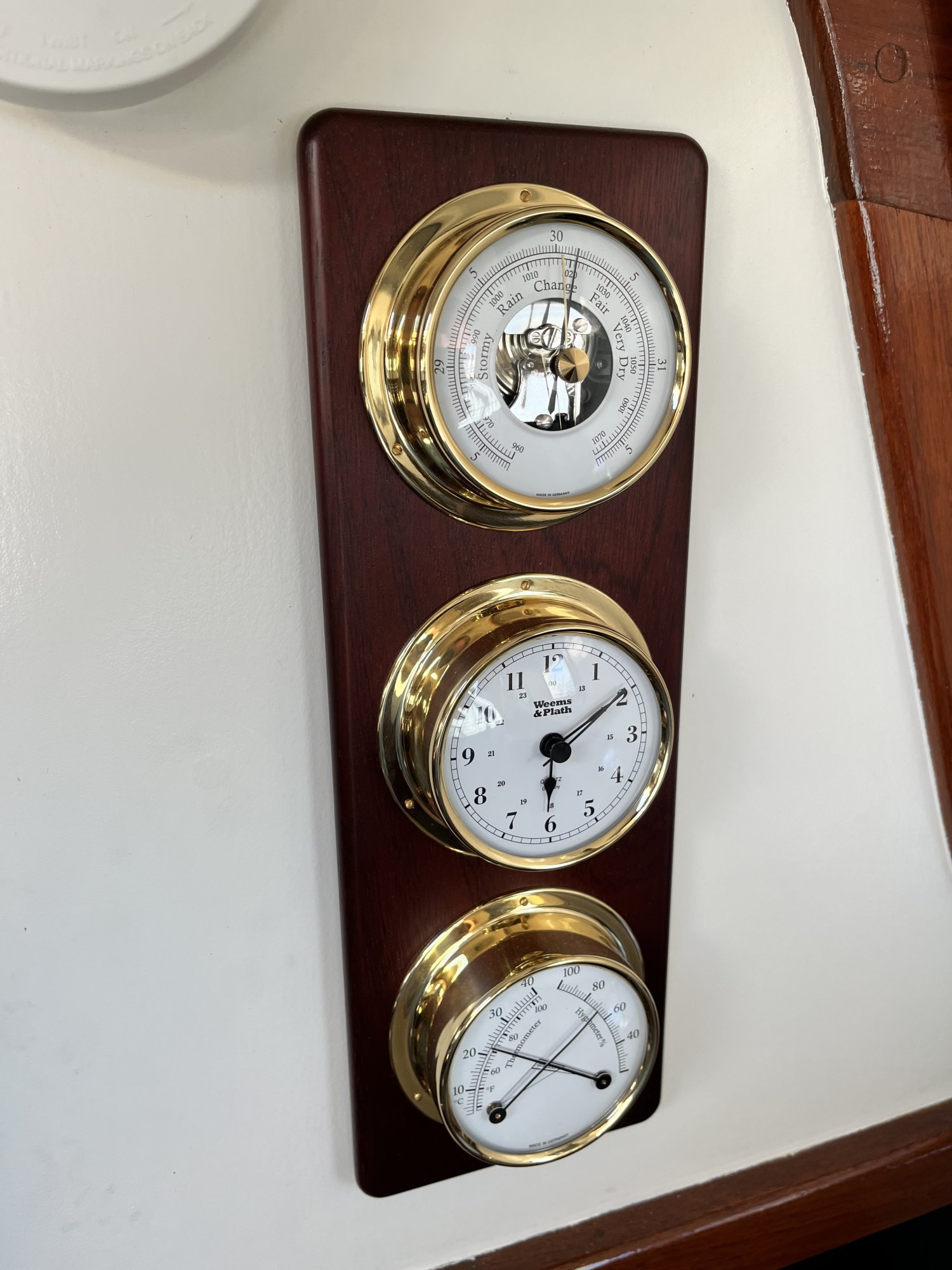

Mine are mounted on a piece of solid mahogany with a single angled hole in the back at the top. It hangs on a single concealed nail in the bulkhead and a pair of peel & stick Velcro tabs at the bottom keep it from swinging.
Use a hole saw to provide easy access to the back of the clock & barometer for adjustment and battery changes rather than having to take them off your back panel.
