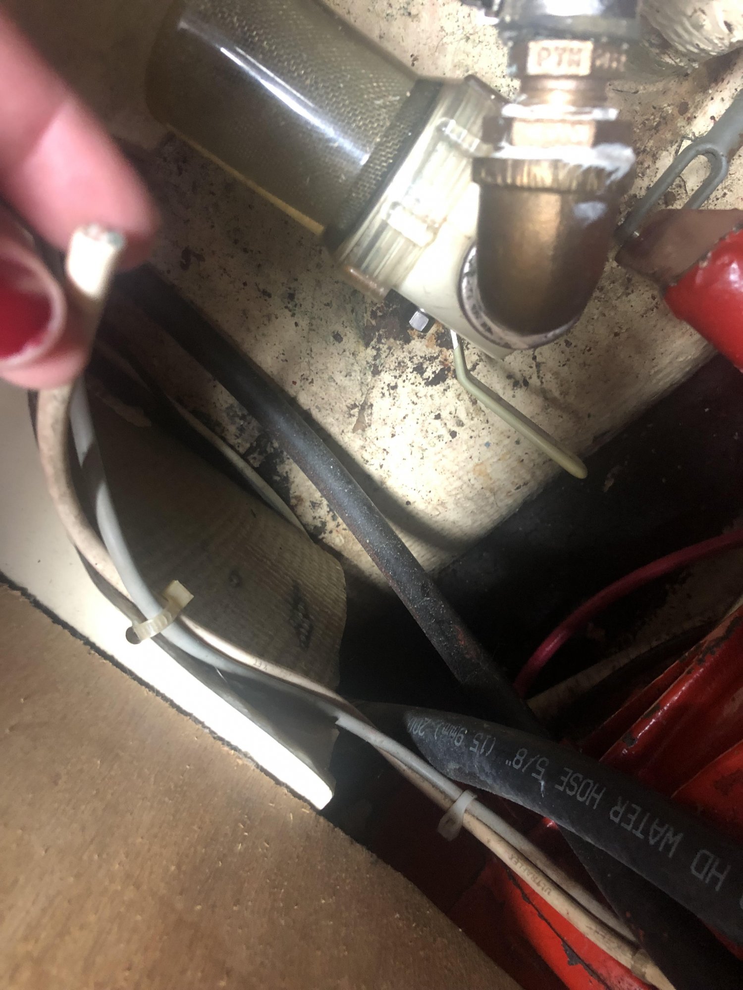

Image 0874 shows vhf antenna input that will fit a PL-259 connector. Don't have a clue as to what 0872 plug is. As JoeWhite mentioned, it appears to be an audio plug; perhaps for an onboard stereo / CD player. Going to have to trace the grey wire and see where it leads to. Also, look under mast inside cabin and you will likely find the coax cable for the vhf antenna that traverses the inside of the mast.

If you know where the original VHF was installed, look all around for the coax cable that connects to your new radio…
Should look like one of these provided by @jssailem :
Looks like you already have power connection there in your photo.
It is hard to believe that the audio plug in your photo was somehow connected to your old radio as an antenna… if it was, looks like you have some extra work to do. But hopefully you can find the coax cable, hook it up and have a working VHF radio.

If you would like to send me a PM I will give you my phone number and I would certainly talk with you about what you have. I am a retired and licensed professional and I would be happy to give you advice or suggestions to resolve this. I just hate to see you throw away a bunch of time and money based on assumptions.
It looks like you have a speaker connector that you're thinking goes to the antenna. That is not the case That looks like a quarter inch phone plug in the picture. You are looking for a black or white cable that is relatively stiff compared to the one in your picture and a connector that mates with the back of the VHF radio. I'm guessing that the end of the cable has just fallen out of your view.

My guess is that that plug is to plug in some audio speakers.
You would find out easy enough by tracing it back.

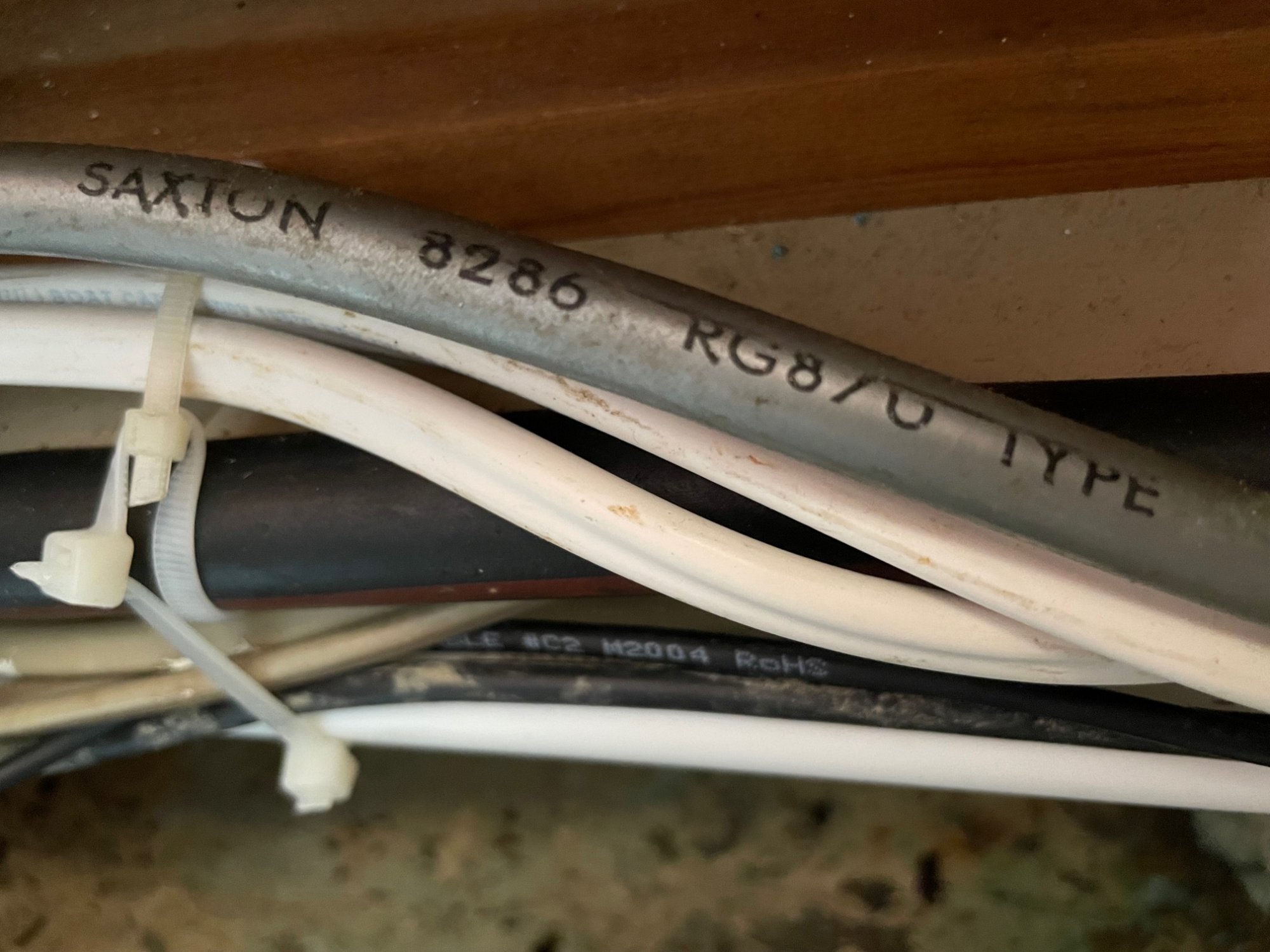

Hello! My wife and I live on a 1979 Cal 34 and I replaced the VHF with a Standard-Horizon a few years ago when I bought the boat. My co-ax radio wire headed to the mast is silver, about ⅜", marked RG-8 (the wire type). You may need to dig around to check for it, but there should be something fairly close to the mast compression post. Mine exits to the port storage space, just at the front of the main cabin.I seem to remember that I didn't need any adapter to the new radio (although that doesn't mean someone hadn't already put on a newer cable connector.
And don't get hung up on the "old salts" telling you to look for a white or black wire. Mine is SILVER, and in areas where it's been getting dirty, it looks more grey.
