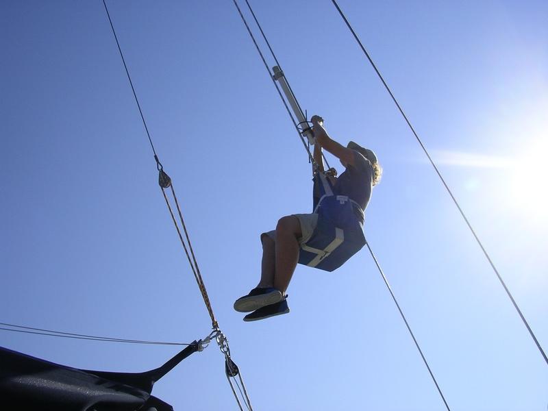

All U Get
looks like they already have ..from your pic posted looks like you subbed out the job:D
