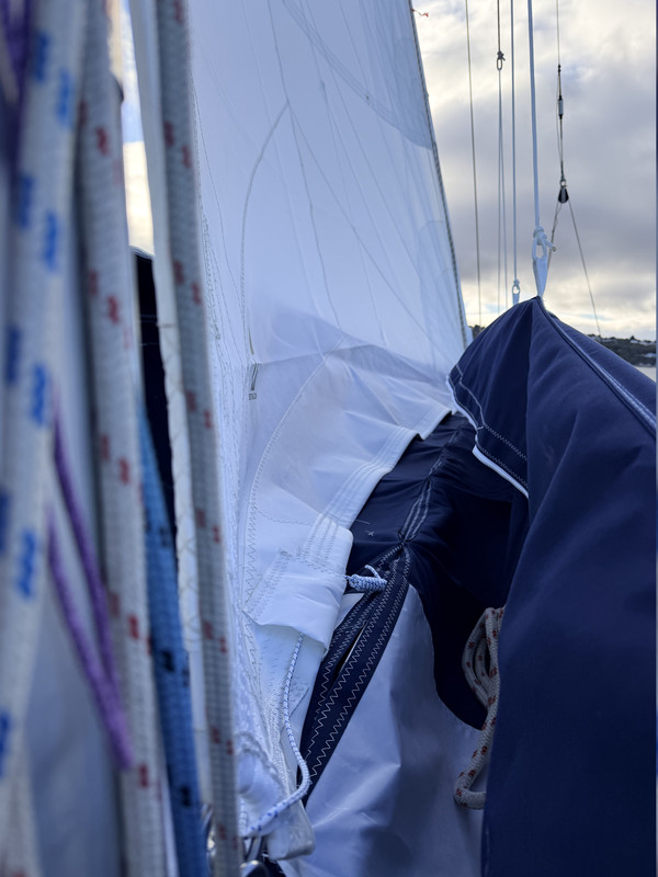

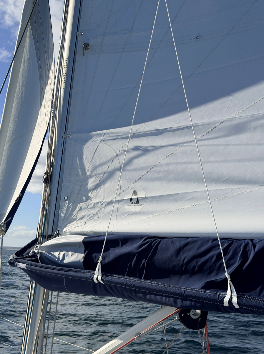

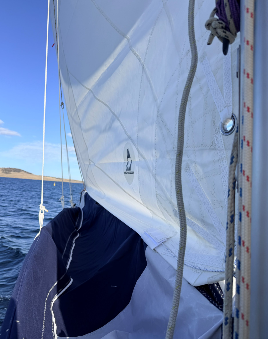

Just installed my new mainsail ordered from direct-sails, hoisted the sail and that's how the footer showed up.
What's your opinion about the foot of the sail? The outhaul is at its maximum (hit the stopper).
I have sent an email to Richard and his assistant and so far I haven't heard back.
Checked the website and it says it the sail doesn't fit they will make a new one.
It is difficult to tell from this photo because of the sail cover is interfering with the sail.
Is this a loose footed sail? If so, it is normal for the foot of the sail to curve away from the boom leaving a gap between the sail and the boom. With the canvas in the way, it is impossible to tell if this is within normal parameters.
I hope they do respond and rebuild or replace it. Good luck!

I will hoist the sail and remove the sailpack to make sure it's not interfering with the loose foot shape. My old sail wasn't showing this shape.

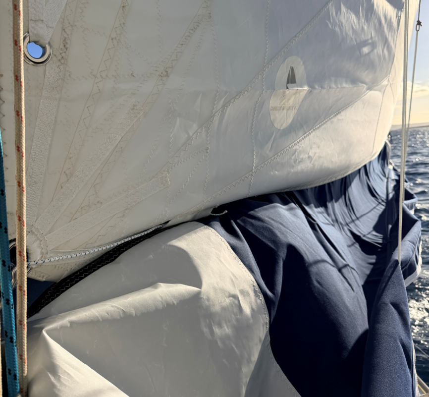

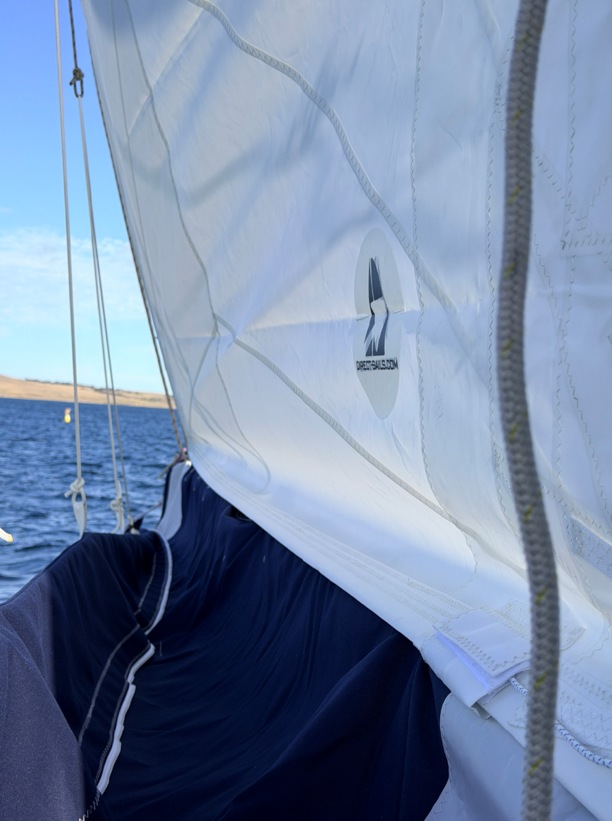

Send some photos from different angles and of the clew and outhaul.
Likes: OzzySailor
13,998
Thanks for the photos.

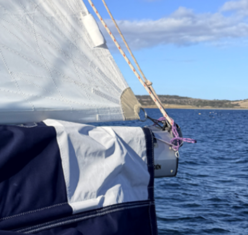

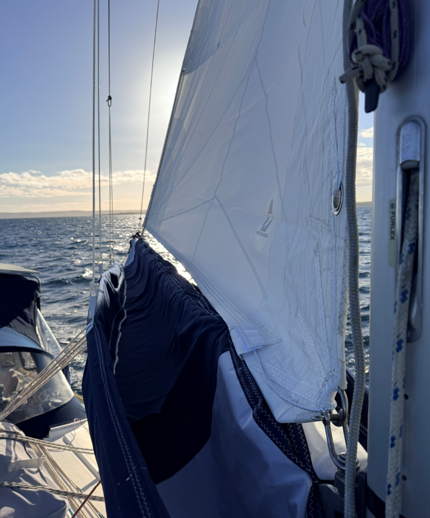

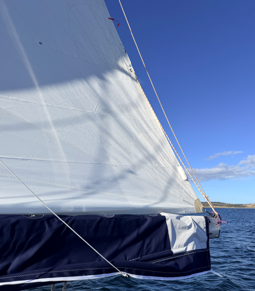

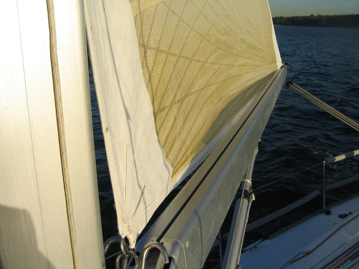

The biggest issue is the stack pack is interfering with the foot of the sail. It is not allowing the foot to fall naturally below the top of the boom. This causes it to bunch up like you see on your sail. Here's a photo of a loose footed sail, notice at the midpoint the foot is an couple of inches below the top of the boom.
Next, the clew is not being restrained and held closer to the boom. See the photo below. There are different ways of holding the clew down, in this phot it appears there is a heavy duty velcro strap through the clew. Without the strap the clew rises a bit which affects sail shape especially in the lower half where most of the power is developed. The outhaul car is also important as it helps to hold the foot down.

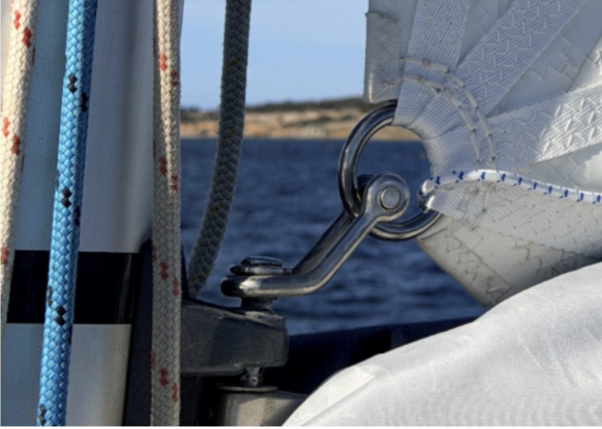

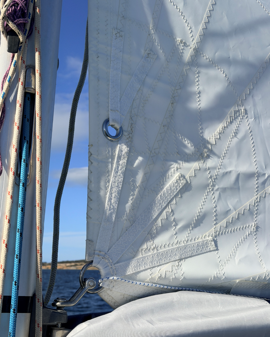

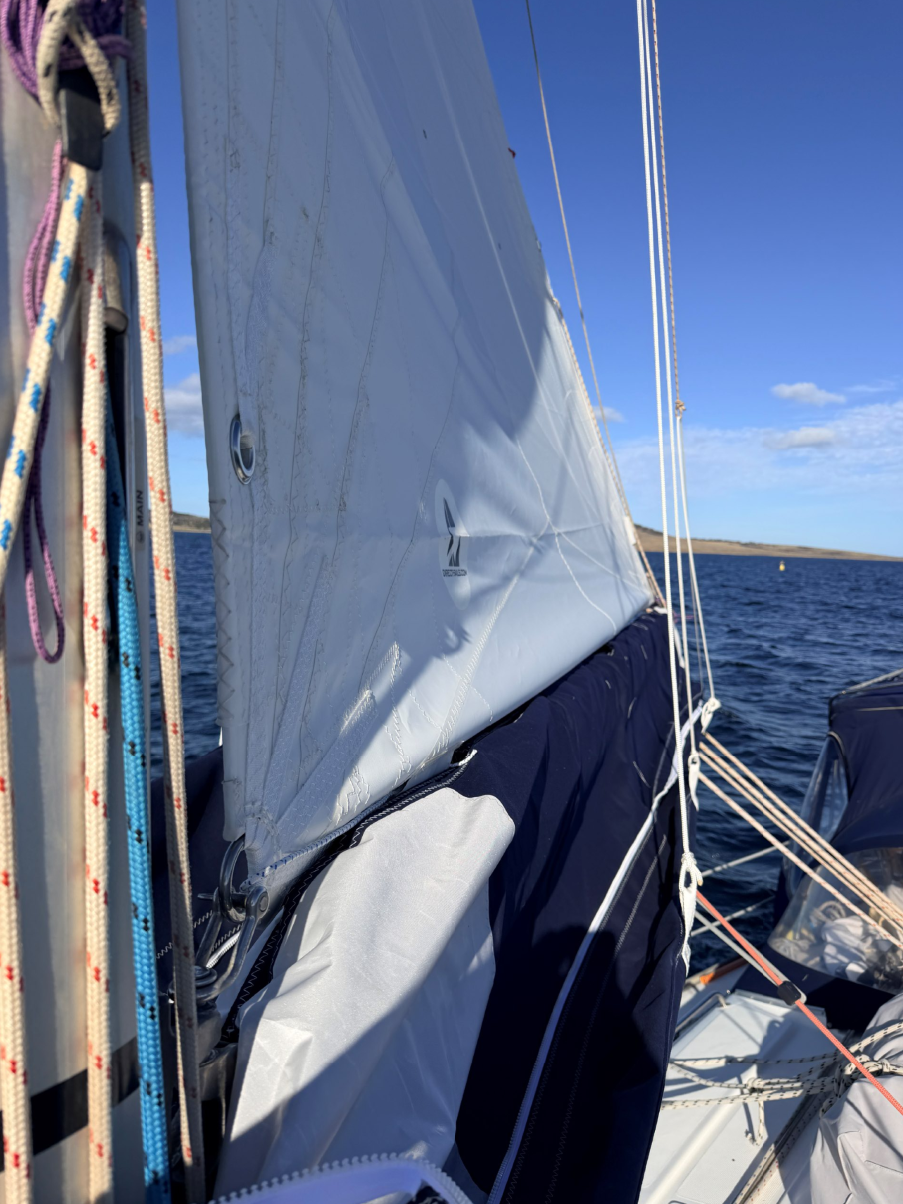

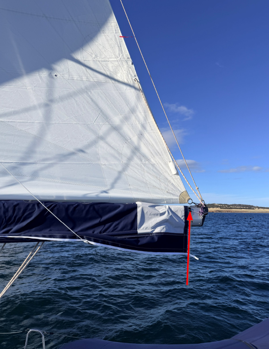

The tack in relation to the boom does look to be too high. There appears to be a fairly large gap in the gooseneck fitting and the shackle raises the tack even higher. I don't know whether this was someone's better idea or if this is normal for Bavarias, or if something in the gooseneck fitting is not adjusted correctly.

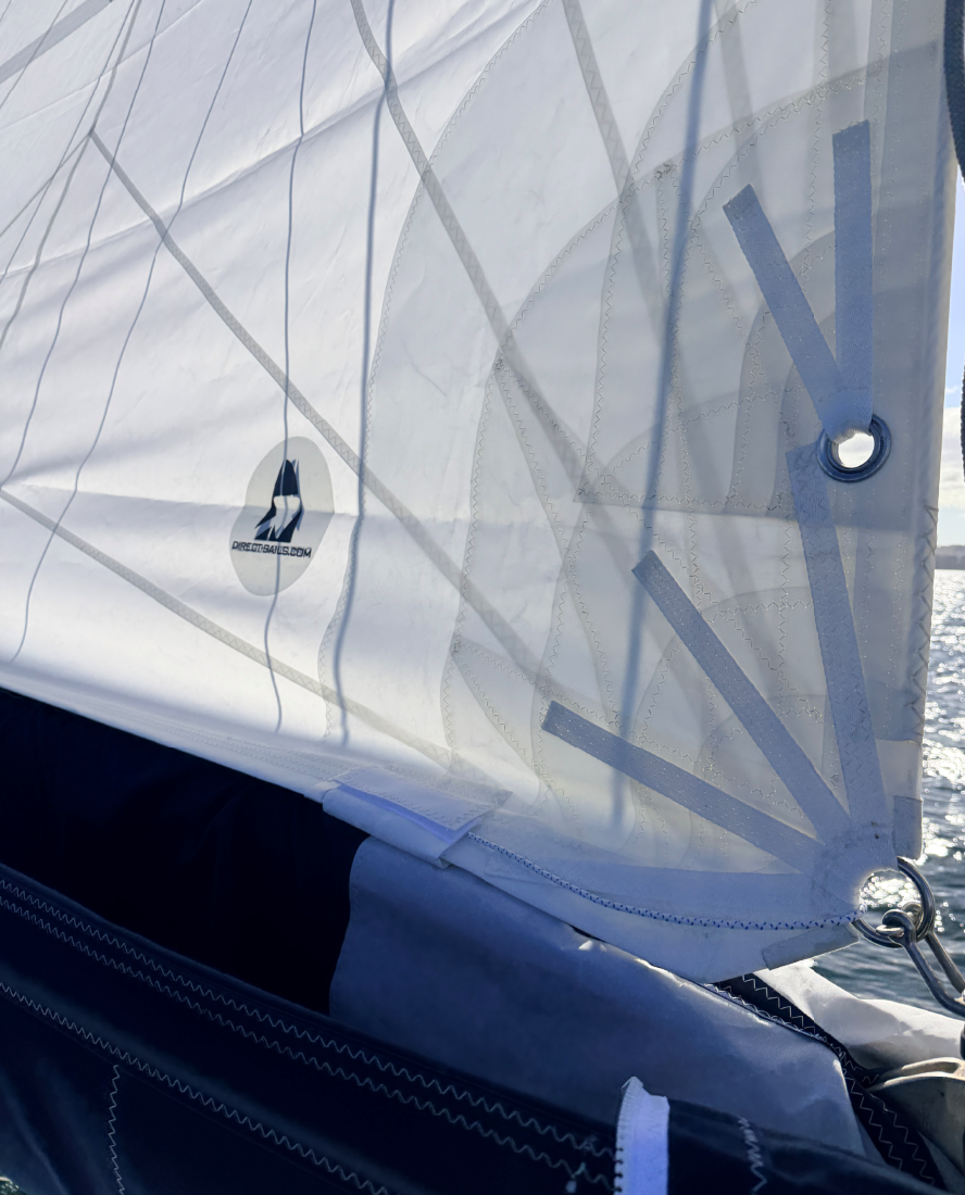

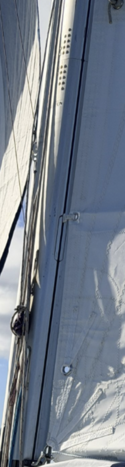

Look at the luff and the gap between the luff and the mast. Above the first slug the gap is straight and narrow, the sail is close to the mast. Below the first slug the sail angles away from the mast, the gap gets larger, this seems unusual and may add to some of the bagginess at the foot. Again, I don't know if this is unique to a Bavaria or if something is amiss with the tack and gooseneck.

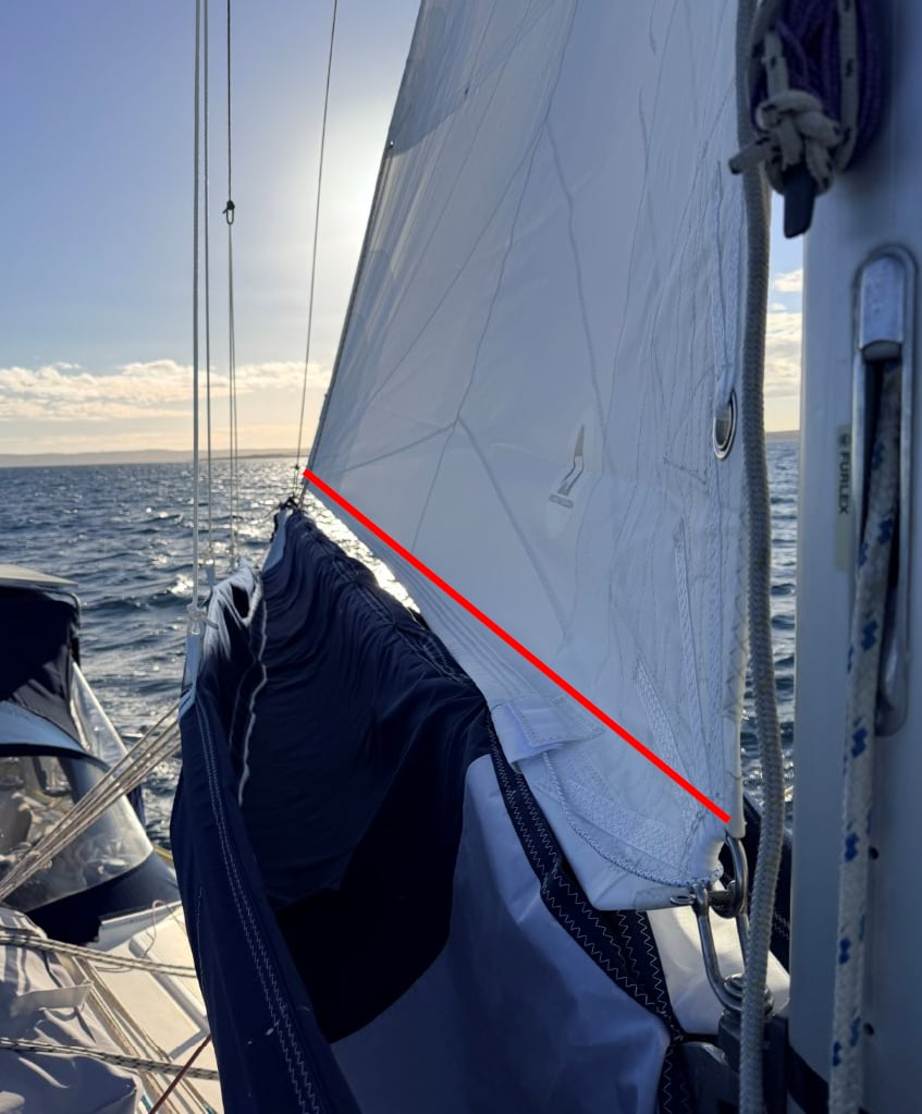

RE: Also I had to reroute the outhaul, not using the outhaul car to be able to put a bit of tension in the footer.
To me it looks like the foot is too long. Your outhaul is pulled tight without the car and you still seem to have too much draft ( bagginess?) in the foot.
I hope that there is some simple adjustment (topping lift?) that will sort this out.

Ease the topping lift. Let the boom carry the sail alone.
This would allow the boom to drop, stretching out the Leech, giving the sail a better shape. If the leech is cut too long, the end of the boom will sag below the horizontal. It appears that the outhaul is too tight. There is a fold along the foot.
The black line on your mast suggests the bottom location of the mast. Can you lower the mast below that point? If not, check that the head of the sail is at the top of the mast. Is the Luff smooth or with a fold? The grommet (or cringle) above the tack is to allow you to use a Cunningham to increase the tension on the Main Sail luff.

cannon lower the boom below the black line. it's popped rivet. I will try the cunningham. thanks a lot.

What does the Cunningham do if the gooseneck is riveted?
Judging by the stretched folds in the photos, JS is on the right track. It is hard to say for sure, not being there to look at the whole sail, the luff tension, the foot, what is a fold from tension, what is a fold from sitting in the stack pack, how tight is the leach? Do you have a vang, your mid-boom sheeting, all of it.
-Will
Likes: OzzySailor
24,521
I understand about the boom being fixed. Some are some are not.
Your images are good but I’m not able to see the boom angle clearly. Looks to me that the stern end of your boom is riding a bit high. Suspect the cause is the tight topping lift. It looks taut in the images.
When you are sitting still, no breeze, raise the main. Ease the topping lift and see if the sail forms a right angle triangle holding the boom at near horizontal (level). If so it would suggest that the sail was properly cut as the luff and leach when extended are of proper length.
Regarding your foot, no need to slice off the bottom. It is designed to be a bit full. Like a middle aged guy who likes beer at the pub. It will stretch firm and fold slightly as you draw in the outhaul beating to windward. Mine hangs just to the lee of the boom. When you turn downwind and pickup those lovely trades you’ll ease the outhaul, and the main will fill out forming a beautiful curve. :biggrin:
