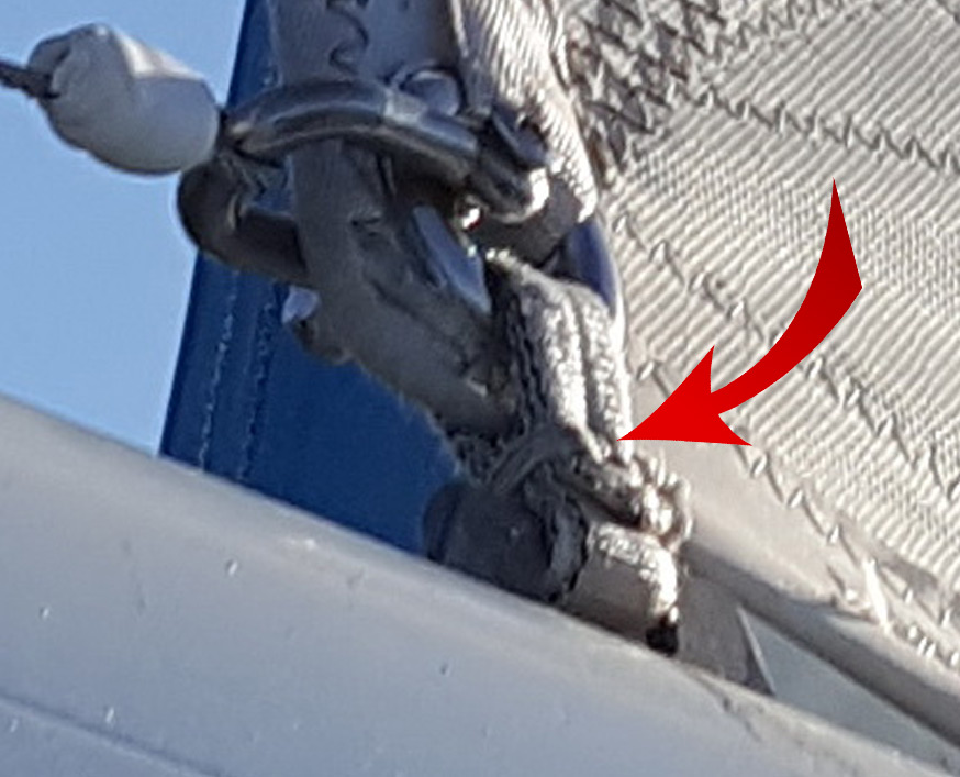

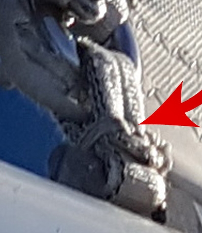

Sorry if I don't know the specific name of what I want to fix, but the strap that was lashed between the clew ring and the boom track slide on my main broke this weekend. I'd like to fix it "right" but on my own. Just wondering what the best way to do it? Some random webbing, and hand sew it together then lash it?
This is not my boat, but found a pic to show you what broke:
This is mine:

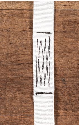

Thanks, that's what I was wondering. So, I don't have to do something like this first before going around?
I can just wrap the webbing, then go around the middle with the thread and through the center of the webbing through a single point, right?
