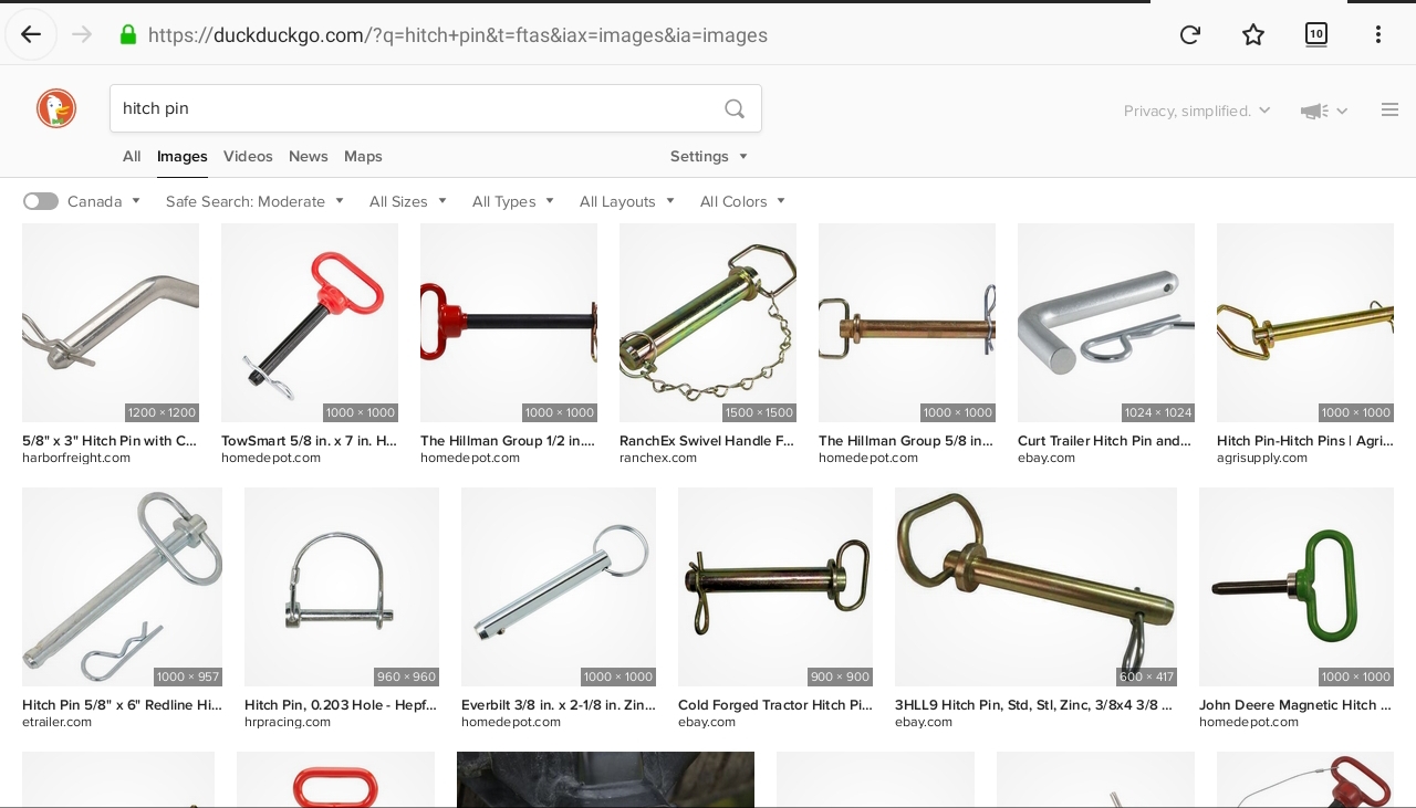

Well, Grainger and other industrial sources call them hairpin cotter pins. Here are various hitch pins, sometimes secured with a hairpin cotter:
I have used those push button pins and simply don't trust them. I have the hairpin cotters at deck level and have never snagged, kicked out or lost one.

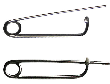

Just bought a 1973 O'Day Widgeon and I already hate the clevis pins that attach the stays. I really don't like dealing with those rings (like a key ring) that hold the pins in. I will most likely be trailering the boat quite a bit, which means fighting with them constantly. Any chance there's a quicker, easier option for those?
You could change to a split ring with tail, sometimes also called cotter ring. Much easier to insert and remove.
Something like this
Likes: Kyle Partain
Tedd
Jul 25, 2013
794
TES 246 Versus Bowser, BC
I had replaced some of mine with this kind. But then I was advised by some more experienced sailors that they weren't secure enough for standing rigging, so I switched to the kind @Hunter216 showed. They're a pain in the neck with my far-sighted eyes, but they don't come out by accident.
