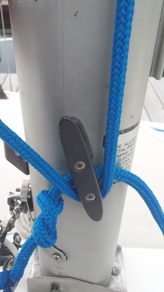

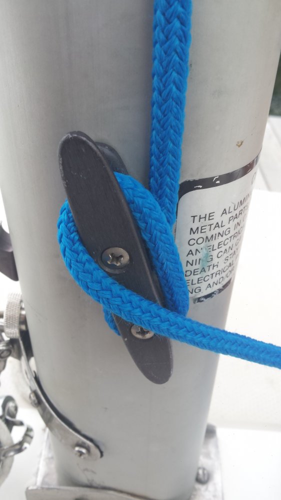

We are a little confused about cleating off the main on the mast. There seems to be two ways this could be done, but neither seems to be perfect. Both "options" are created by the fact we have the tail end of the lines running though the center of the cleat, with a stopper knot in the end.
It's a little hard to explain, but here we go:
1. Pull halyard straight down to raise the main. Then while holding some tension on the line, pull the tail end of the line. Keep pulling the tail end, working all the line though the center of the cleat. Then cleat off with the first "turn" of the cleat actually going though the center and around the bottom. This option works and makes a neat cleat, but takes some doing pulling the entire length of the tail end of the halyard with one hand.

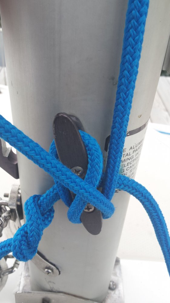

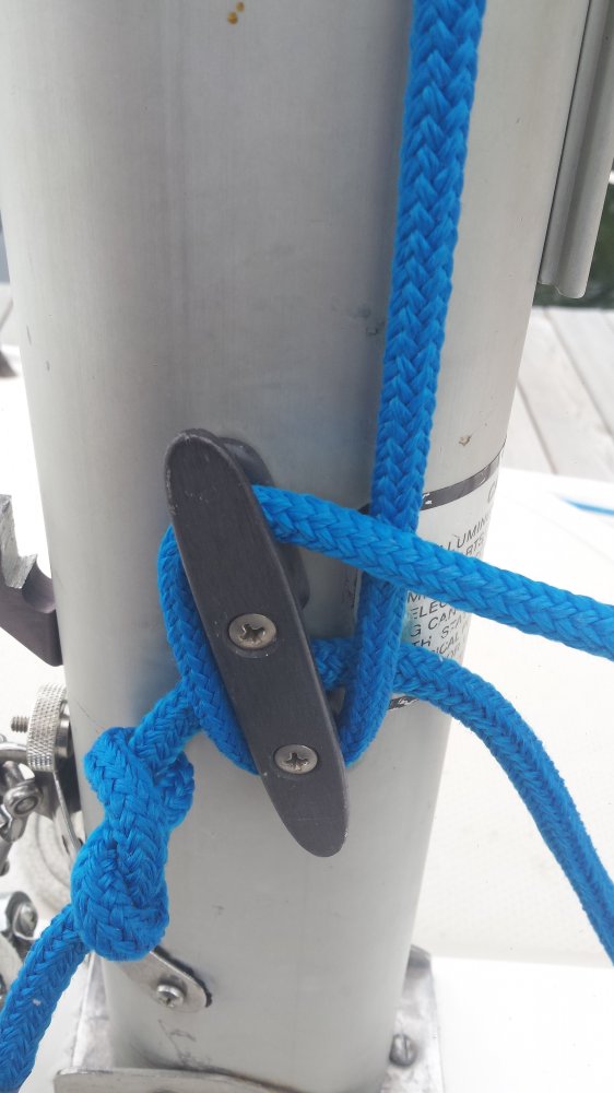

2. Pull halyard straight down to raise the main. When fully raised, put first turn urnder cleat as normal. Except you have the tail of the line under the cleat hitch. Faster, easier, uglier.

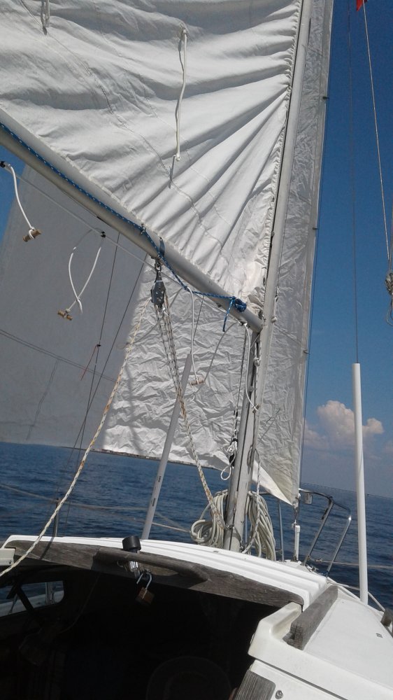

Do not run the halyards thru the cleat, and when you have sail raised just coil up halyard and use last loop through coil and over top of cleat to store. Keeps it neat and allows rapid dropping of either sail when needed. Also always keep control of bitter end to control the drop anyway. See pic for under sail appearance.
