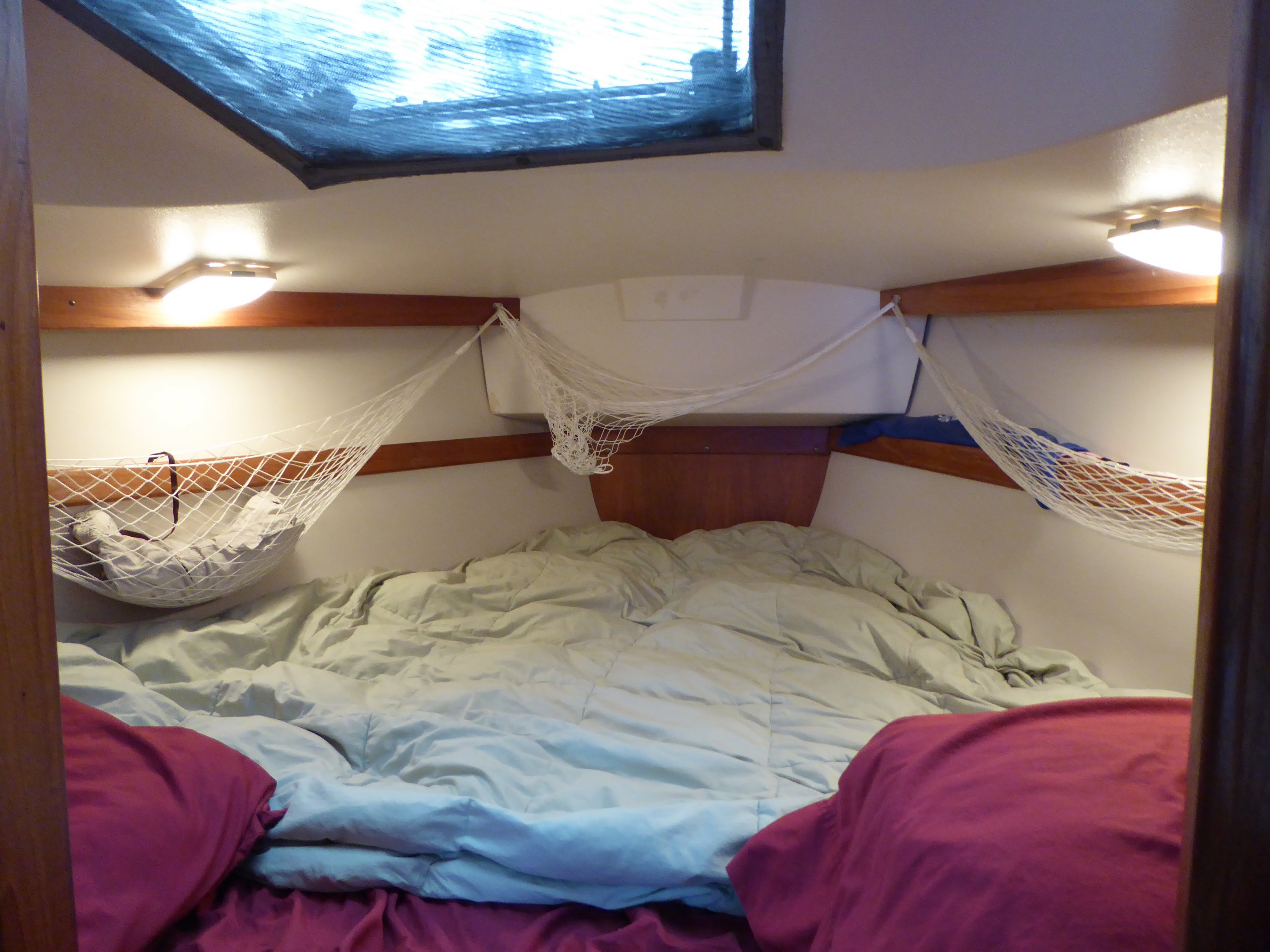

As I stated, there does appear to be a "block" in the v-berth but I have know way of knowing if it is structural.
See photo.
24,774
V berth looks cosy....

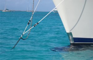

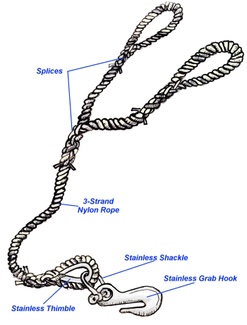

If I were to use a bridal from the two bow cleats, how would I attach the rode to the bridal?
24,774
An anchor shackle and a hook.
Here are 2 images.
Do a google search on 'anchor bridle and shackle' for more info.

You shouldn't use your anchor roller either it should be cleated to either port or starboard cleats. The strain can be too much for the roller. I used that cleat for the bitter end, just in case! I also had a small length of nylon with a chain hook to secure the anchor while in the roller. I cleated that off to the cleat in the locker. gunni is correct
Bob S
Sep 27, 2007
1,815
Beneteau 393 New Bedford, MA
John,
That works fine depending on how much chain he carries. Also, I'm not a fan of that style chain hook. I used it for years but i did have it come unhooked during a squal at 2:00am in the morning. I was lucky because I had also brought back some nylon to the opposite side so it didn't pay out. I have a Mantis chain hook now. It won't disengage.

Bob we are in agreement about the anchor hook (just happened to be the first image that showed the parts of a bridal). I tend on the conservative side and use a Crosby anchor shackle. More time involved in set up and take down, but as I have aged the time spent to be sure is an investment. I sleep more peacefully.
24,774
Not a problem. You can tie a series of rolling hitches to the rode from the bridle.
Check out the various knots online to identify one you like.
Will the size of your rode allow you to tie off to one of your bow cleats?
If so then you just need a 5 to 10 foot length of of nylon rode (similar in size to your anchor rode) to set up the second leg of the bridle.
Let out and set your anchor.
Then tie the second leg of the bridle to the rode on your boat. Tie the second leg to a bow cleat being sure the line runs from the cleat to the spot on the rode out in front of the boat and under any lines (like life lines). Then let your anchor rode till the two lengths of the bridle are about equal. Tie off the anchor rode to the other bow cleat.
You have a bridle set.
Just reverse the procedure to bring the anchor back in.
