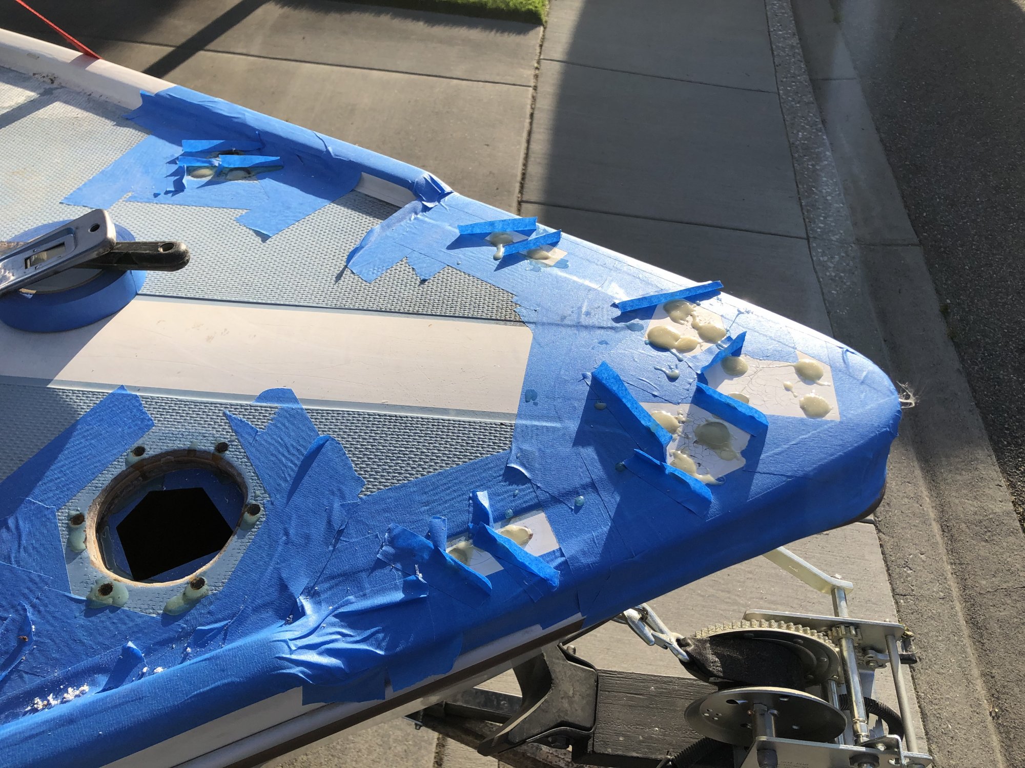

Sorry to hear that. My 1981 didn't have backing plates either. Now she has big chunks of G10 on all cleats (and an even bigger chunk in the bow). Hope you can remedy yours with less effort than my bow rebuild. If it's helpful, Jamestown sells a 6-pack of 12x12 1/4" G10 sheets for a reasonable price. 6 lasted me quite a few years, and I just bought my second pack.

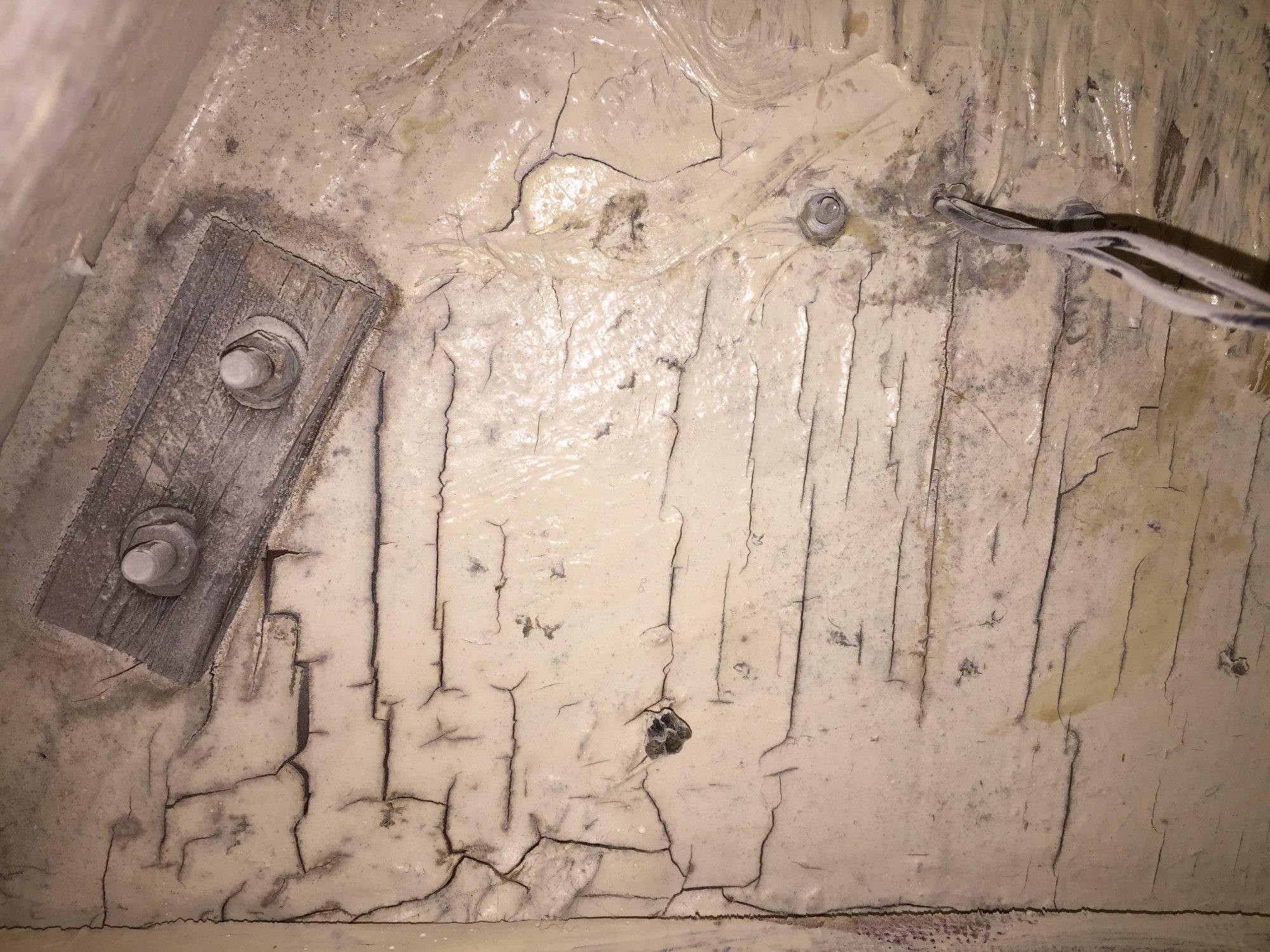

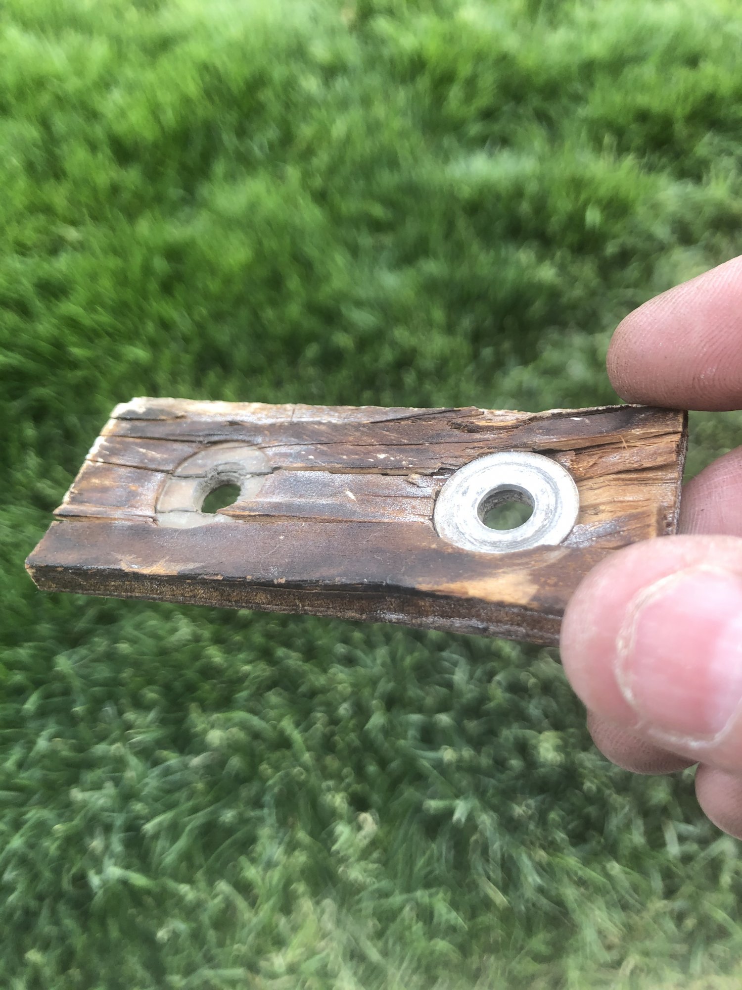

common -- although they may have considered this appropriate at the time (weak sauce)

And yet another thing to look at and possibly update. One of these days boat has to start going back together.

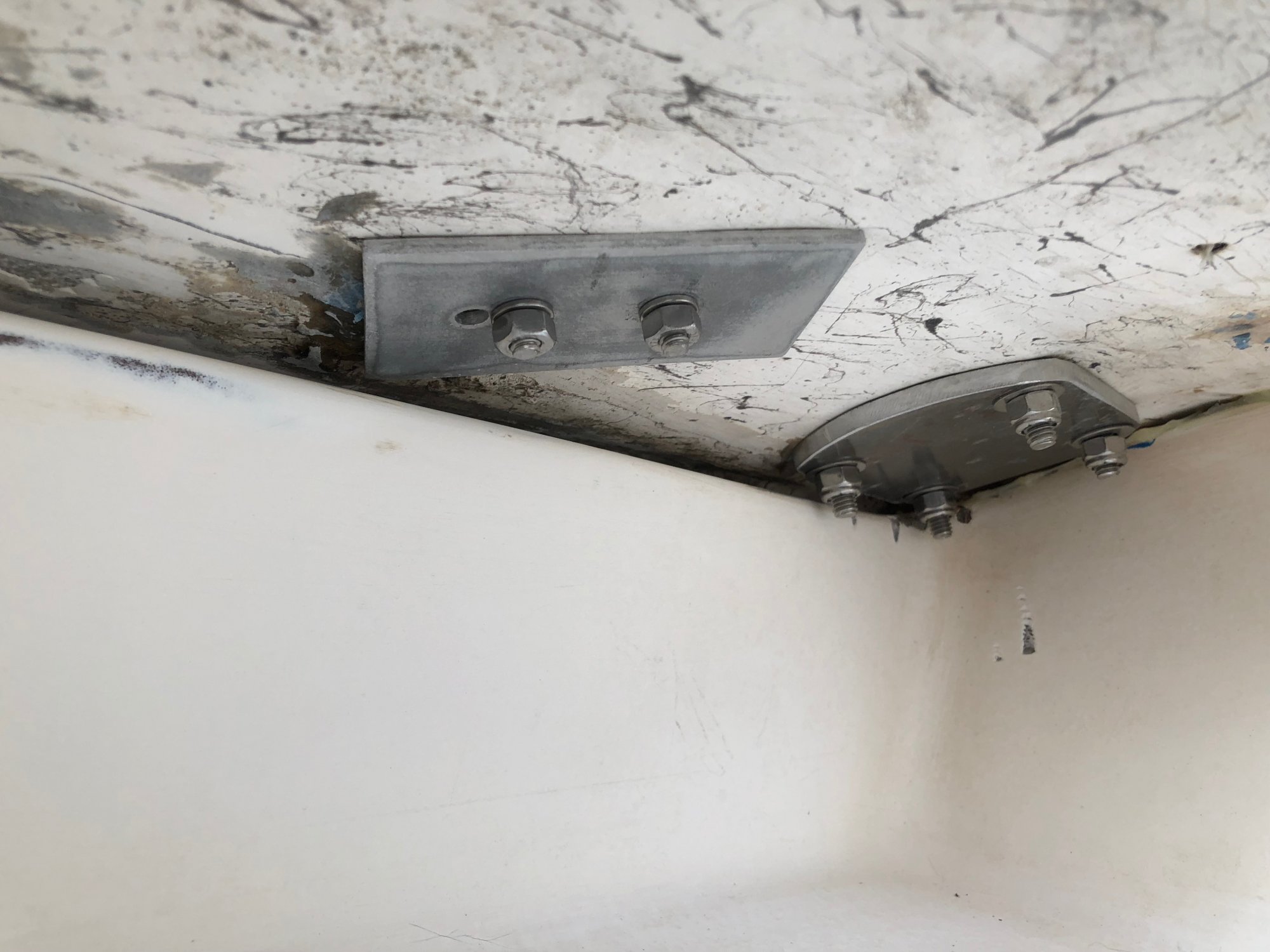

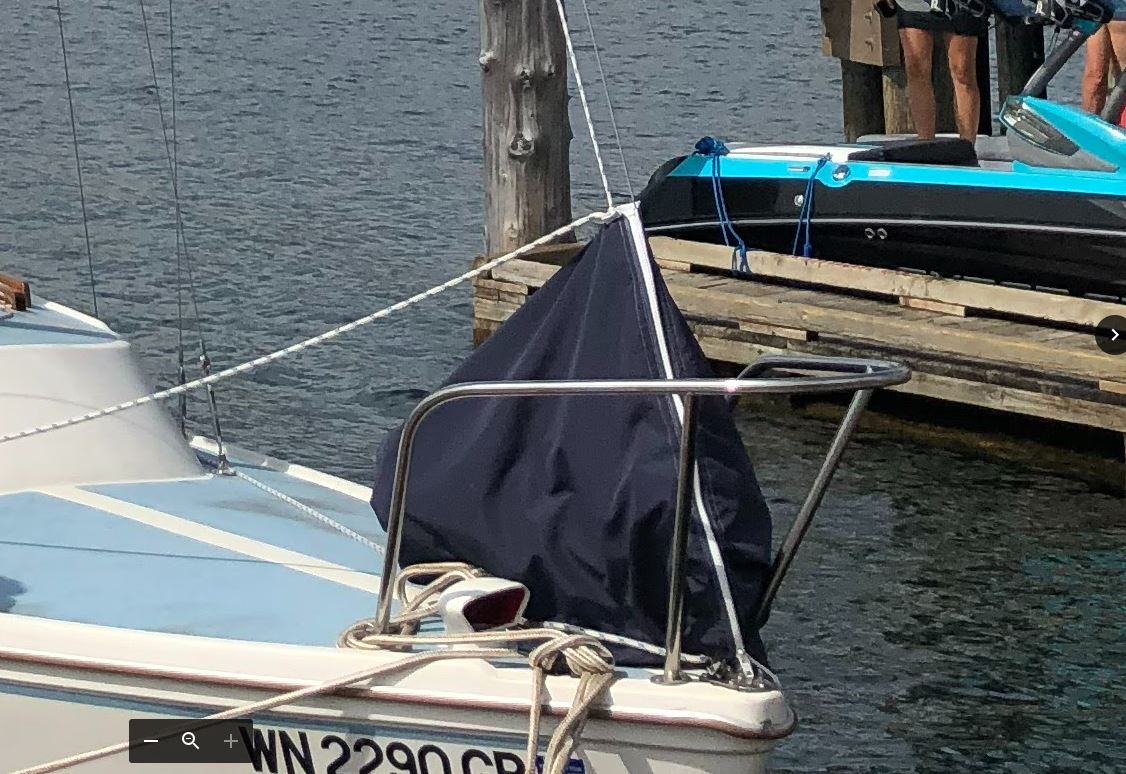

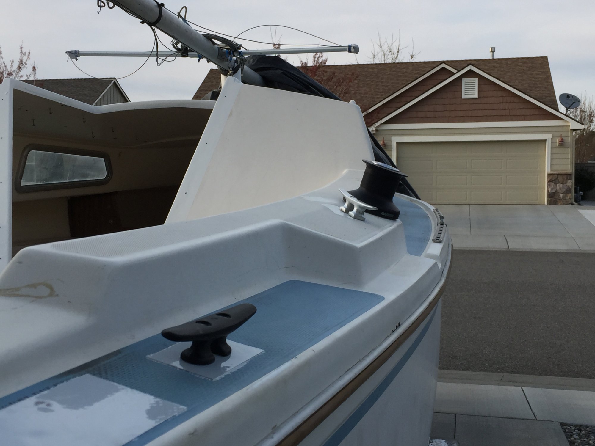

Similar construct without nearly as much pain to add backing aft-- I replaced the primaries with Harken and gave them a plate while I was there. All my stock mounting points now beefed up-- and I replaced stock Nylon (or whatever material) horn cleats with Schaeffer aluminum all around. Not sure I'm a fan of the obstruction a horn cleat would add to the bow center-- not much space up there as it is and would at least for me get in the way of my jib bag and my Jib hoist and douse routine. And quite honestly working in the hole is working in the hole-- not sure that saves you any real grief vs. re-backing the existing.
File_008 (1).jpeg File_006 (1).jpeg IMG_0299.JPG IMG_0296.JPG Capture.JPG IMG_2388.jpg
