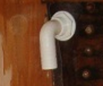

Without seeing exactly what it looks like, I can't tell you what to use to scrape it out. But since it seems this is likely to become a recurring problem if the thru-hull isn't designed to let you backflush it regularly to prevent it from becoming blocked, I CAN tell you how I'd solve the problem: replace the thru-hull with one that you can stick a hose nozzle up against and flush out. (see the photo)

I upped the size of my vent to 1.25" and used the fitting in Peggy's post. It's easy to stick a hose into the thru-hull or just shoot a stream of water from the dock.

If its shaped anything like this one then a small plumbers snake or el cheapie a piece of #9 wire ie coat hanger bent into an arc and you should be able to snake it clear :) from inside ie hose barb or outside.
